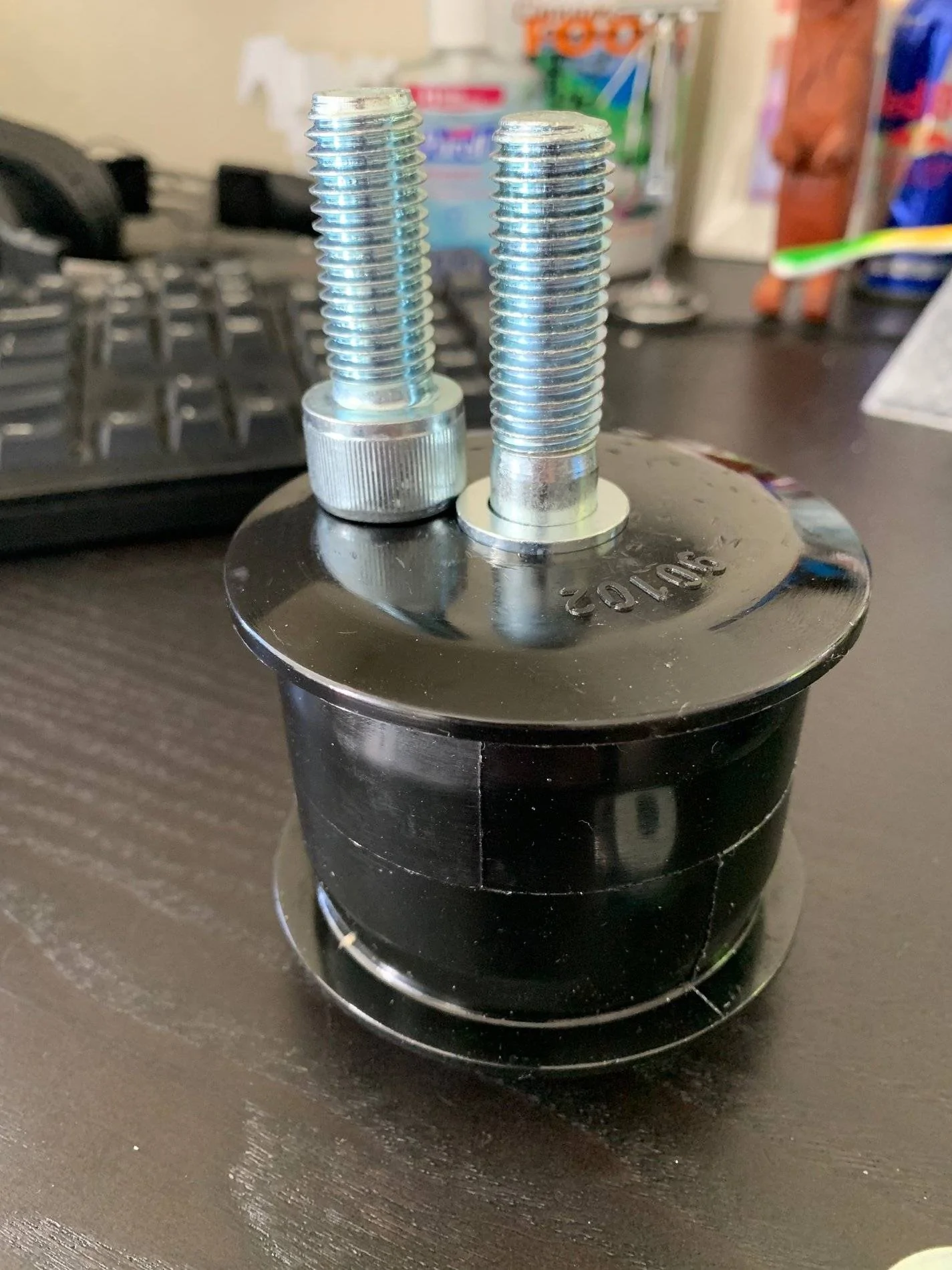

Got the RH017 hardware in today and I am confused as to how this is supposed to work. Step 9 of the instructions for RH017 state to "thread it [the shortest of the three included lengths of bolts, pictured] into the front side of the diff bushing" but I don't see how that is possible with aftermarket bushings like the Whitelines. Thread them into what? The bushings are just two pieces of hard rubber with an unthreaded metal sleeve in the middle.

Well crap. I think the rear bolts are still usable, at least.
Burkey
Feb 9, 2016
87
5,524
3,512
Australia
2016 Mustang GT
I’m trying to recall exactly what I did. All I recall is that I literally replaced the supplied Whiteline bolts for same length etc.
