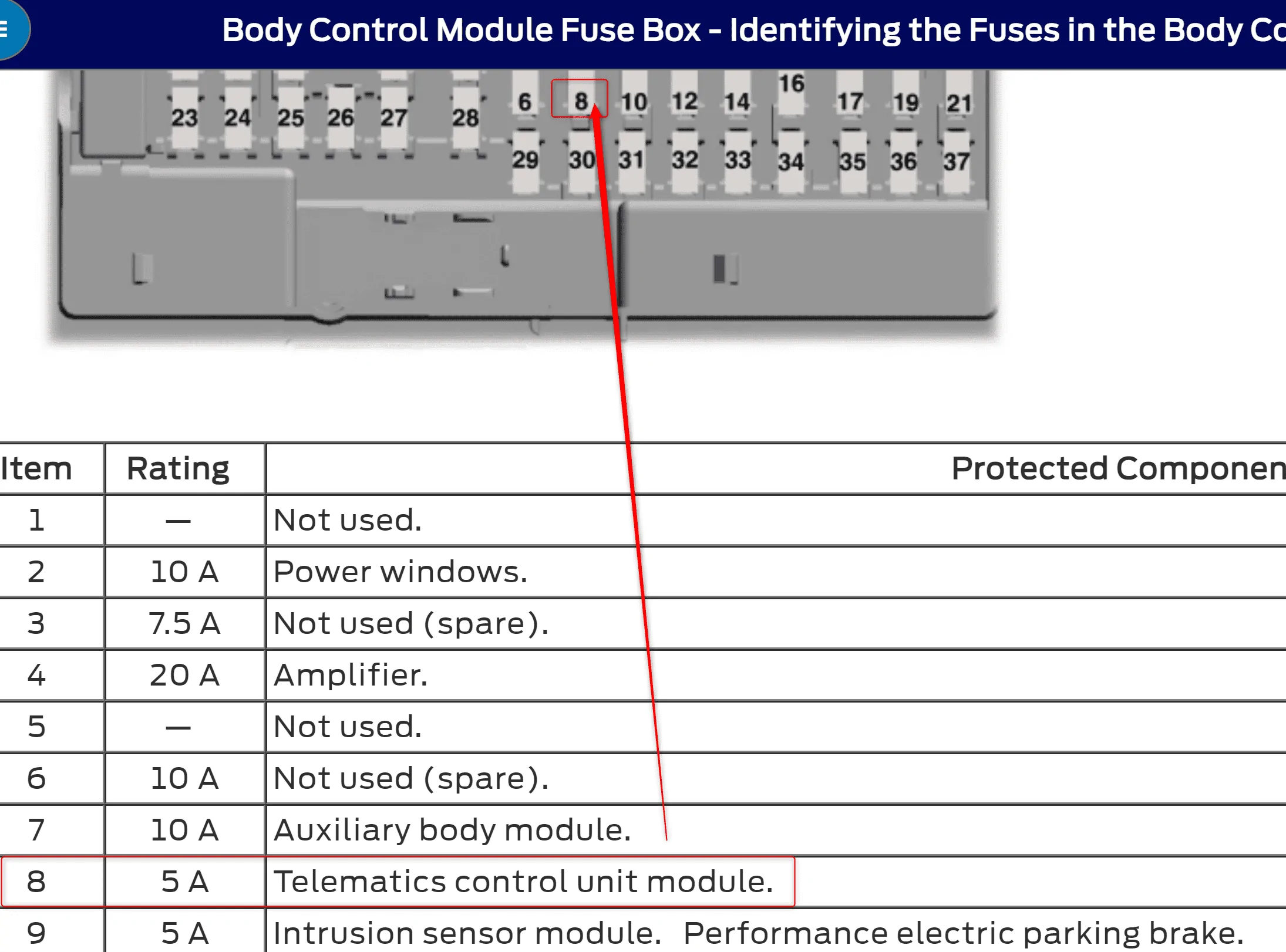

Did any of you took time to go and at least READ the user manual of the new S650?
I did. The TCU fuse is located at bay 8 of the BCM module, where it always was. Just pull it and be happy, or at least, stop complaining here. It's not the right forum (wrong car), it's delusional at best (just because you want to see a machination behind you back doesn't really means the World is plotting against you).
The "fully networked car" is just marketing hype. Go and study, then come back here and speak of things that you actually have a proof on.
Do I like the idea of data sharing? No, and I disabled mine.
But I'm not going around fear mongering others on the future, especially when there is no evidence of a future that dark.
