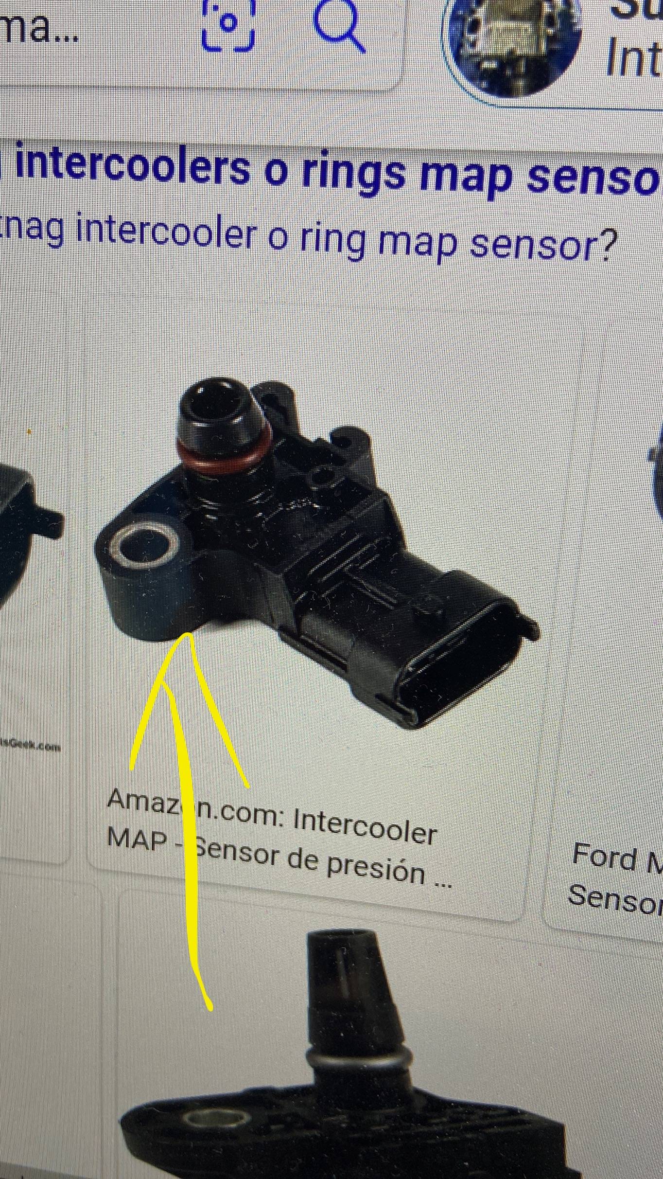

hey Jason, I noticed the cvf street intercooler kit provided a washer for the oem bolt that holds the map sensor to the intercooler, but after swapping the map sensor over the bolt could barely thread in with the provided washer, so I ditched it. Could this be a problem/source of a boost leak?
Just get a screw of the same thread pitch but about 5mm/1/8" longer so you have more thread engagement.

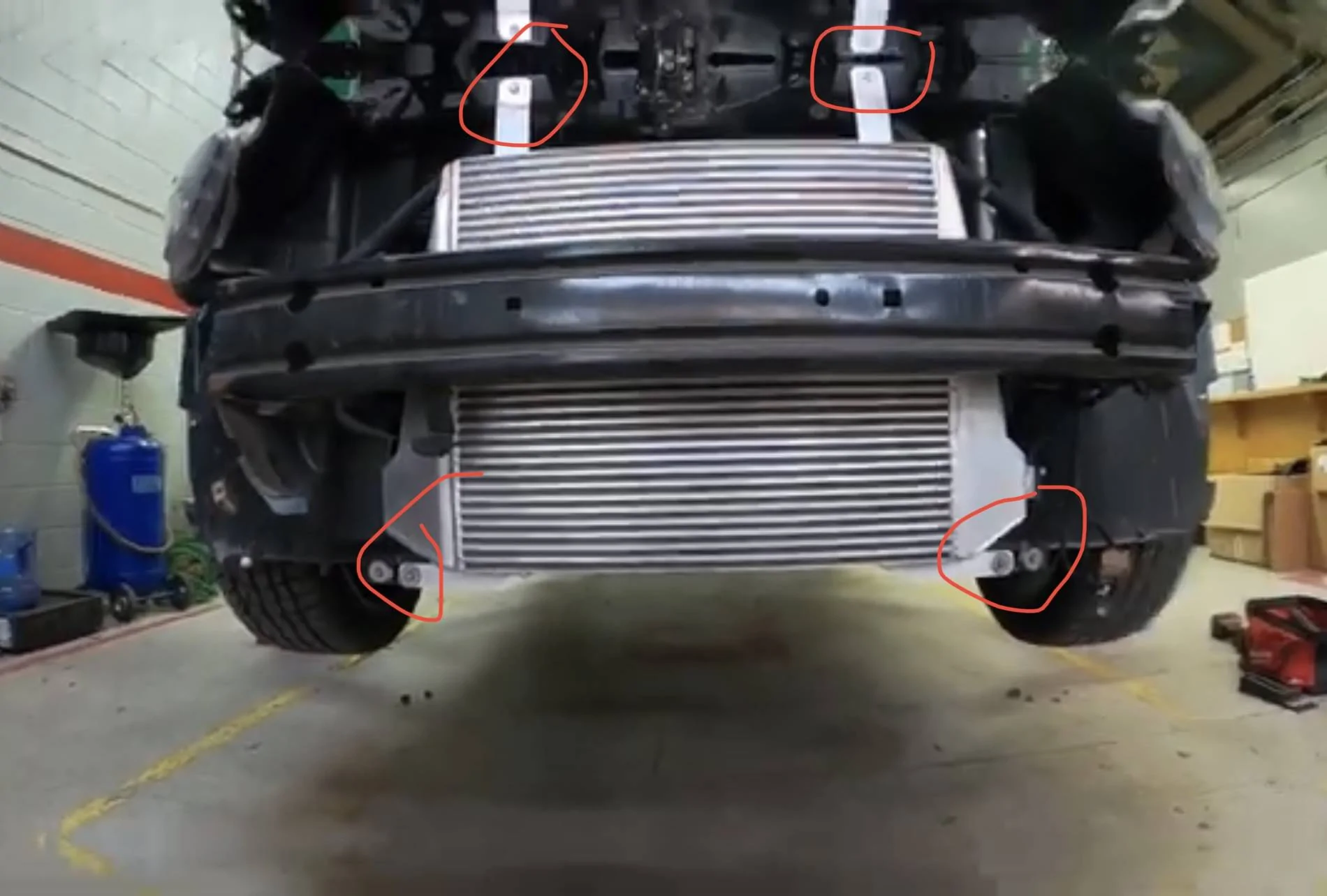

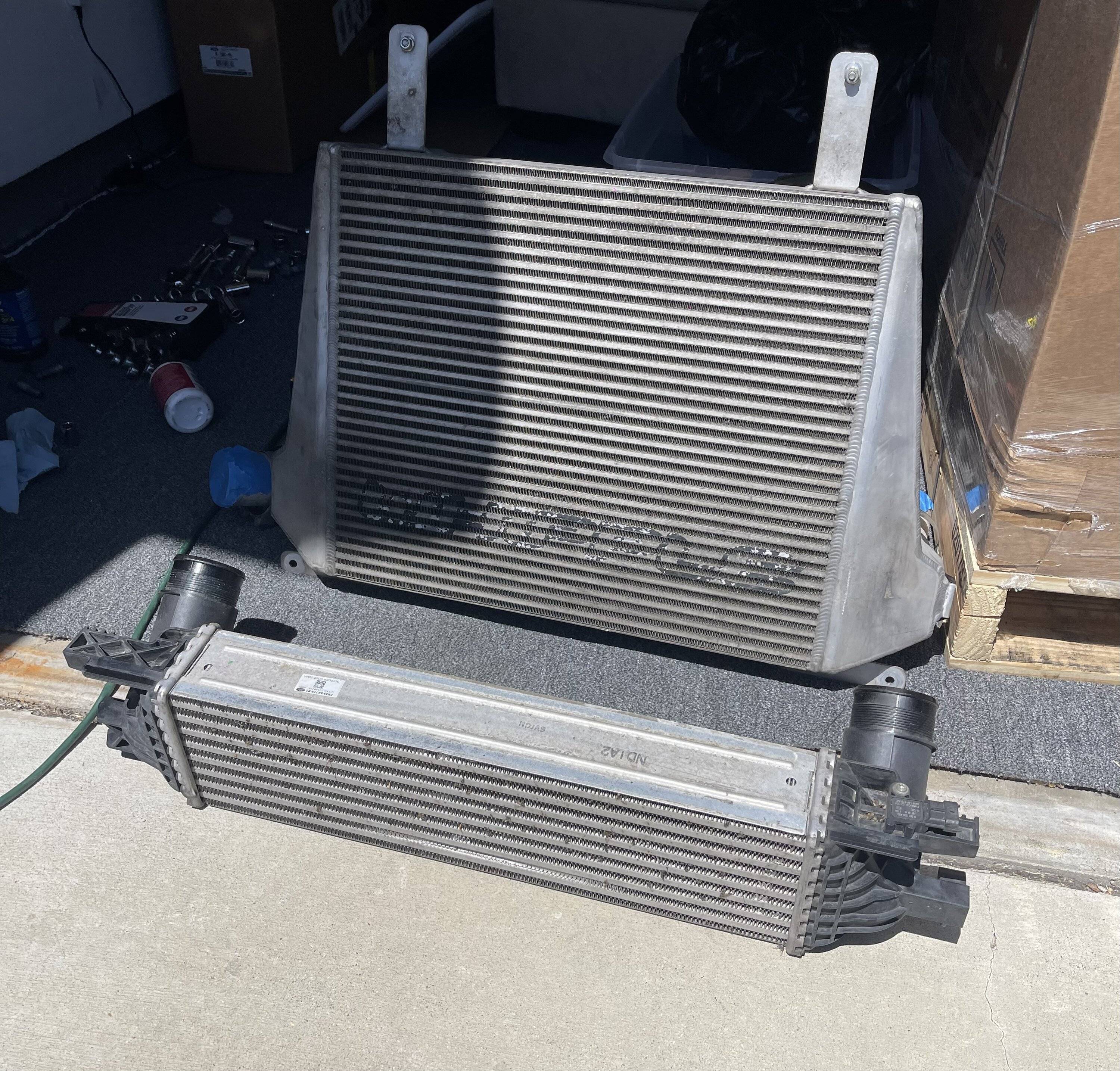

Hey guys, I’m assuming this would be the place to ask rather than a new thread?
I just got a used Whipple Mega Intercooler for $300 and installed it yesterday. First impressions are that it works incredibly well! With the old setup it felt like it had a delay and way less power when accelerating. Now it has less way less turbo lag and I feel it pull way harder on all levels of throttle/RPM.
It’s kinda overkill but at $300 and claimed 100F lowers temps I figured why not.
Next up I’m sticking a Mishimoto or C&F radiator for more cooling, but I ran into these things when I installed.

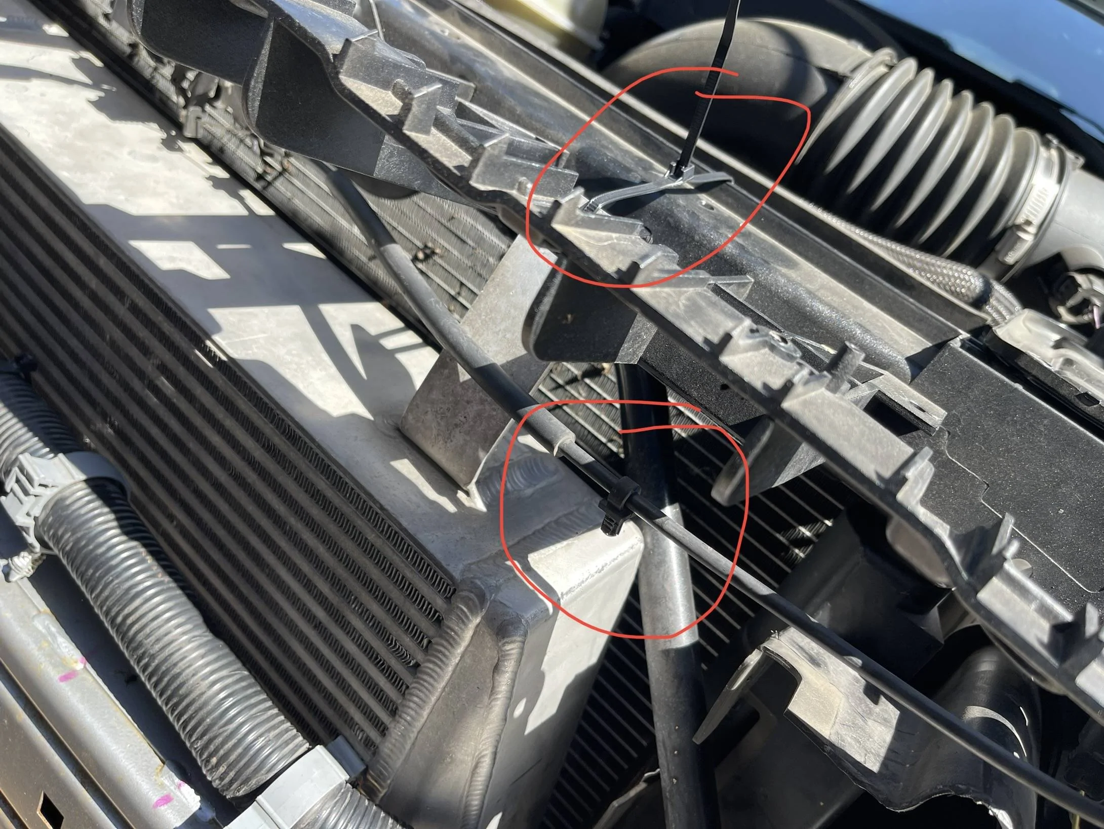

It bolted in the bottom brackets just fine, but there are two bars on each side of the radiator support that are in the way. From looking online it appears people remove those to fully bolt in this Intercooler. Is that something that would be OK to do?
This is a photo I found where it’s supposed to bolt up at all four points.
This is where it’s hitting, can I remove these bars? I zip tied it through the top support because I needed it back on the road but can fix quick. It’s currently bolt in at the bottom.

The factory cooling doesn’t seem very great, it’s an Ecoboost non performance pack. I’ve added the PP extras and several handling mods, but never touched the cooling system. I drive for work and will be sitting in traffic for hours sometimes, have 115F weather here in the summers and it’s starting to heat up and I’d rather have a great cooling system and total peace of mind. I’ve noticed a major improvement with the Intercooler and I’m hearing good results on upgrading the radiator (even without a tune) and I’ve gotten high temps at times in the summers.
Just picked up the Mishimoto radiator today for $230 new, so I didn’t pay MSRP making it that much more appealing to upgrade.
Only thing is if anyone knows about being able to remove those black support parts the Intercooler is hitting, I’m assuming it’s fine to remove those and several stock photos have them removed. Any input on this? I currently just have the Intercooler tilted forward out of the way, but wouldn’t mind having it bolted in.
Photos are in the last post.
