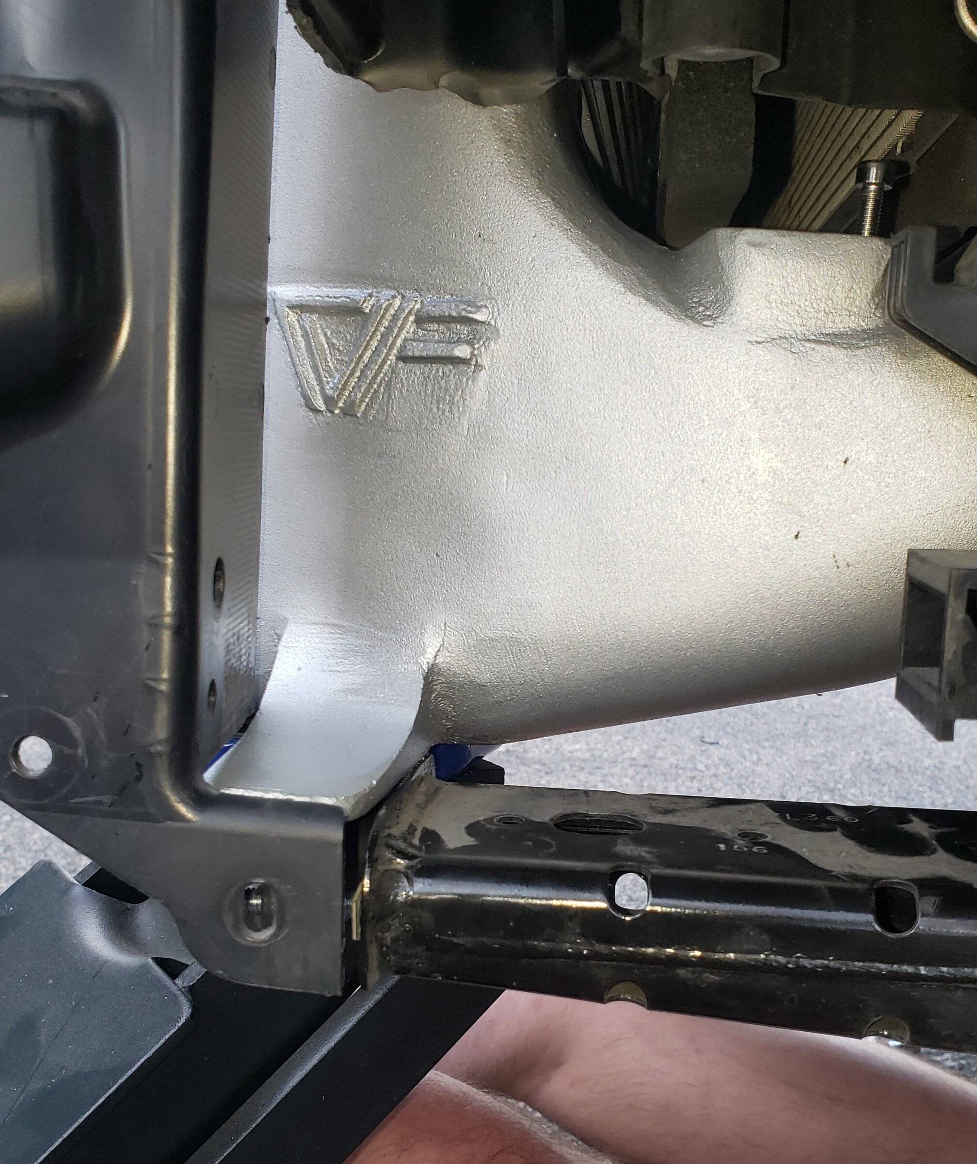

just swapped from the street to the race, was about a 6 hour job, mainly due to fitment/modifications that needed to be done to some plastic trim pieces. the vertical fitment seemed to be very tight once the upper supports were in. without buying new charge pipes will the silicone elbows slide further onto the inlet/outlet? i see the 2 piece kit on the website but i am not sure why there are two? the hot side (picture 2) definitely seems like there is less holding it on than the cold side.

They need to go all the way on the new intercooler! I tried to reuse the OEM connectors and clamps and they blew off.
Then I purchased the correct aftermarket connectors and aftermarket clamps, and haven't had any issues.
And recently, I purchased and installed the aftermarket charge pipes (which is probably, what I should have done in the begining).

Definitely should be fully seated on IC tubes and also second Coyote's suggestion of installing quality charge pipes, clamps and hoses as well.
The couplers you're seeing on our web site are for the charge pipe kits we offer as the inlet/outlet on the Race IC is .25" larger for performance-related reasons. The Charge Pipe Kit comes with smaller silicone couplers for OEM fitment, so we offer the larger ones for Race IC fitment (seamless installation).
The OEM pipes will fit, but lube those suckers up to get them on if you need it. They don't need to be 100% on (they shouldn't pop off but do get them on as far down as you can) but make sure the clamps are tight and you should be good to go.
Installation with the Charge Pipe Kit is MUCH smoother, though.

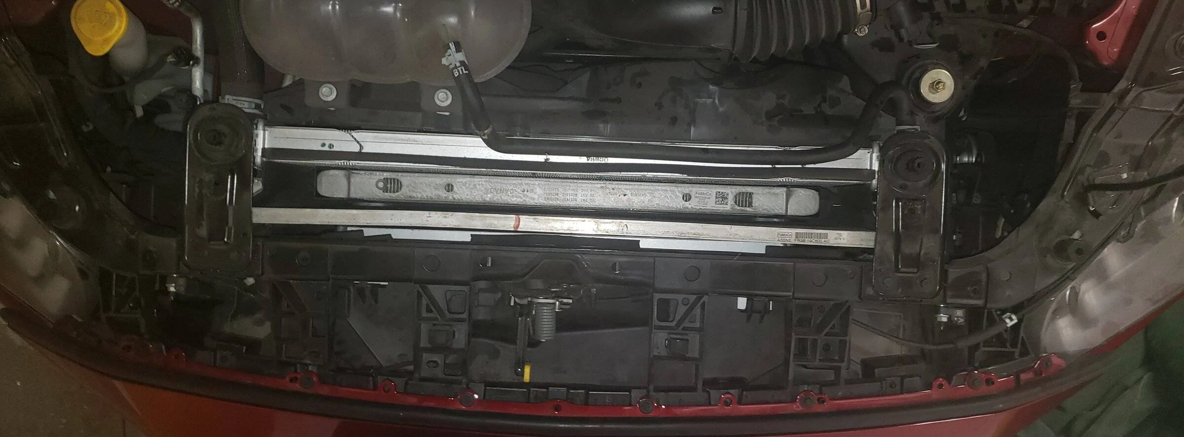

i excluded these from my previous comments because i thought i had pictures from the install date but i didn't so i went back and took some more. the left side slid up to the lower mounting points pretty easy, but i had to use a jack on the right side, while using quite a bit of force to the point where the plastic bit under the latch started groaning, just to get it over the lip on the mounting boss. as seen in the first picture it doesn't quite mount square with it being close to the heat exchanger behind it on the drivers side. i would estimate it is about 5mm gap on pass side and half that on the drivers, to the point where i was concerned about it hitting so i jammed a piece of the soft rubber i cut out from around the latch area .
anyone know what OD size the OEM hotside to IC is? And also the inlet side of the race IC? i am going to investigate a custom solution with these HPS 45 degree elbows as they have a 5" leg from the tangent point of the bend on each side.
https://hpsperformanceproducts.com/pages/silicone-45-degree-elbow
https://hpsperformanceproducts.com/pages/silicone-45-degree-elbow-reducer

OEM is 2.5", Race IC is 2.75"
I tried to get 3" band clamps on the factory hoses but they were a little too tight. So a 3.25" clamp should do the deal.
