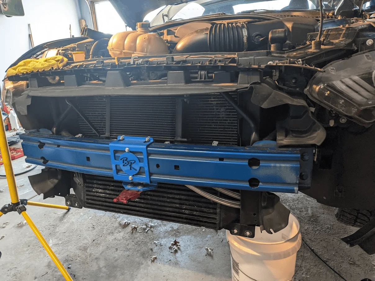

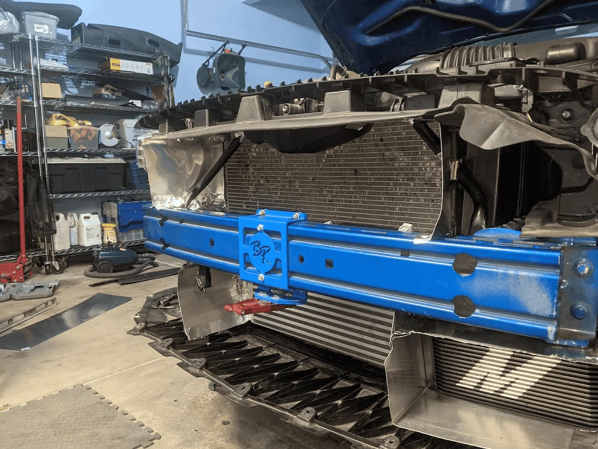

Yep. The Mishi kit for the EB has it mounted in front of the rad.
I moved it down to the lower drivers side, venting into the wheel well.
It's just too small. But, my coolant temps were too high as well, so hopefully the hood vent solves the problem.

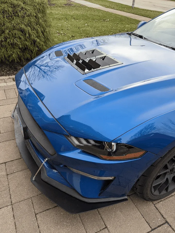

I’m really not a fan of race louvers hood vents, but I might have to go that route as well it sounds like. I’ve tried to research it a bit, but since it’s been mentioned, are there any companies that produce a louver that can be closed to prevent rain entering the engine bay? I live in the PNW, and although I normally do not drive the car in the rain, you never know when you’ll get stuck in a downpour. Happen to me tonight - dry for 6hrs, then an inch of rain dumped unexpectedly.
I’m signed up for another track day next Friday and it’s showing rain.

Most GT500 replica hoods have rain trays, though I don't know how efficient they really are to extract heat. You could technically buy a takeoff hood, install louvers on it and swap just for track events, depending on how often you go to tracks.

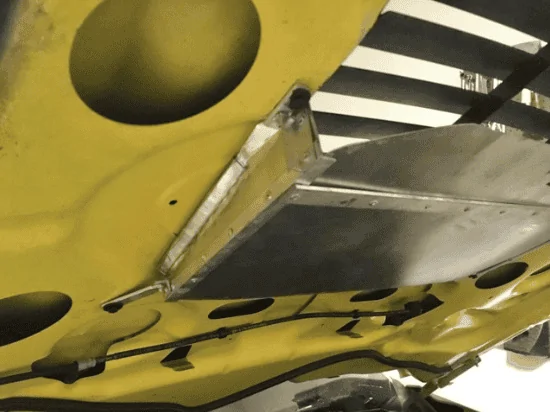

I'm with you. I use this car as my DD in the Chicago area, including winters. I rigged up an aluminum baking dish under the vents, held in place with a couple of wing nuts, with a rubber hose that drains over the the drivers side, away from any belts or electronics. Seems to work well so far. It's hard to see from this pic, but I'll take a pic from the underside when I get home.
