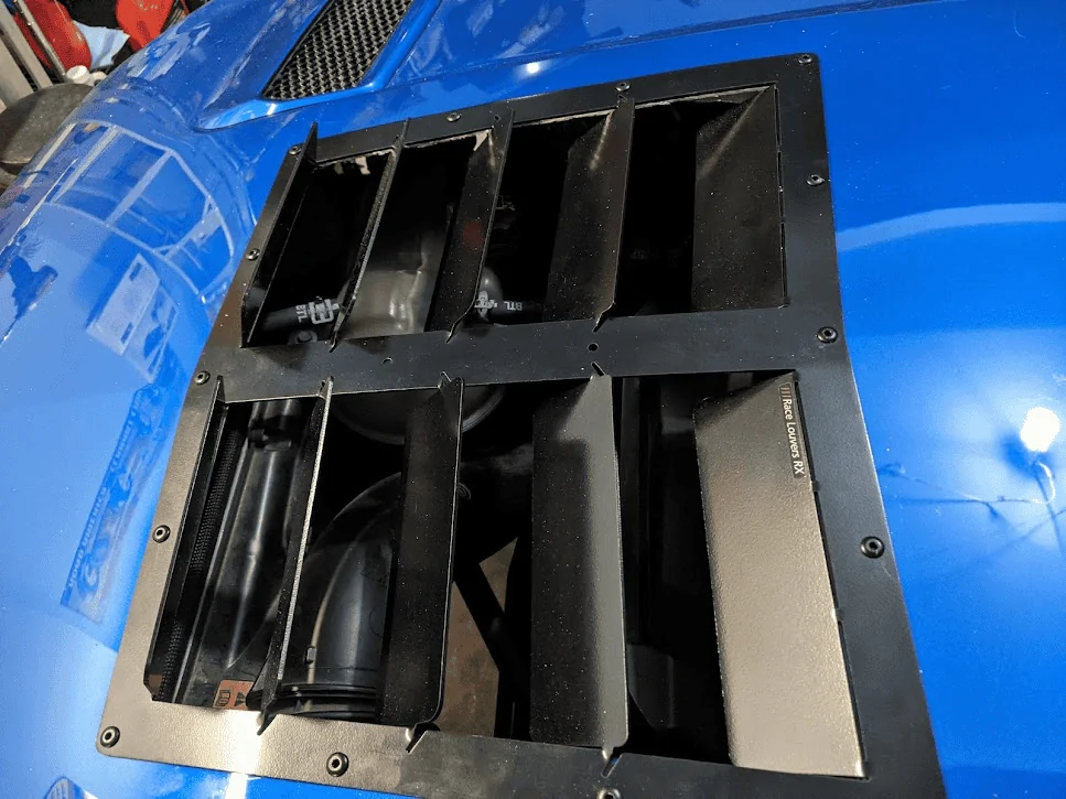

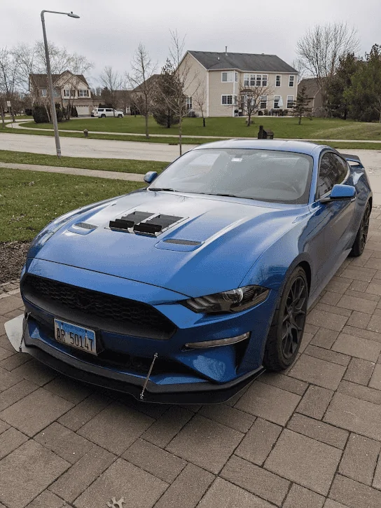

I hope this hood vent will finally solve my coolant/oil temp issues at track days. The larger rad, oil cooler, and ducting wasn't enough, so I'm hoping this does the trick. Road America, 4/29-5/1...fingers crossed!
That's commitment. The way the weather is now it might still be reasonably cool at the end of the month. Are you going to record your sessions? Haven't seen any videos of ecoboosts at RA
Yes, for sure. In 2018, it was snowing on the first day of the event. I use the Track Addict app, and do record video. Unfortunately, since it's the free version, I don't think I can download the video from my phone. I can get lap times in the low 2:40s, but that is shifting at 5K (stock motor). If the vents work, I'm hoping that being able to shift at 6K, or higher, will shave off a few more seconds.

It looks like the louvers all have a different pitch. What is the thought behind that? Create a low-pressure zone with the first louver to suck air out of the from the rear louvers?
Exactly. Race Louvers has some wind tunnel videos showing the heat extraction. They make different versions. The street version has all the louvers flush with the hood.

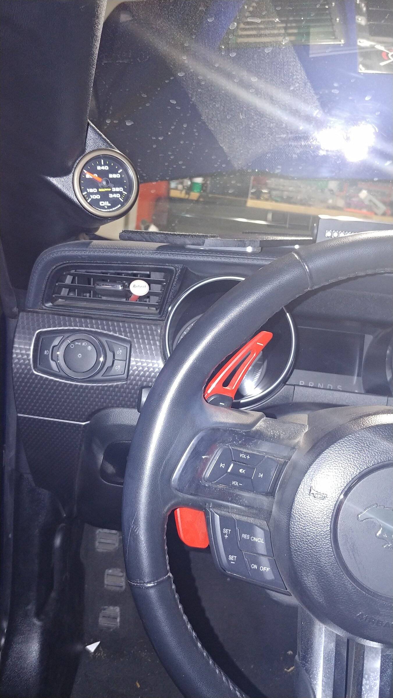

I use a direct measure from sandwich plate. I measure from the engine and back from the cooler( 20f less).
U need to be proactive of tranny especially with warmer weather and u getting faster.

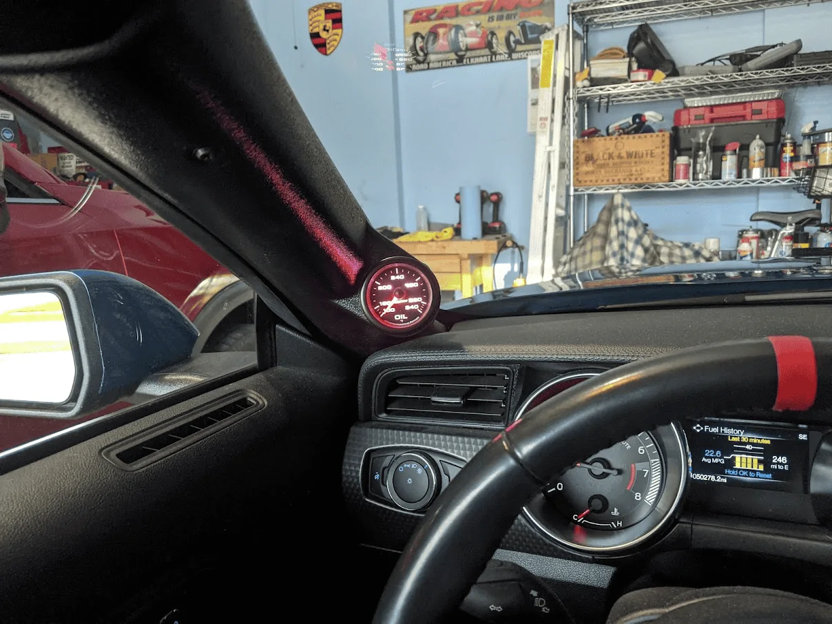

Ditto. I used an A-pillar pod to mount it. Works fine. This gauge confirmed that the little Mishi oil cooler appears to have minimal effect on actual oil temp, at least in an Ecoboost.

I never go in limbmode (so far)
The oem is still green yellow red.
Is normal to be in yellow /red limit. At the track
My gauge is a real number gauge
