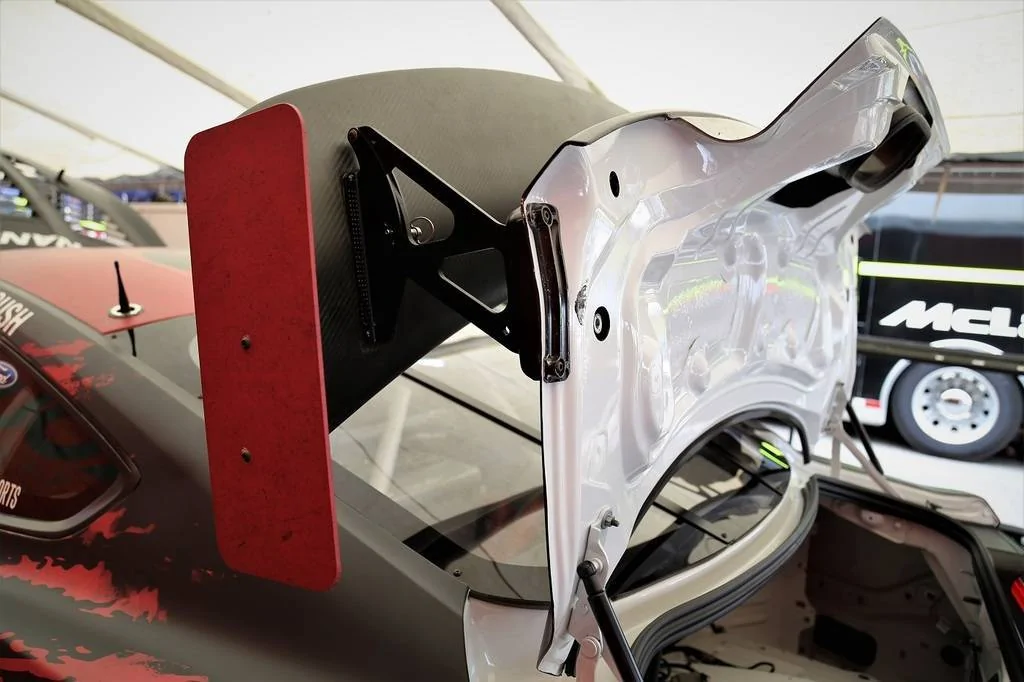

I'm not sure I that I would write off use of a CF decklid for use with a "high" downforce rear wing on the S550. Of critical importance is the mount design and location, and the assumption you aren't trying to use uber light CF decklid that has little to no panel bonded underneath it. The decklid on the GT4 Mustang that Multimatic makes is CF. They designed the mount to be placed in the strongest location.

@Epiphany archetype racing uses the exact same mounts and the wing warped the anderson CF trunk lid. They are working on reinforcements for it.
this is why APR has hose aluminum strengthening spacers between the 2 halves of the trunk shell for the fp350s wing. Even capaldi racing suggests welding support bars across the inside of the factory decklid as it also is too weak
this was confirmed by a very very high up person at ford who has multiple gt350 racecars (on site) i had the pleasure of meeting at the track.
multimatic has to have a different decklid because i can 100%, on my wing at least, high speeds, the anderson CF will be deformed.
