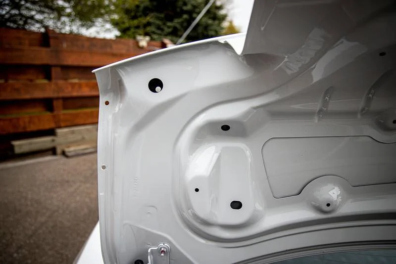

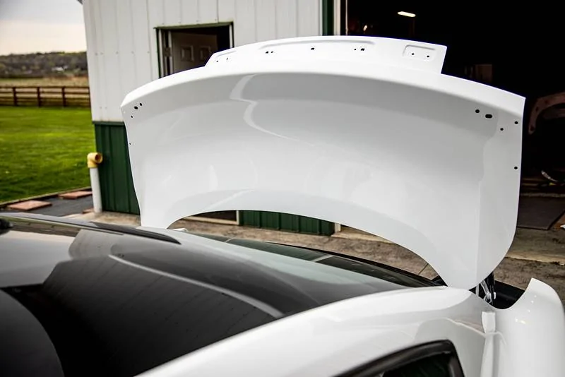

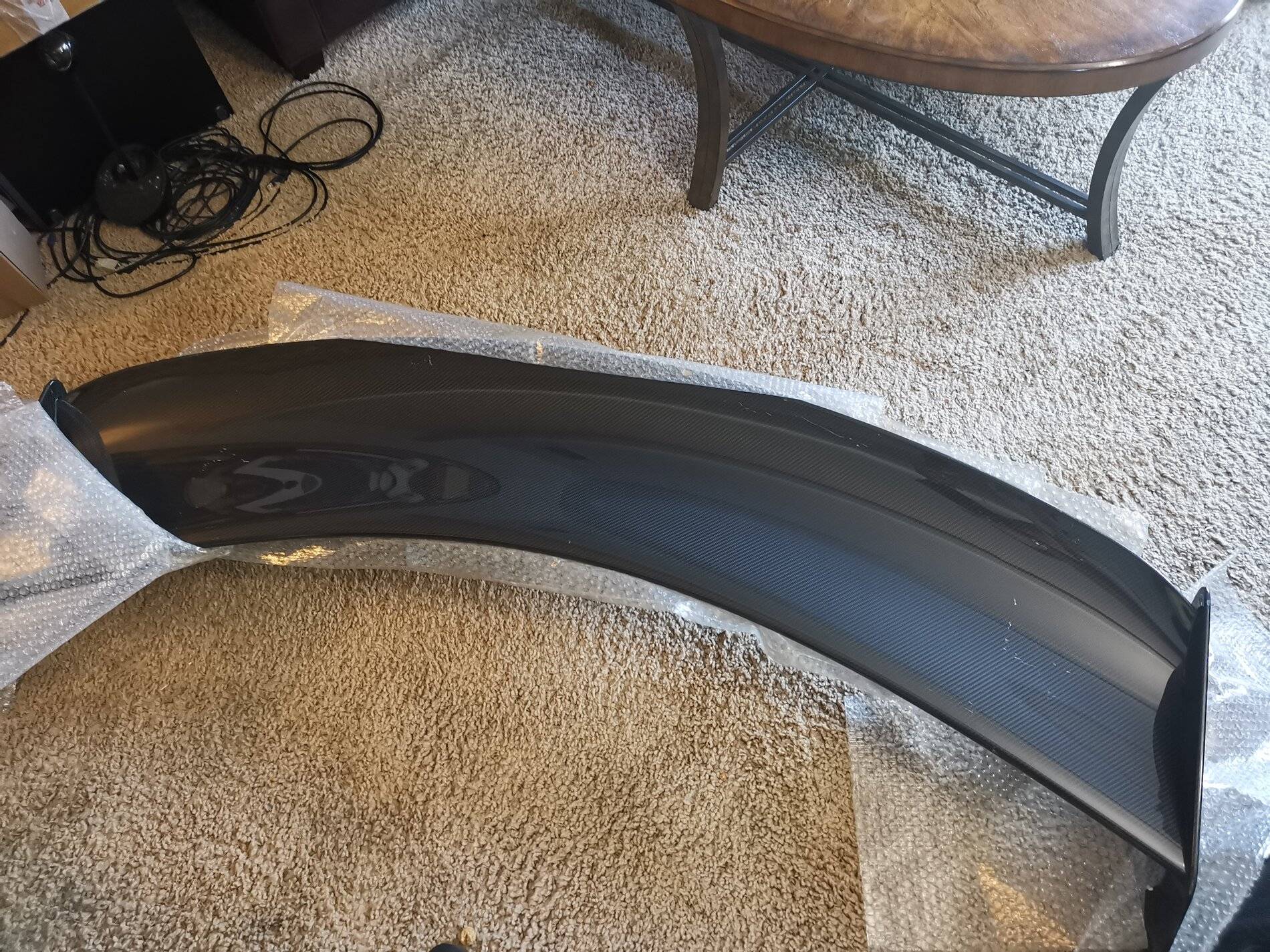

Just quoting your response because you mentioned the deck lid and the base wing.
I am looking to do as min as possible to disrupt the original paint and not have to blend ay paint, having said that, the base wing has 7 holes in the decklid, there is 2 holes that will be re-used with either wing, which is in the corner, to the left is another hole, which if I am correct on either side will be covered by the bracket and won't be seen (Will be adding a gasket around the mounting bracket for water) so I don't see a need to fill the holes on either side. (Already have screenshots of the holes in the decklid for reviewing with my Auto body shop to see the best minimal way to do this).
The one thats going to be the issue is the 3 in the middle that the base mounts to, 1 is a "pilot" hole and the other 2 are mount (screwed) holes, which if I am right would go under the new black stripes, the only one that might stick out is the pilot hole. But trying to cover the 3 middle holes without messing up the paint too much but we will see. Since I caught my white whale last Friday and came in today :)

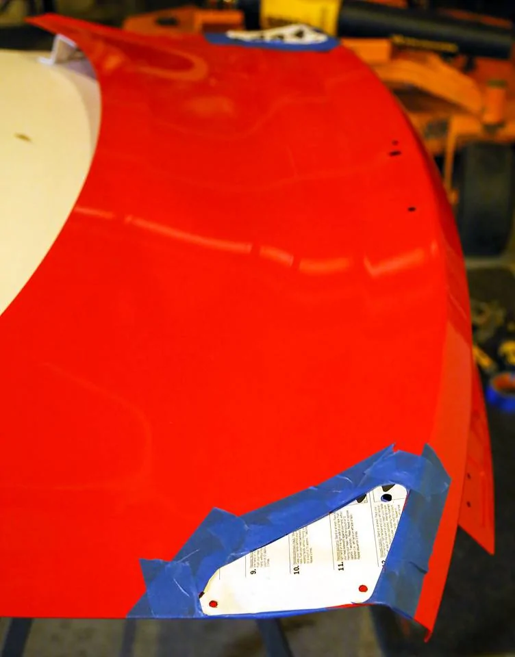

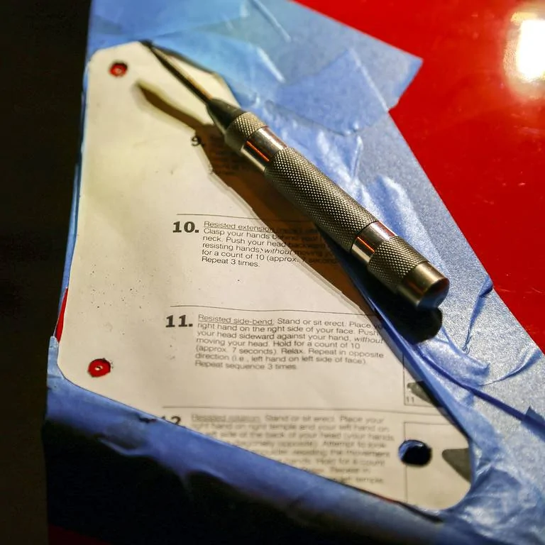

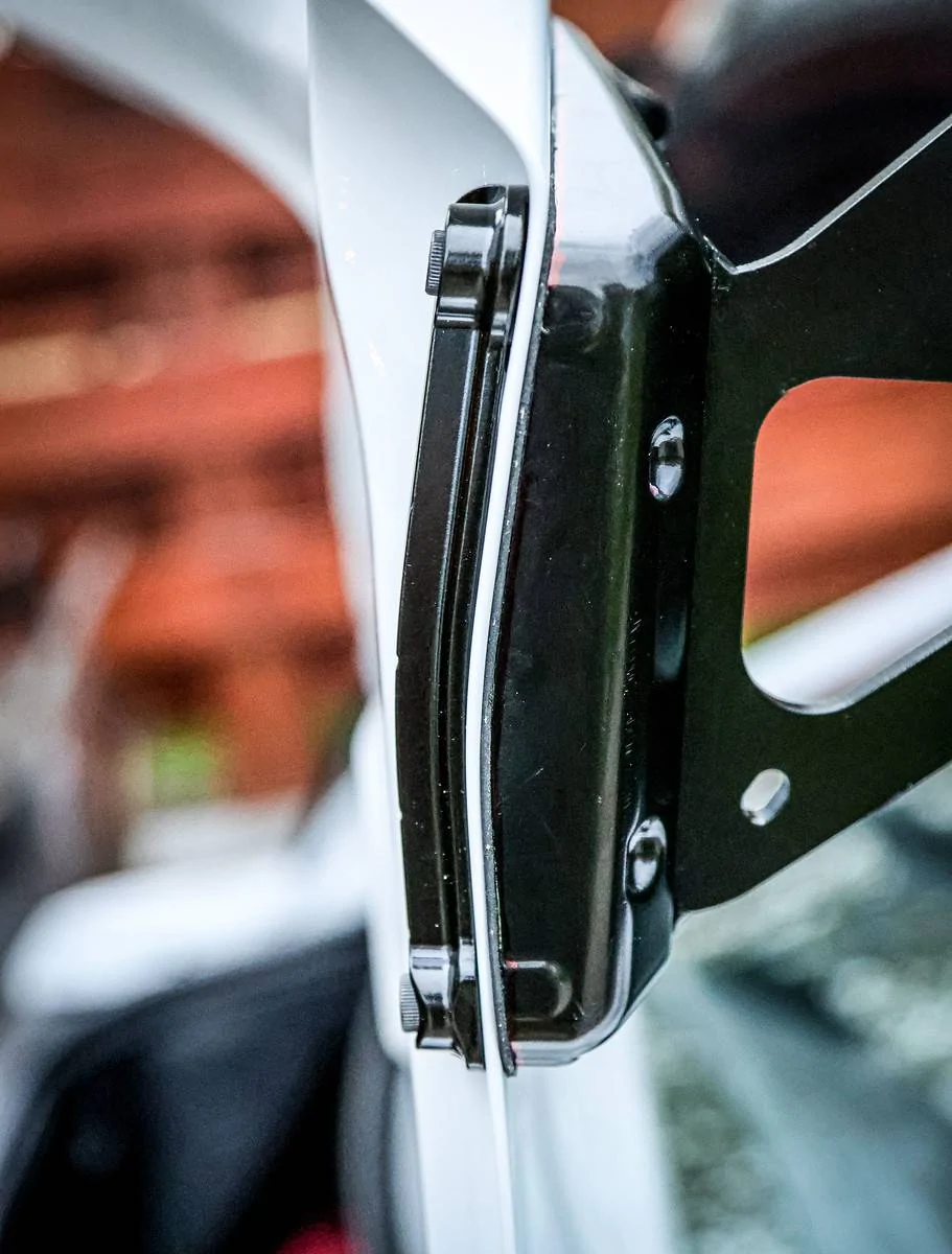

I've done this three times now (spoiler/wing on a decklid that had to be prepped/painted). The key lies in matching the paint. I take my gas cap cover off and bring it to my paint distributor who then matches as best as possible - no blending nearby panels. I favor having the center holes welded up and then the entire decklid painted/cleared. Cost has always been reasonable.
I laid out and drilled an extra decklid I had on hand...

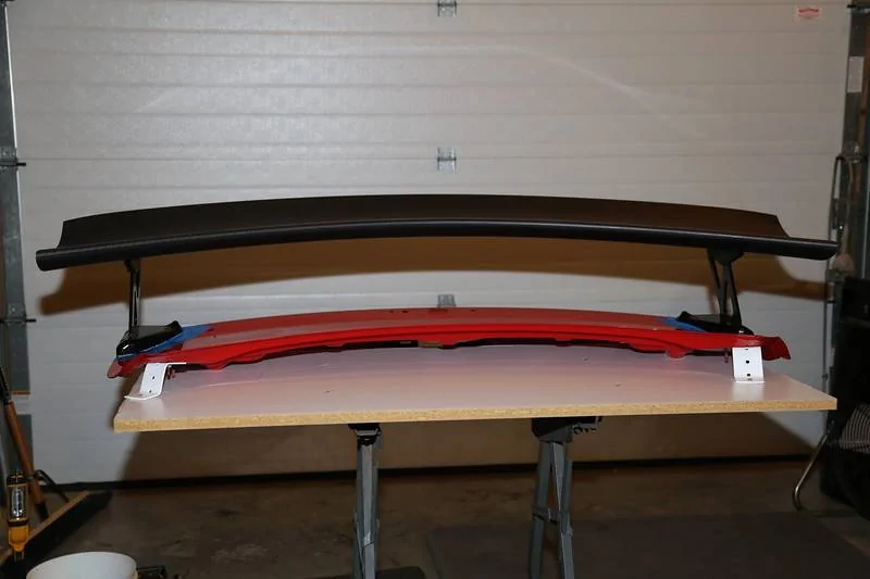

This, my original Base GT500 decklid. Note that it doesn't have the holes for the dogbones...
...and my formerly red decklid all painted up and being mounted in position.
Question, do you have a copy of that template I can use? I downloaded KB's template but the dogbone holes are off a bit after fitting the guide screw.
Epiphany
Oct 11, 2015
78
7,980
13,630
Global
I like to disassemble things.
I too would like it.

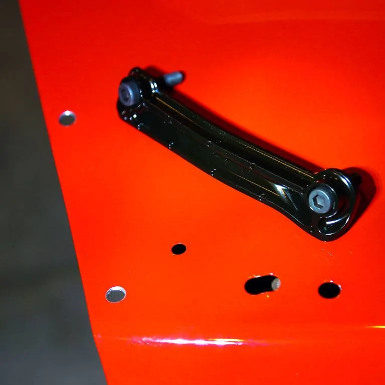

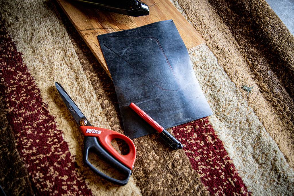

I just grabbed whatever paper I had laying around and took my time making an accurate trace and then cut it out with scissors. I then carefully punched through where the three holes are in the upright base and then trimmed them to be concentric to their respective hole. Pretty easy, just takes a little time. Then I taped the template to the upright base, along with some strips of tape that were upside down. With the uprights installed on the wing, I set the entire assembly atop the decklid and let the contours dictate where it needed to be and carefully measured both sides to make sure they were the same. I then stuck the upside down tape to the decklid and carefully removed the tape that adhered the template to the base - boom, that's where she goes. I also checked the dogbone, placing it where it wanted to be and measured it to see if the holes would line up. They did, perfectly.
The single, non-dogbone template hole on each side will line up with the existing hole so you just have to be sure the dogbone holes are right. Then punch, drill and verify.

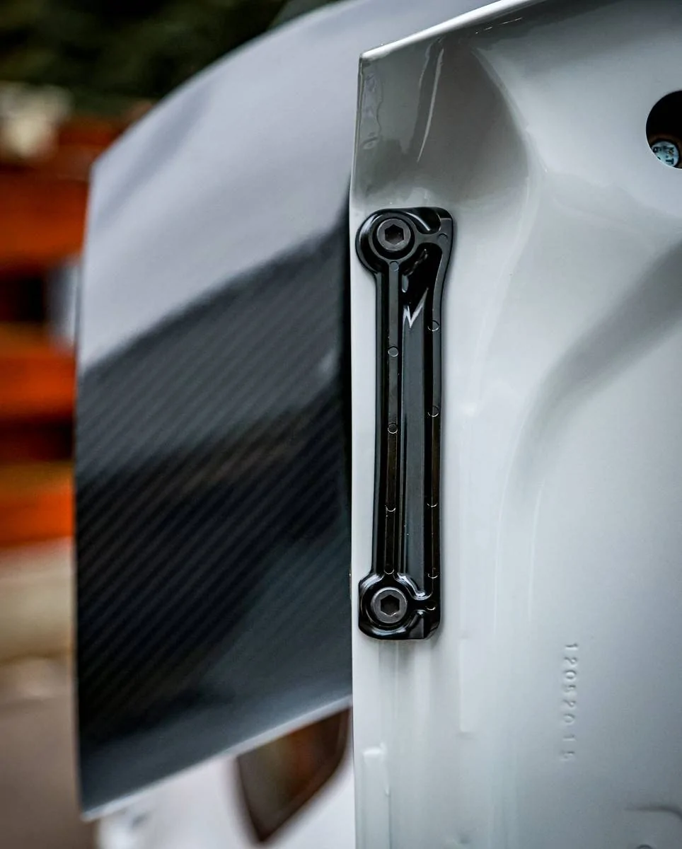

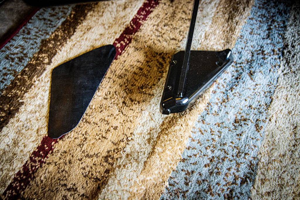

Of note...look carefully at the bolt holes for the dogbones. If you were to measure from the bolt hole center (or the edge of the holes you drilled, doesn't matter) to the edge of the decklid with a square, you'd see that the holes are on a slight skew and not the same distance from the edge of the decklid. Don't worry, this is correct. Both the driver side and the passenger side are like this. They base wants them like that so don't think something is wrong. All the cars I studied closely were like this.

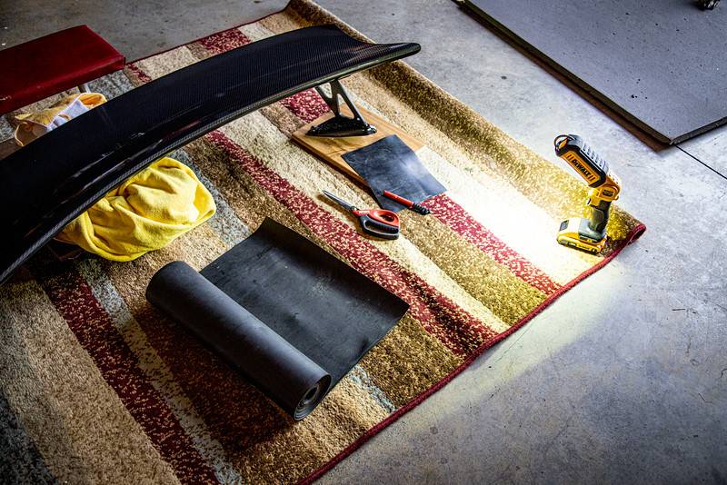

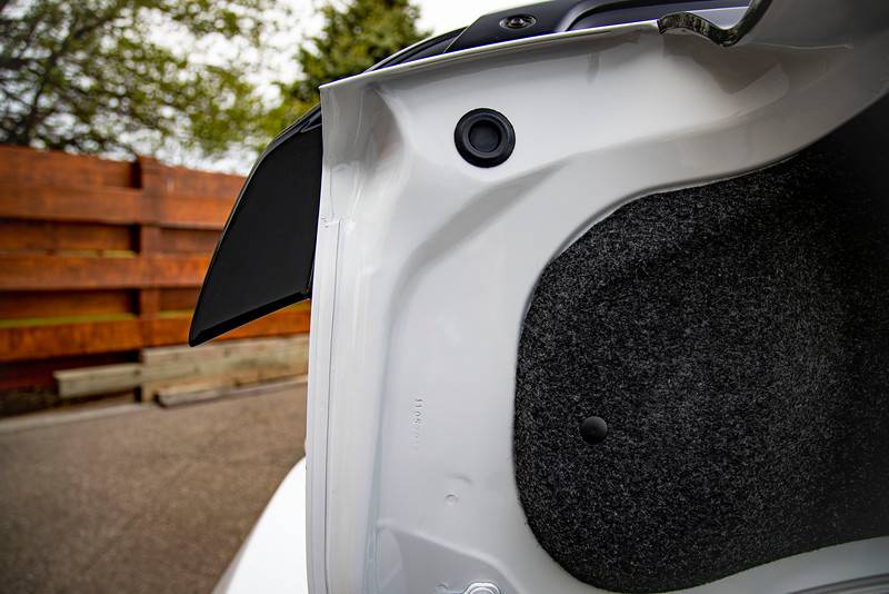

The GT4 upright bases bolt directly to the decklid without any type of gasket. Since I didn't fill any of the existing unused holes that would be hidden under each base, and because I didn't want to crack the freshly painted decklid, I made some base gaskets from some reinforced sheet rubber I have. Again, a simple trace , cut and punch for the holes. I used two way adhesive on the rubber to base interface and put nothing on the side that would touch the decklid.
Again, note how with everything installed, the dogbone wants to fit the contours of the underside of the decklid such that it is slightly askew (hence why they nip the bottom of the bone near the edge).
Everything in place and bolted up, you can see how both the dogbone and the upright base fit the decklid contour perfectly. Not sure if any aftermarket wing bases will match up this well.
