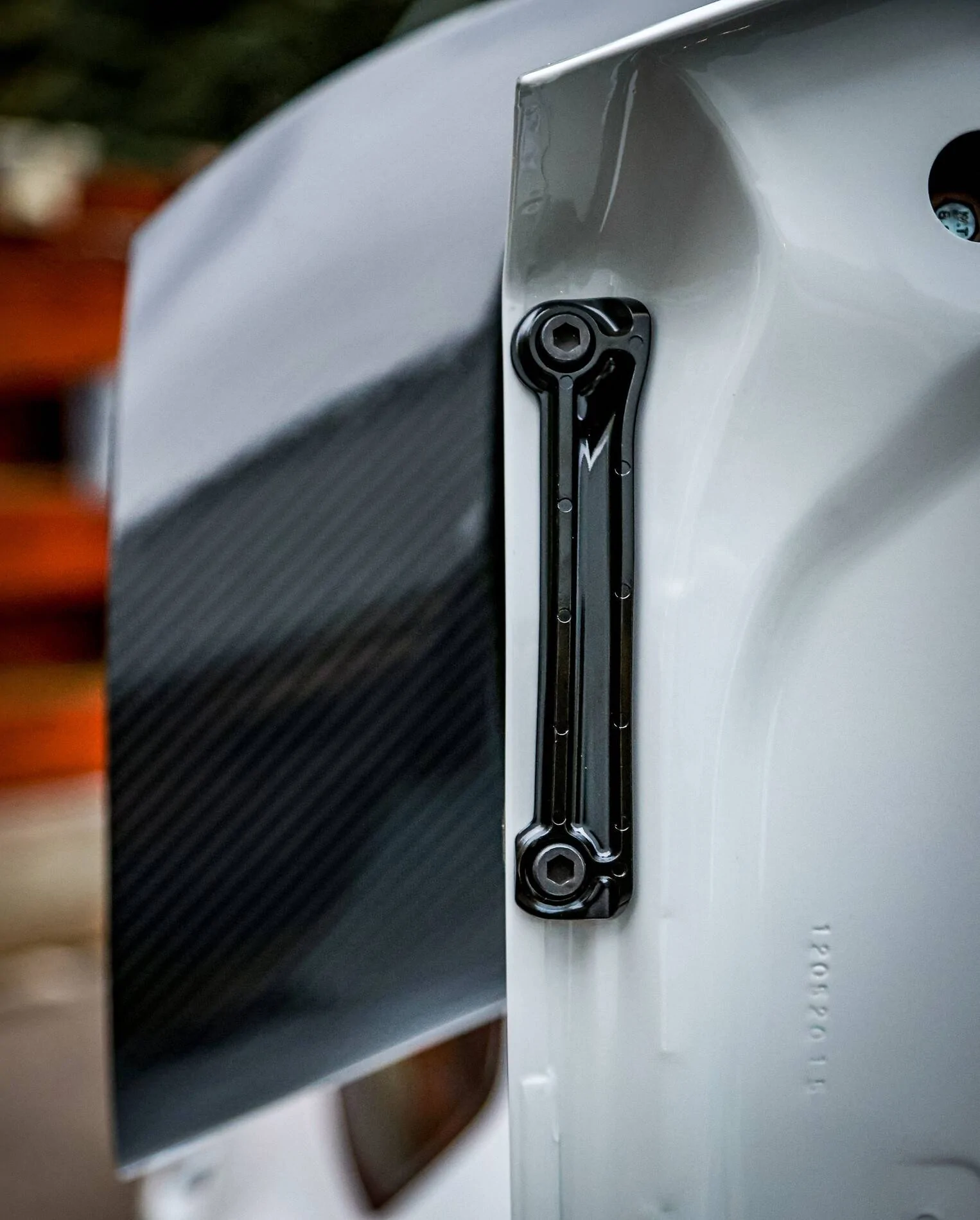

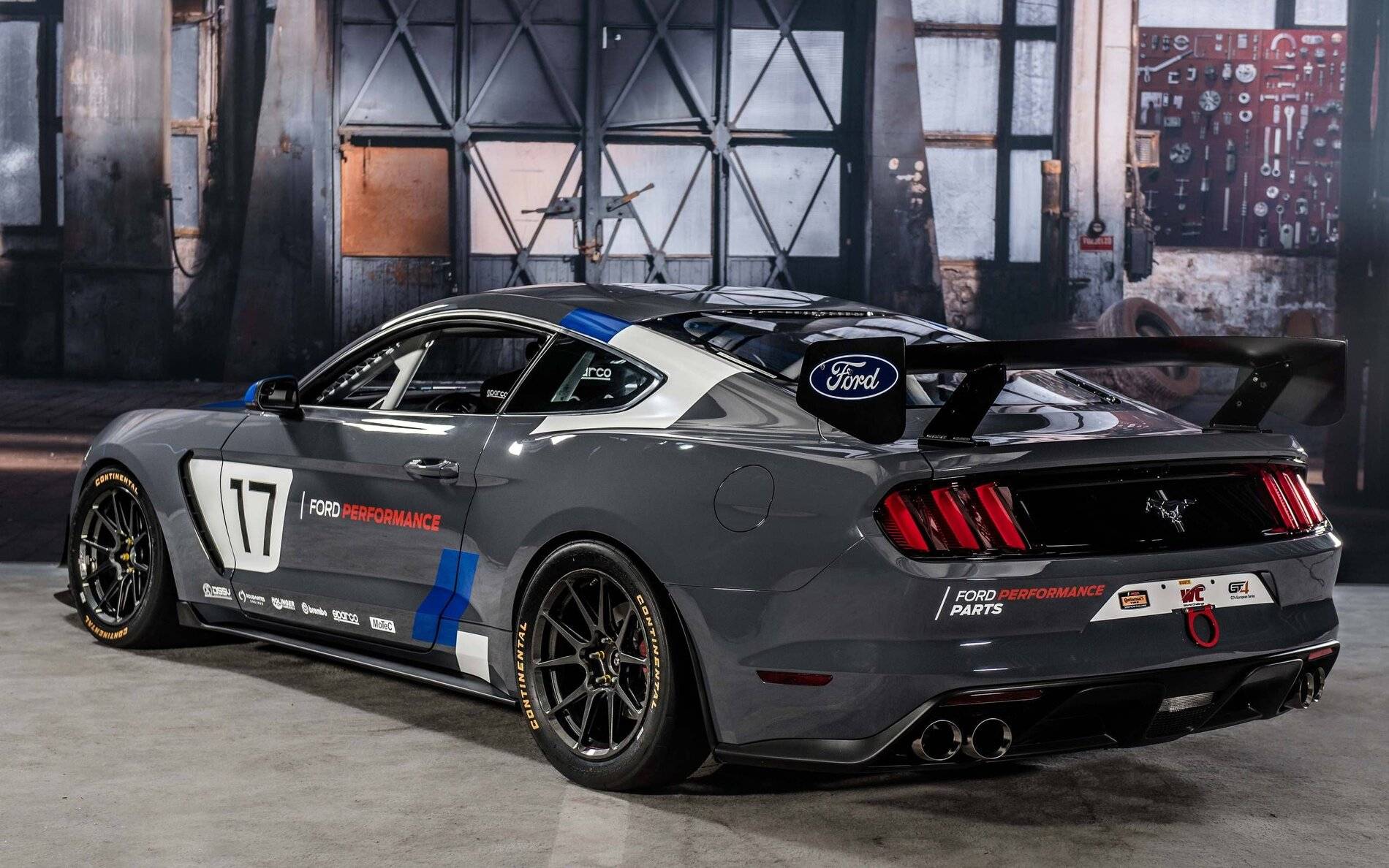

The GT4 decklid and wing...the airfoil was pretty much figured out while FR and Multimatic tested some different upright combinations. Note how far inboard the early mounts were where they sat on the decklid face.

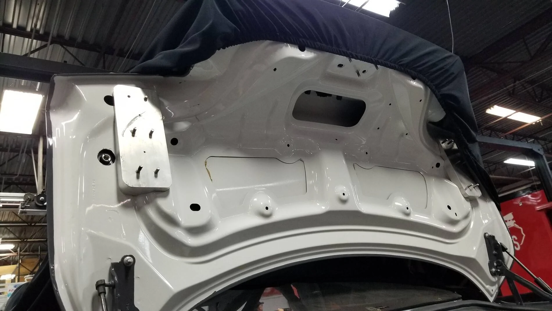

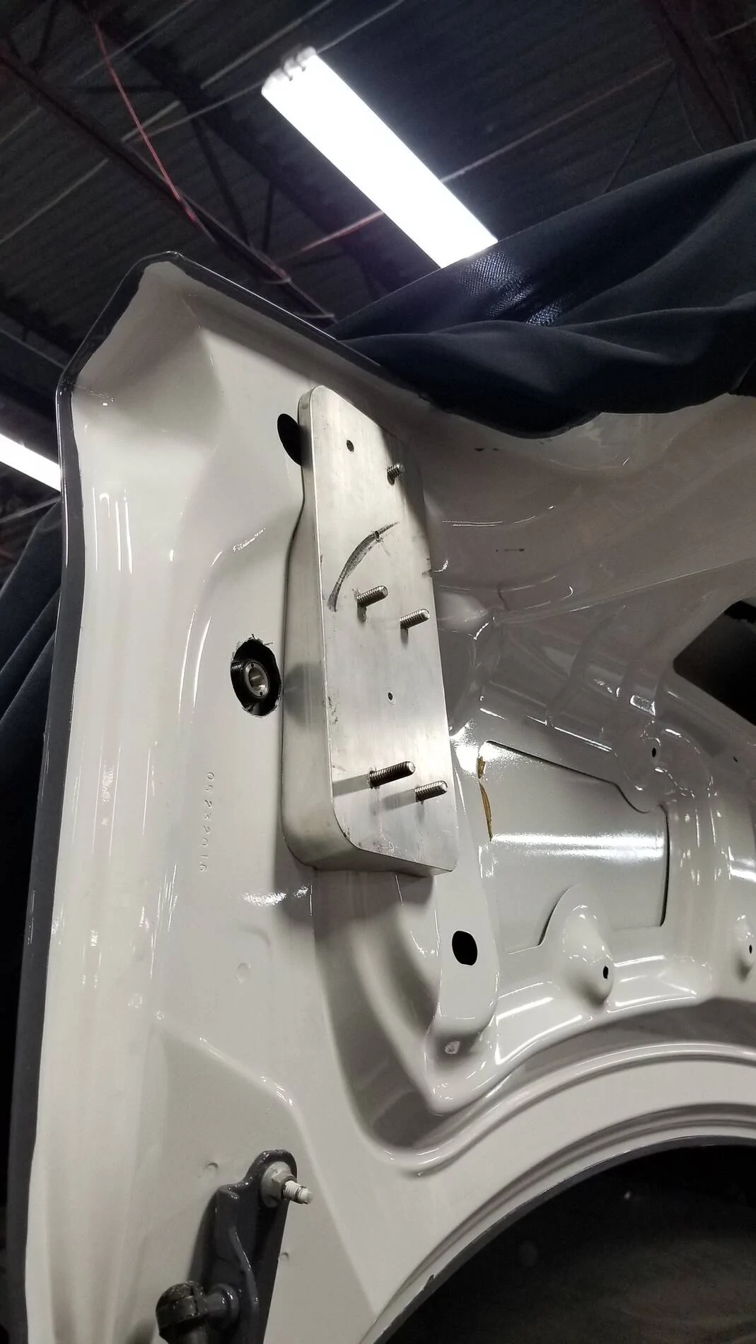

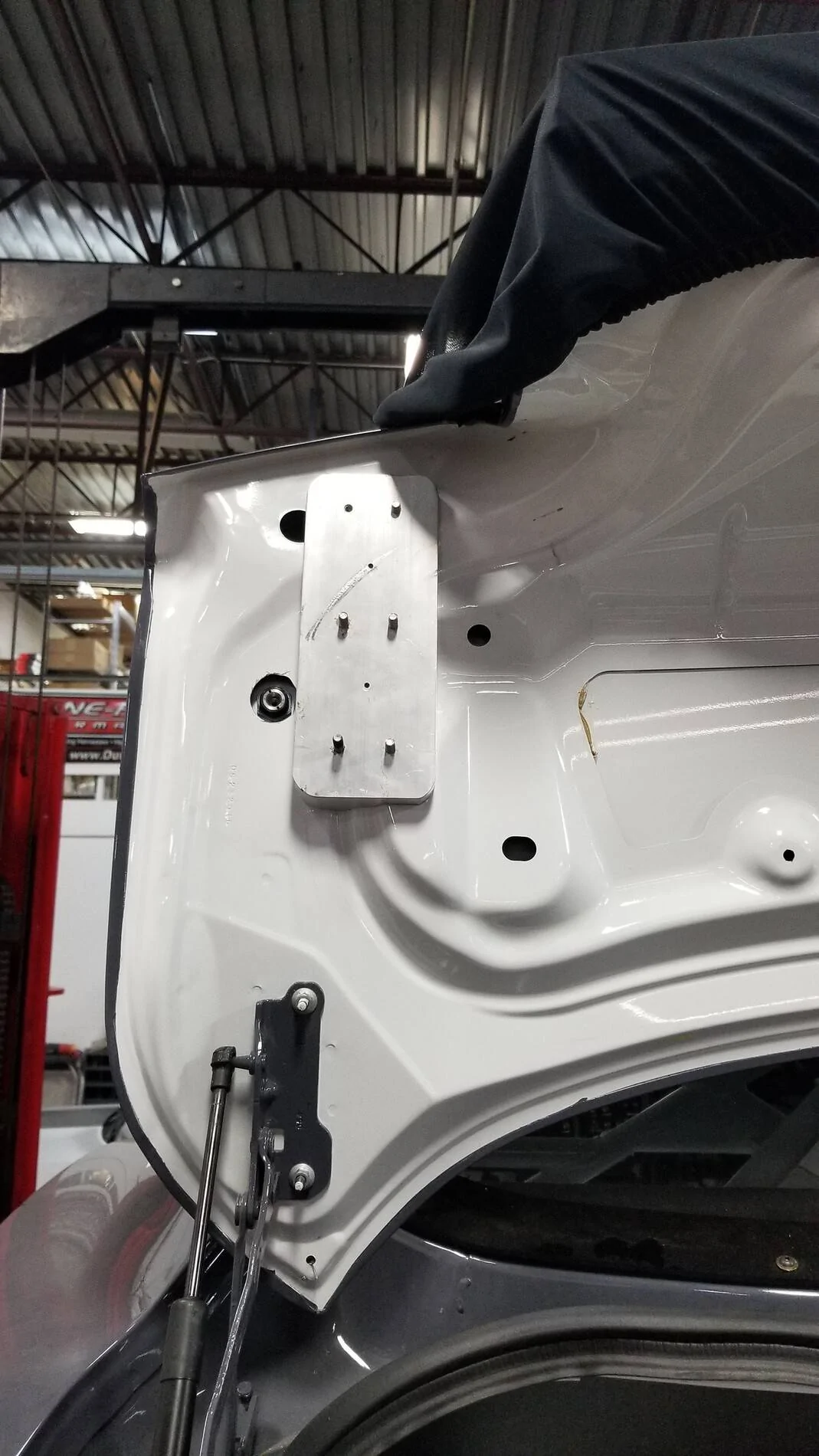

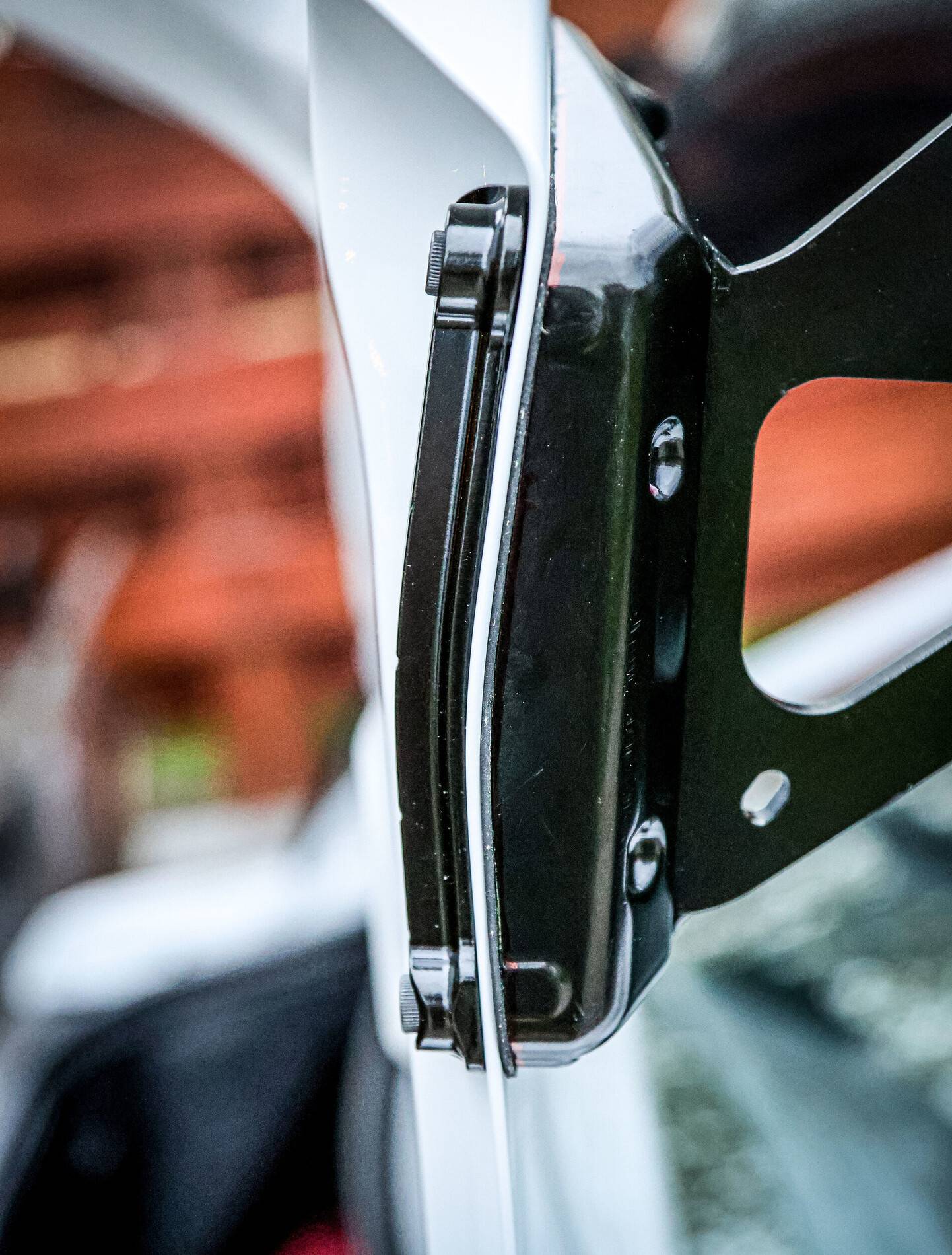

You may have seen the above photo when the GT4 was first talked about. What you never saw were the mounts on the underside of the decklid. I had ample opportunity this past November to study them up close and was impressed with the effort. A scan and some CNC work let to a tight fitting chunk of aluminum to spread the load.
I believe that test prototype was using a steel decklid as well.
The GT4 ended up using the same location as the GT350R production wing (as well as the yet unborn CFTP GT500), more outboard than what was tested early. There is much behind the location including fore aft ribbing on the underside panel as well as the load spreading dogbones used.
I would love to finally see what is going on underneath the decklid with your Archetype wing. I'm wondering if the uprights attach to the plate, while the plate has fasteners which then attach to the decklid. Or is it fastened directly through the legs of the uprights/plates (aside from the most inboard fastener in the triangulated pattern, off on its own)?
In addition, is the Archetype wing further aft than the GT4 mount, along with a longer chord? It looks like it and if so I could see the additional downforce created being too much for a CF decklid not designed to withstand it.

Tony, can you please post some shots of the underside of your decklid? And is Archetype purchasing dogbones from Multimatic, Ford, or making their own?

I’ll be at the track saturday. but its the exact same ones they make. Its def built in house.

I'd like to see how the baseplate and uprights interface through the decklid.
