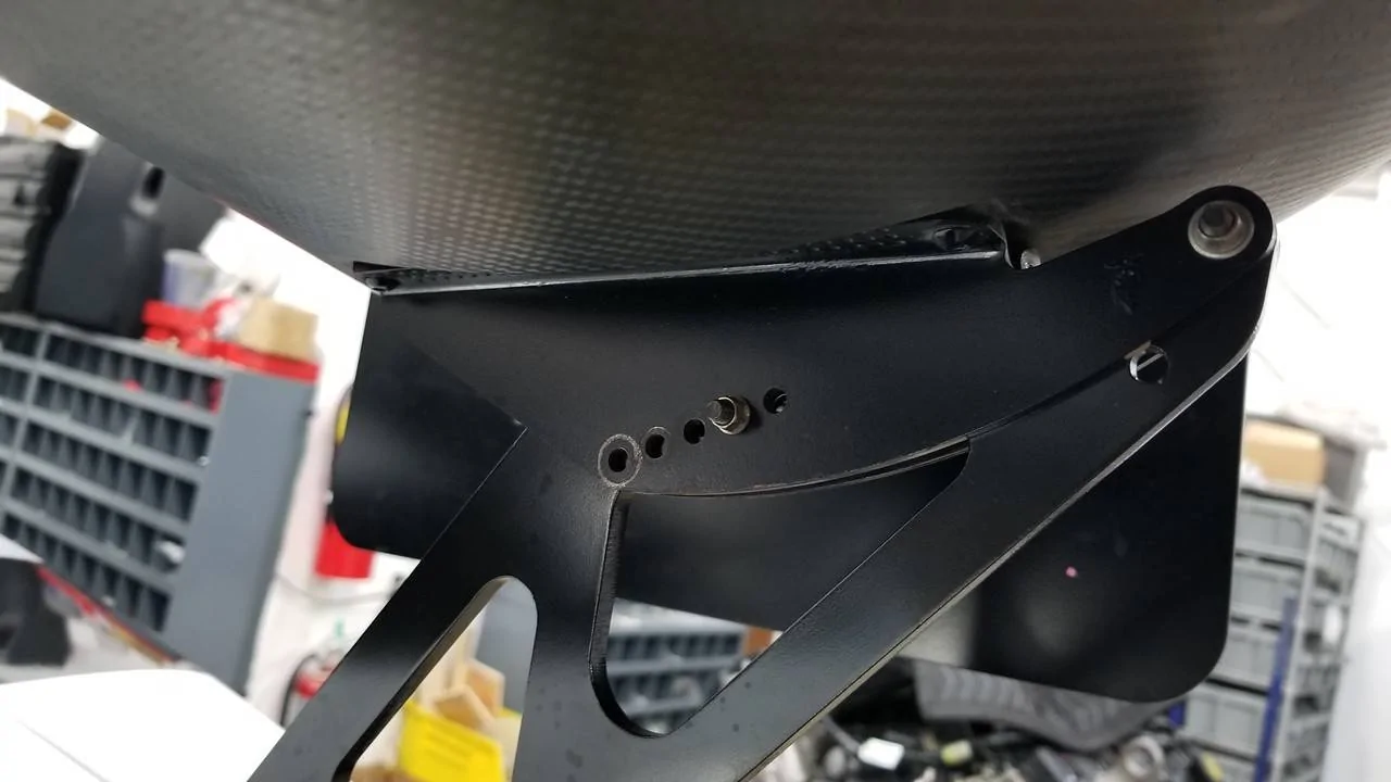

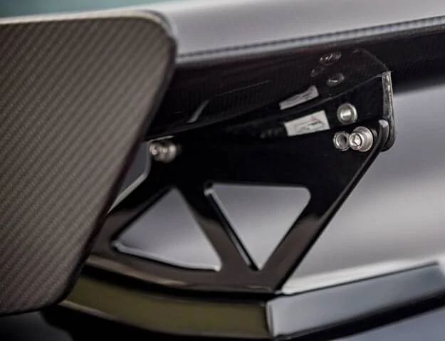

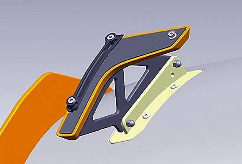

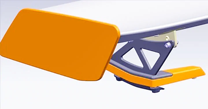

The GT4 and the CFTP upright differ in how they attach to their respective wings. Mixing the two can be done (see JG's example in the link I posted above) but it is not without caveat. So you end up reaming/drilling holes and are limited in terms of AOA adjustment.
From an actual GT4 car...
CFTP...
The simplest method is a scan of any CFTP mount available across the USA, then inserted into a given CAD program. The base is merely two contoured rectangular legs which meet to form a single "L" section, with the requisite fastener holes on the underside. The ladder section will end up being a hybrid of sorts with plenty of freedom in terms of design but the assumption would be that most would want it to not stray away from the OEM aesthetic. Just "taller" as Evolvd has asked for. Assuming the material of choice is aluminum, the two can be designed to mate either mechanically or via welding. The top of the upright can mimic the CFTP adjustment points of which there are two choices - or get crazy and design it for multiple mounting points for a wider range of AOA adjustment. The challenge behind any of this is when you design by committee, only a few are happy. If it were me, I'd do as I suggested and if somebody doesn't want/like it, fine. Do it yourself then.
