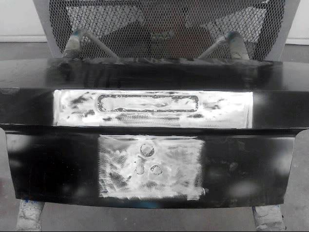

I had a 2009 GT500 that I bought new - great car. Modified everything. I wanted a cleaner look and yanked all the stripes, considered blasphemy at the time from everyone with a keyboard. I also wanted a cleaner look out back. I removed the stock rear spoiler and swapped it for a KR/V6 S197 spoiler. I then decided to purchase a new factory decklid, weld the holes shut for the emblem as well as for the third brake light (I relocated it to the exact same location Ford uses on the S550 - Ford saw the change and quickly realized they needed to mimic it:)). Anyway, be forewarned that even new in the box, direct through the dealer parts network, that the decklids need work.
Yes, I upset the aerodynamic balance, flew off the track and died a fiery death all in search of a more sano appearance. Thankfully I cloned myself and can keep posting.

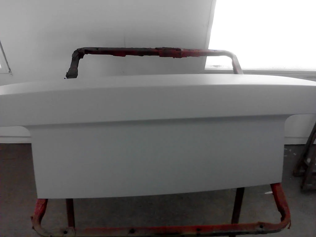

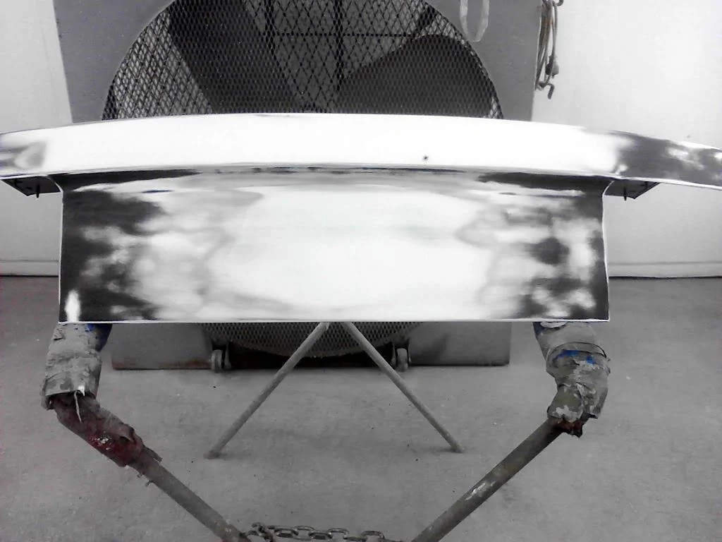

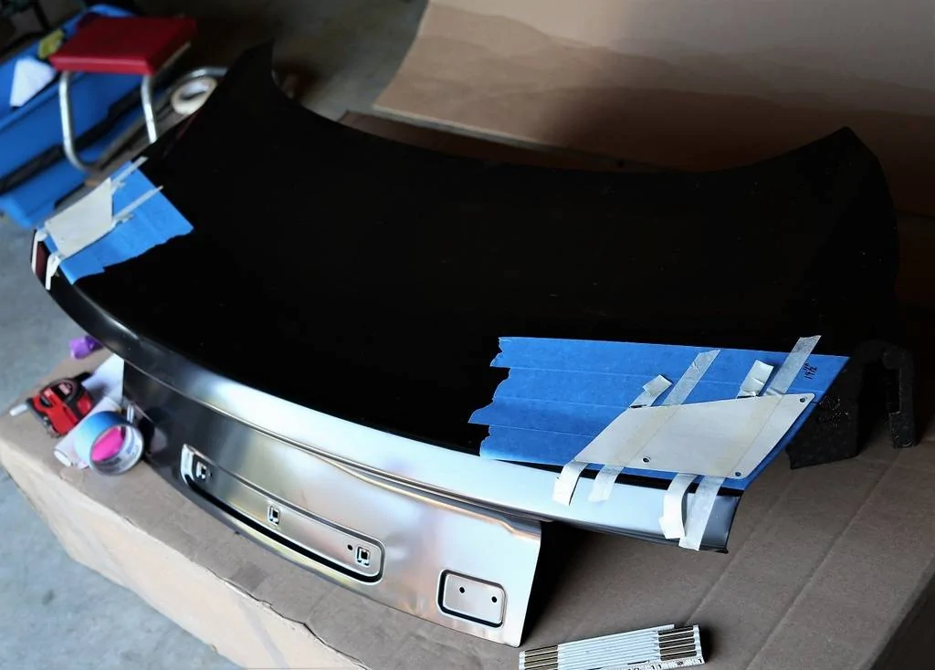

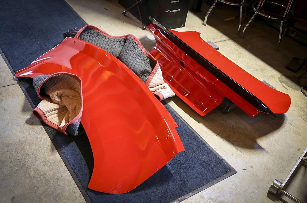

I modded my 2016 GT350 quite a bit as well. I added a CF R style wing and did the same thing by purchasing a new factory decklid. Went through the parts catalog for a decklid that had no wing and used a template to drill the holes. The layout is very similar, if not identical, between the R wing and the CFTP. Again, the factory new decklid required work as they often come with dents, gouges, etc. I think the parts network gets the units the factory couldn't use on a new car going down the line.
The decklid on the left is the one I purchased, drilled, had painted, and bolted the R wing to.

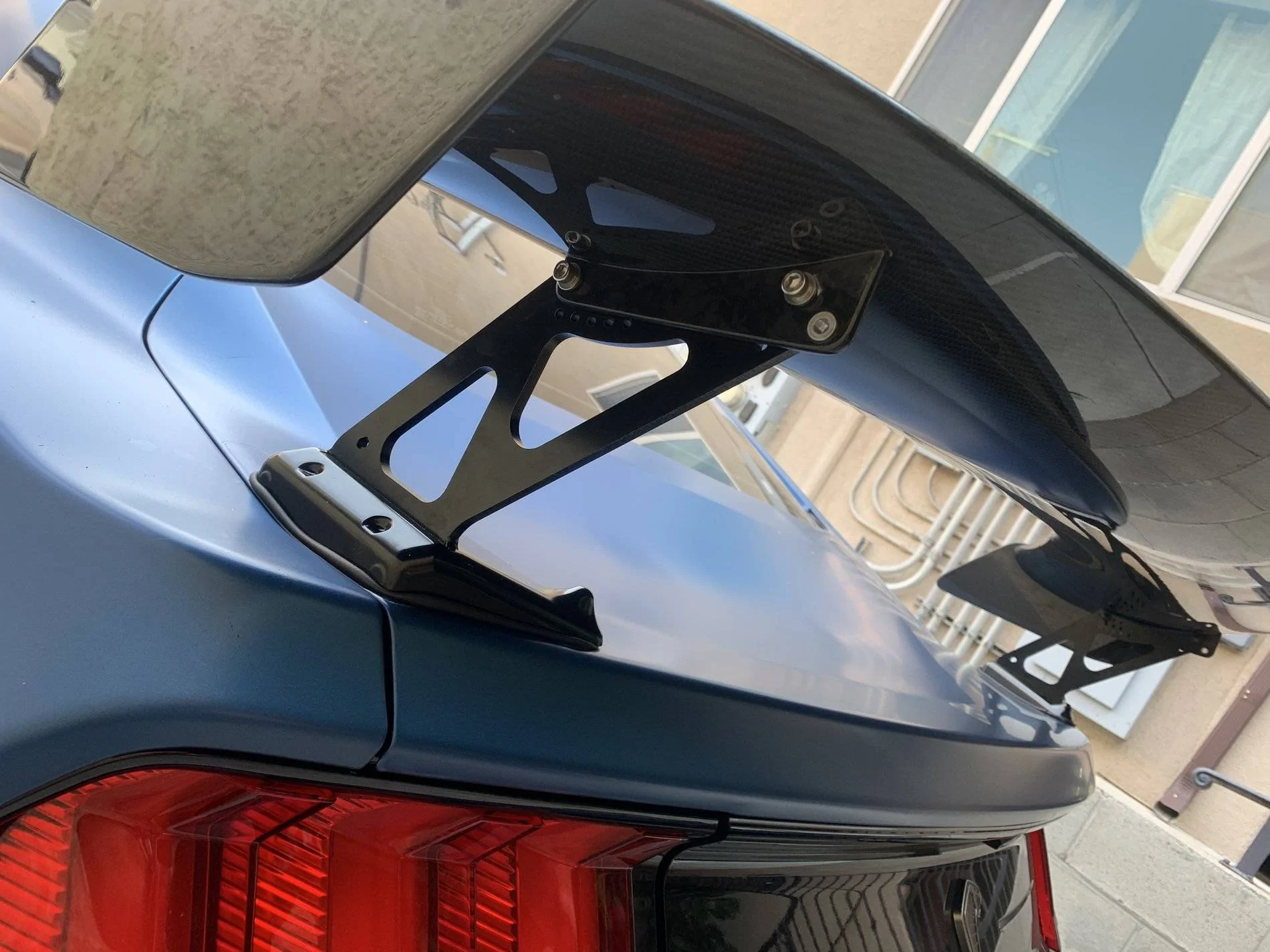

I believe the R model and CFTP wings are using the exact same dogbone, so those two respective holes are definitely the same. The third hole, which favors inward a few inches on the decklid is likely in a similar location as well. Regarding the mention of aftermarket CF decklids not being recommended for wing use...I can only say that the CF decklid manufactured by Multimatic for the GT4 cars gets by with the wing. Is there flexure at speed? Yes. I looked closely at the decklids at every IMSA race in 2018 and they were fine. Of note, they may thicken the layup for added rigidity but I never asked if they did this. I didn't see any internal bracketry with the decklid to add strength either. The third hole to the lower right is for a latch...the third wing hole is the one up above it, cropped in half in the next photo.

So why doesn't Ford stock a deklid for the R or CFTP with the holes already drilled? Since it is installed by hand on a separate line anyway, I sense they figured it was cheaper to not have to have an additional inventoried part and to just drill the holes come install time.

Two questions with regards to this, both now after I came back from my Auto Body shop discussing this.
First are all the lids the same from '15-'20? Cause looking it up in the ford part list it seems to be the case and I just wanted to be sure before my auto body shop guy gets one from his sources which would end up being cheaper.
Second thing is he suggested that I plug up the holes (him really) on the current lid and put the wing on the lid that came with the car and put the base spoiler on the "other" lid, his contention is the paint coloring is not going to be exact and he said even if its a hair off shade its going to bug me, and he's right it will annoy the crap out of me.

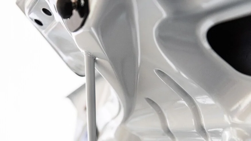

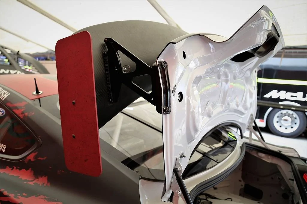

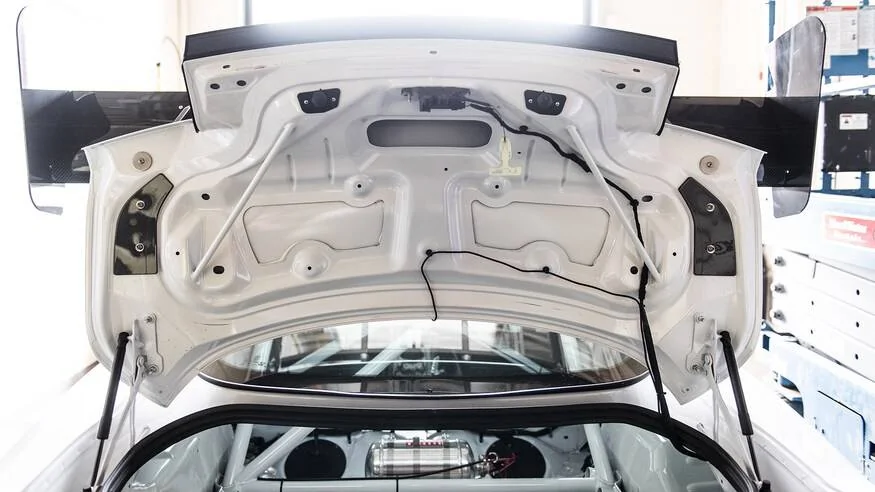

I haven't seen a GT4 Mustang do anything along these lines. I have noticed that Watson is welding a tube to the underside of the factory steel decklid on the FP350S. Note that wing mounts inward of the decklid and doesn't spread the load the same way as the one Multimatic does for the GT4 car (or the way the CFTP mount is done).
Look closely at this photo and you can see the reinforcing tube in place on the underside of the decklid.
If you want to keep it simple just order a Bullitt decklid as it won't have any holes.
I went back and forth on just modifying the stock decklid as opposed to purchasing another one and having it painted. Your body guy has a valid point. It is a bit of a challenge to match exactly the hue on your car. On both that I did I'd say it was a 95% match. I could tell but most others could not.
Well I was looking to see about going through his sources probably yards that have them for sale from wrecks, I would see if his sources had any without spoilers first, because getting it new will be far more than getting it from a yard at his cost. (I dont get charged anything over his cost if anything). My only concern is color matching. And if I decided to use the original my other issue is the middle of the base spoiler mounts to the center of the car, which he will have to blend during covering the holes. i guess the only way to get that match is for him to use the 2nd lid and try and get as close to it as possible mixing small batches to get it near perfect.

I just popped off the outer gas filler neck cover panel and brought that to the paint supplier my body guy uses. They did a near perfect job matching it to that.

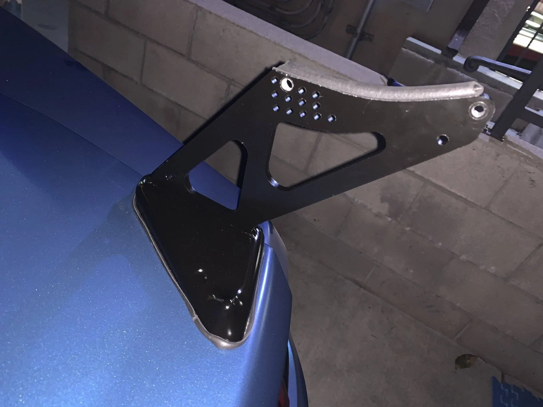

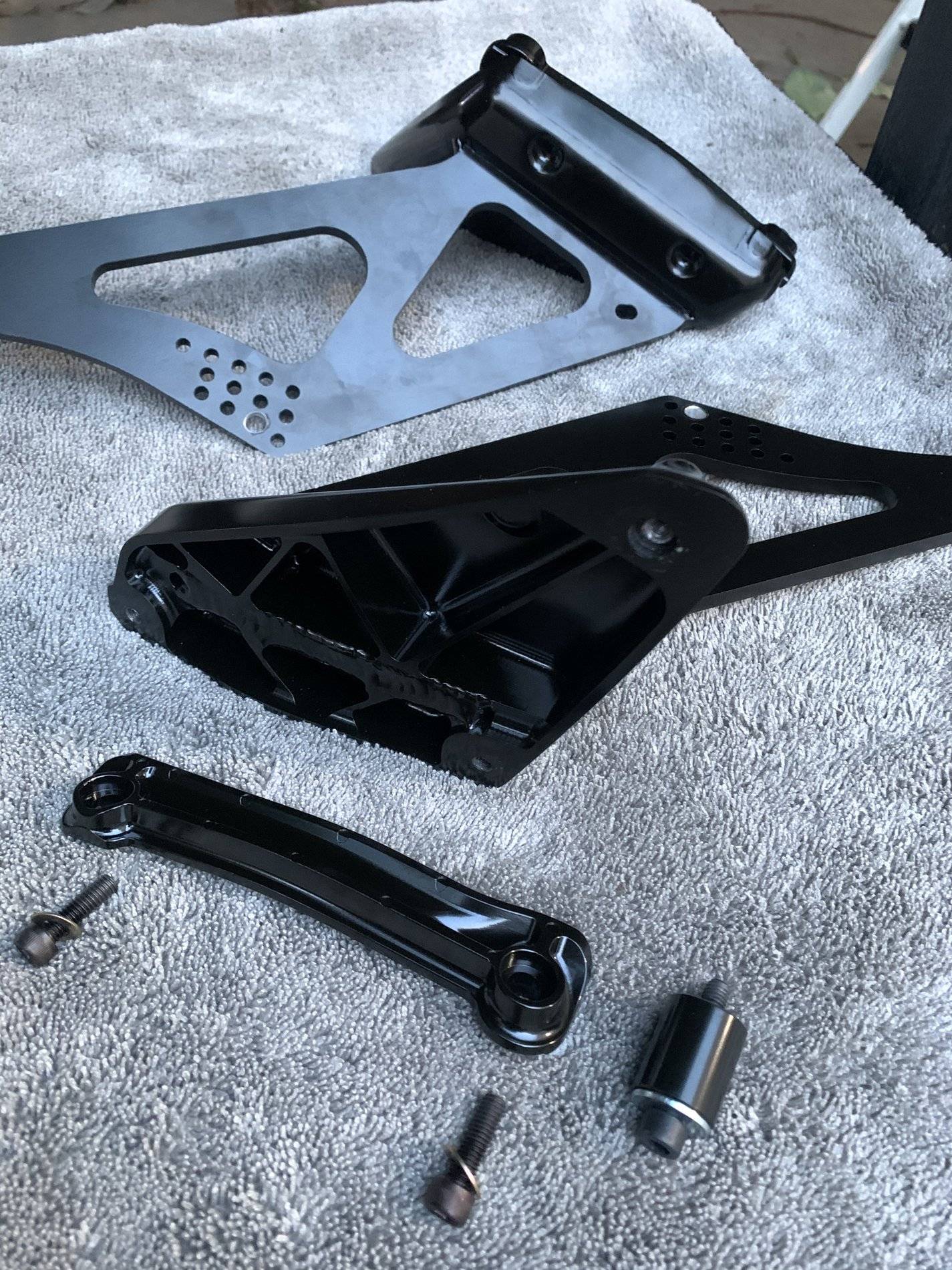

Is that a continuous o-ring gasket around the perimeter of the base? And did the GT4 upright base bolt right in place of the OEM wing base?
GattmanLA
Jul 17, 2016
77
109
Los Angeles
Joe
2020 Ford Shelby GT500 (SOLD)

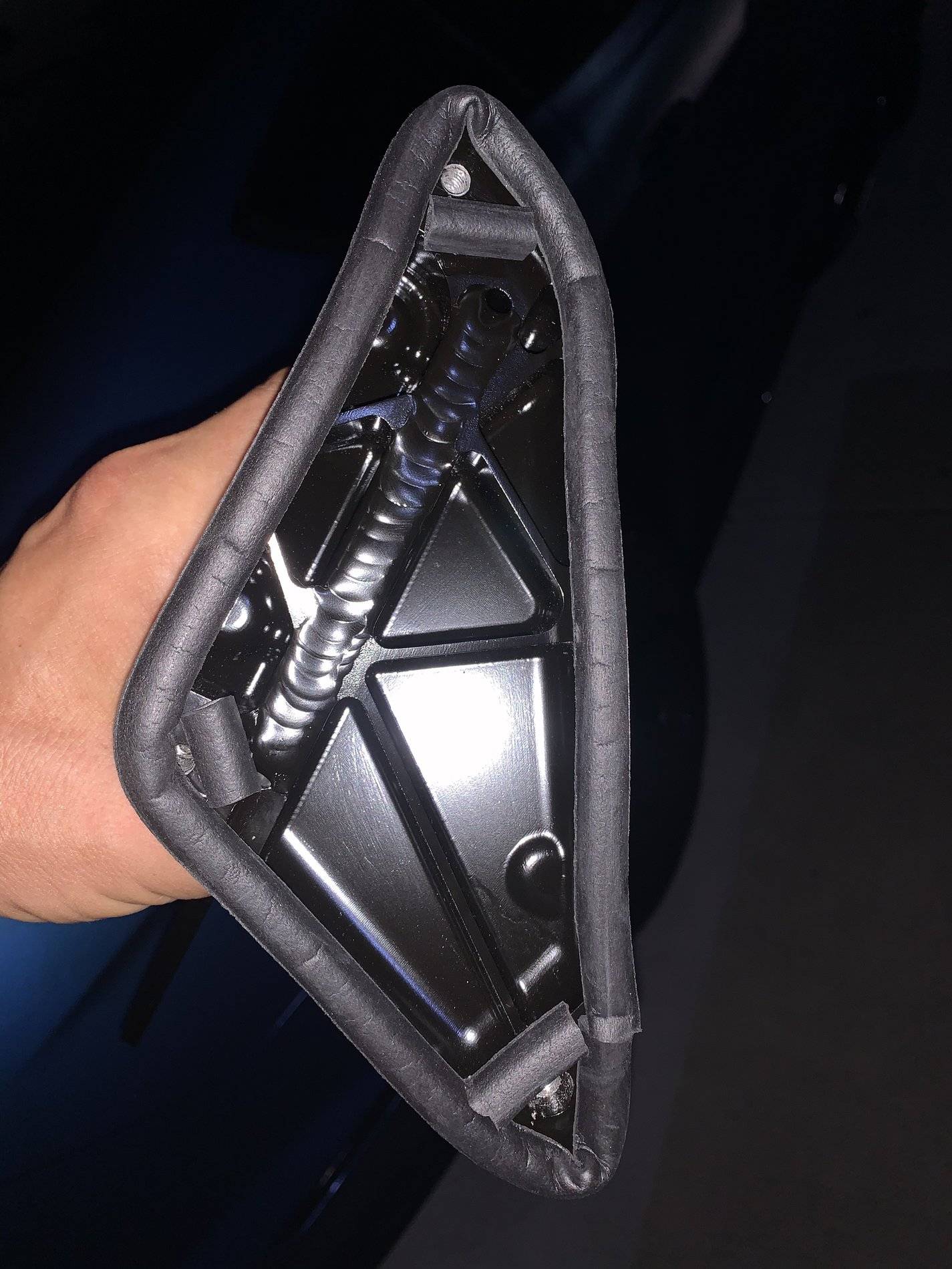

Yes. Its a thin rubber gasket that goes around the whole edge.
The GT4 mount bolts right into the same holes as the OEM ones. Its a slightly different shape and the hardware sent was slightly different but the holes are the same. It doesn't have a gasket though. I guess on race cars you don't need to concern yourself with weather sealing and bolting metal to metal and possibly causing damage. So I jerry rigged one from thin weather stopping from a hardware store. It worked great but wasn't too attractive. Then the guys at Multimaltic created a gasket for me and it works much better. Much neater.

I’m at Charlotte this weekend and the underneath of a gt350s rear deck has 3 holes with washers welded to the shims. Not 2holes has shown in this picture and they are straight up and down in a row.

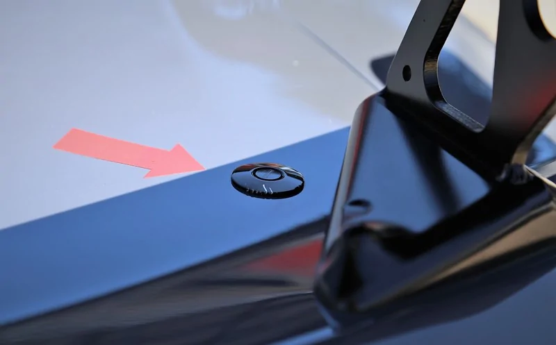

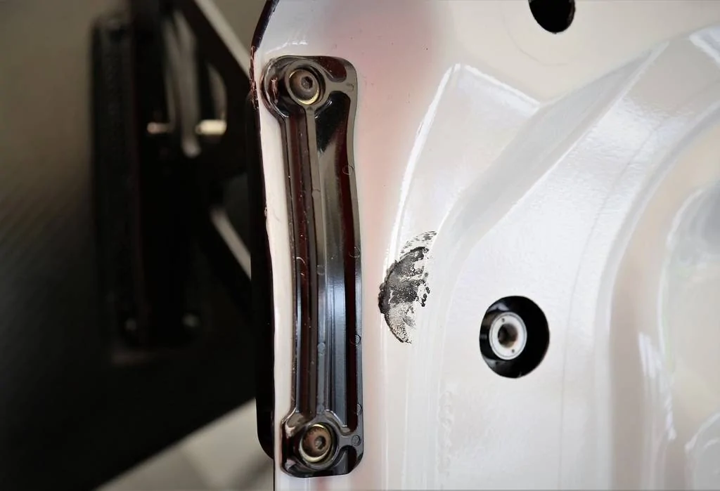

The two outer holes along the decklid edge are "in a row" (vertically). And as I mentioned, the third hole, to the right, the lower of the two, is used latch the decklid down into place. Here you can see it from the topside, in place on one of Multimatic's GT4 cars.
Thanks for the shots. I'm familiar with the GT4 wing and hardware and wondered what you did to use the GT4 uprights with the production car CFTP wing with it's embedded mounting bracket. I see you drilled out the hole at the top front/rear of each bracket and didn't use the other brackets that the GT4 wing uses up top.
Out of curiosity, did you even have to put pressure on the uprights inward or outward to get them to mate so readily with the CFTP wing's embedded bracket? It'd be surprising if the fit was perfect, as if it was designed to be that way.
