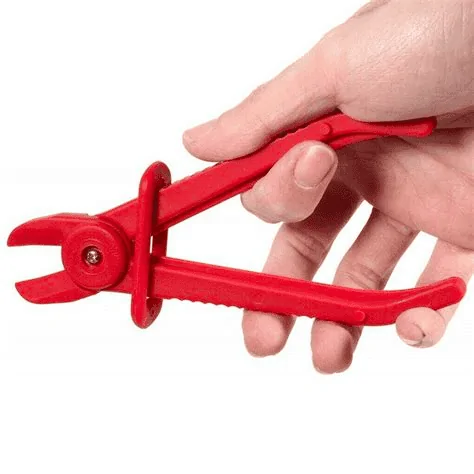

Woah! .... couldn't see in the video but do they bleed the brakes too in the pit or do the cars have a way of getting air out or preventing air from entering??
I'm guessing they're using clamps on both the incoming unit which might have been pre-bleeded, and clamp the outgoing system so that the rest of the car isn't dripping.
That said, there's likely still a small bubble I'm going to assume that they either quickly pressure bleed out since it should be right there near the tip.
