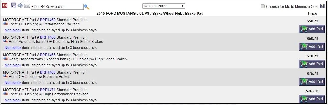

Hopefully someone comes up with pads for these cars because the factory parts is pricey.
Even though the 13-14 Shelby used a similar brake set up as the 15 uses the rotor offsets changed for more clearance. The numbers are all completely different....at the OEM level. We'll see what ends up happening when the aftermarket starts making them.
