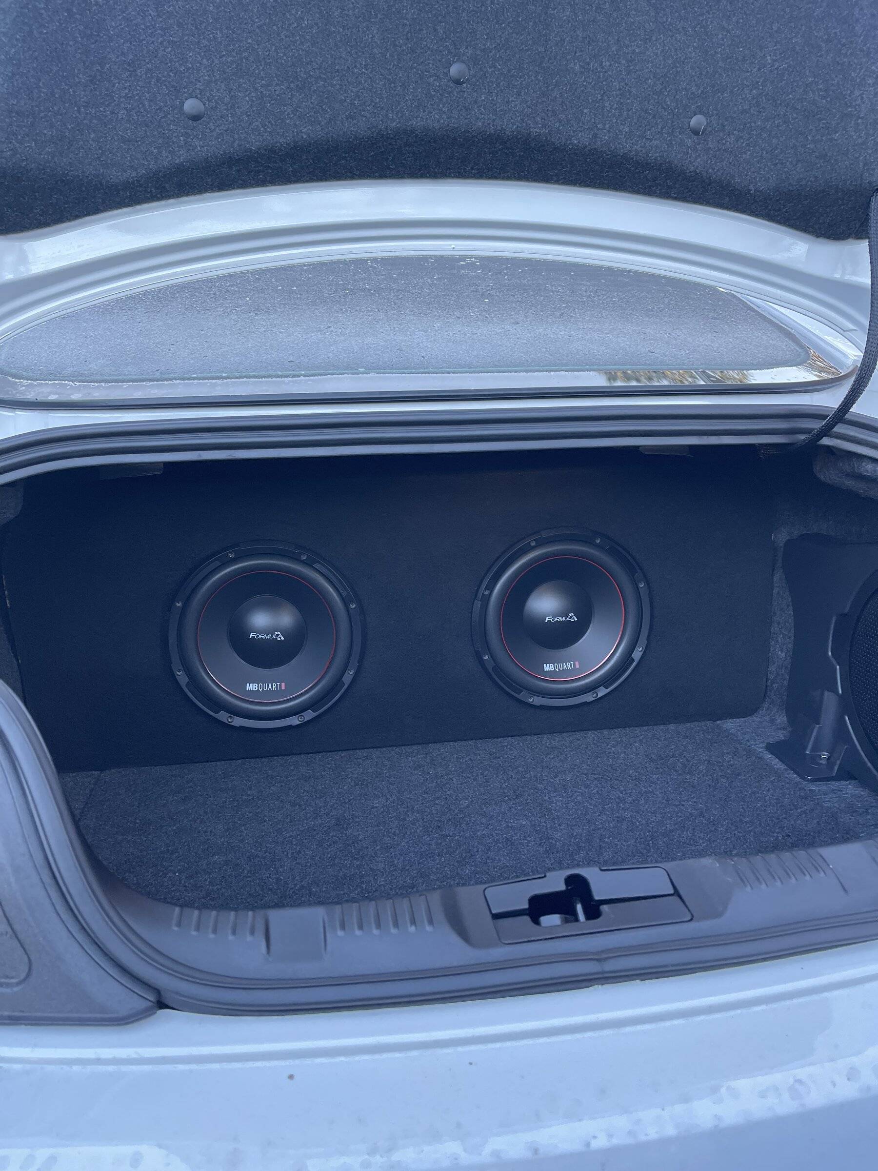

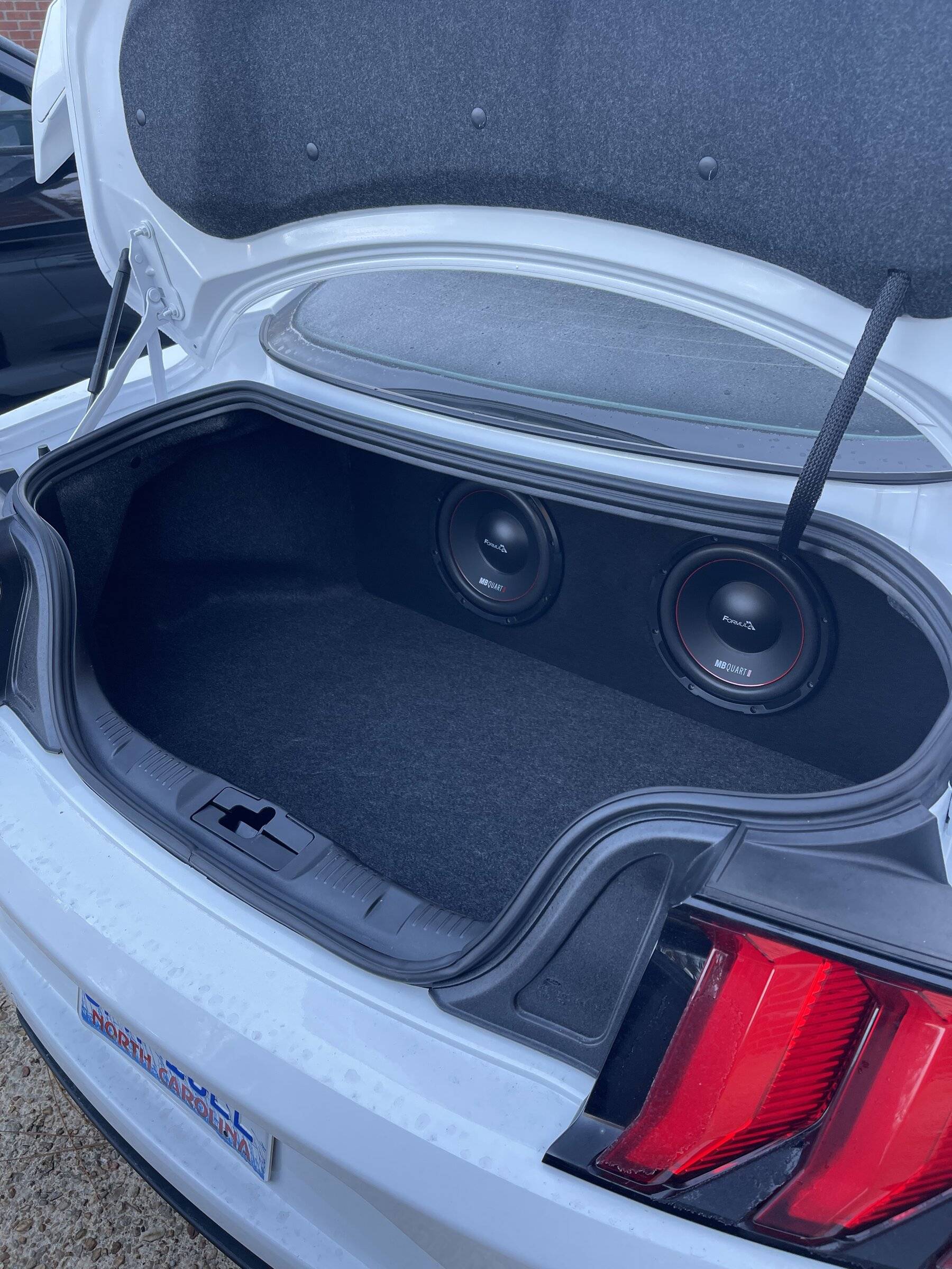

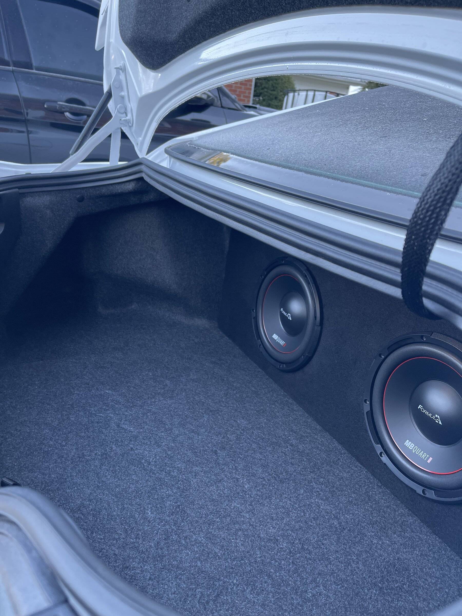

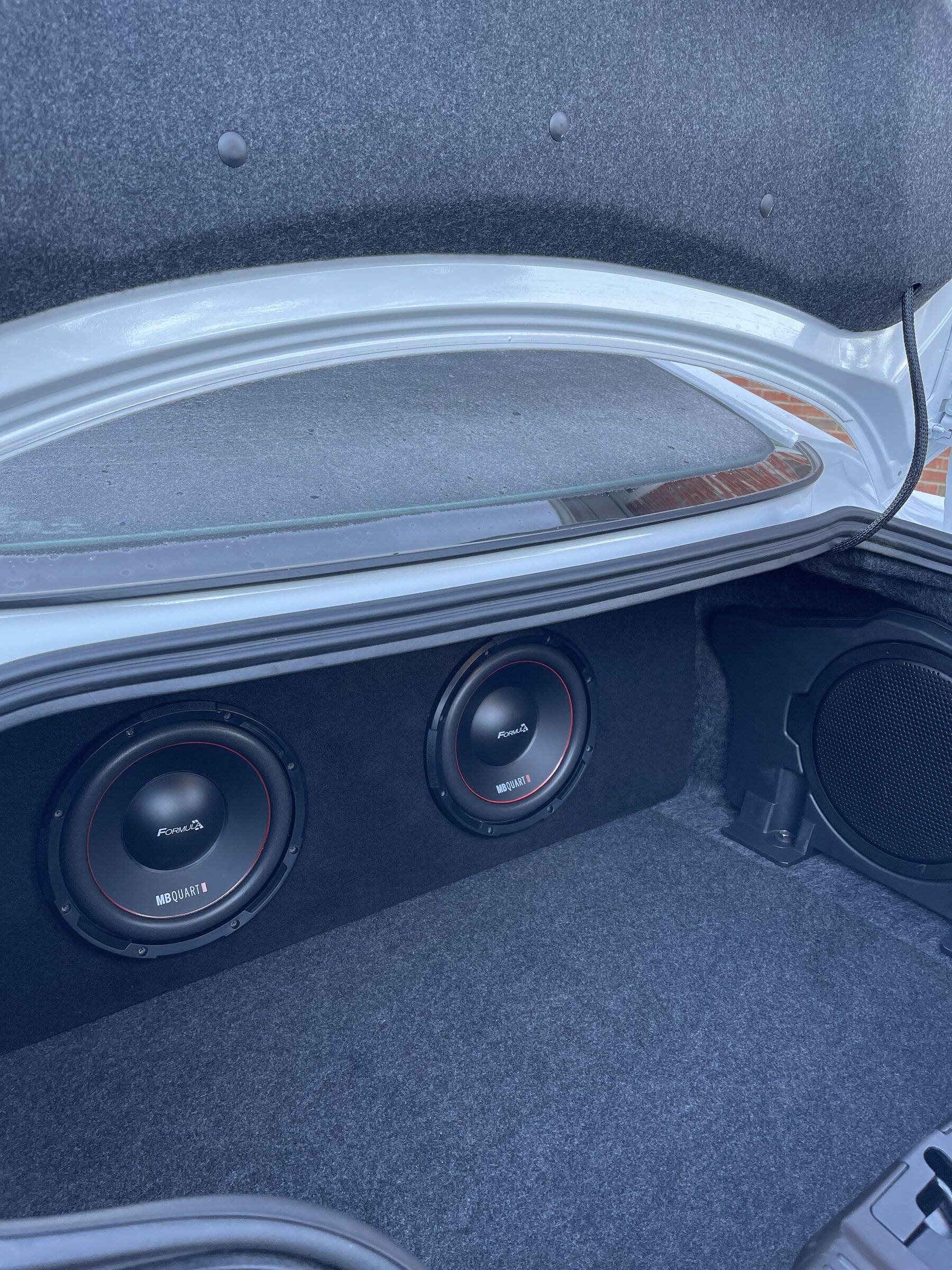

It’s all finished I know there was a lot of questions on this subject, but here is my setup ran completely stock just added subs and amp to existing B&O system!!!!! Any questions on how I did it let me know I will help out as best as I can , from the knowledge brought to me from some great people on here.

Nice job! Now get some grilles before something bad happens.

Looks great. I am sure it sounds good.
