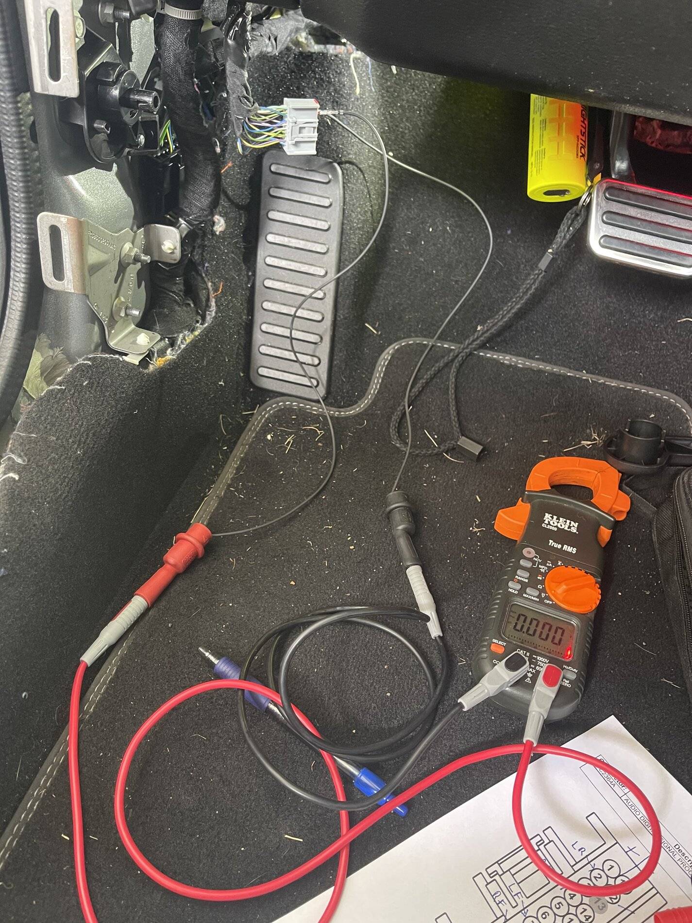

Yes, it makes it sound better if you don't put in another DSP or amplifier into the equation.
But if you ever plan to replace the stock amplifier then it's not necessary to shut of the EQ in a 9- or 12-speaker setup as the ACM is only putting out front left/right and rear left/right fullrange variable line output in this case. Not highpassed, not equalized not anything as all this is done in the stock amplifier in such setups as the Forscan settings regarding the EQ only change the high output from the amplifier in these setups.
But (!) don't ever make the mistake to use a line output converter in case you got a 9- or 12-speaker system, ever!
Why someone wants to convert a high output signal when he could use a variable line output signal for aftermarket amplification is beyond my imagination.
Why convert a crap signal, probably high passed and clipping at a given volume setting while he could use a non-clipping up to volume setting 30, unaltered and flat variable line signal?
Even if you "only" have a 6-speaker system and want to use an aftermarket setup it's just using Forscan and an OBD2 adapter to reprogram the ACM to put out variable line voltage for front/rear left and right to get rid of any eq, clipping or whatever.
Better spend the money of a line output converter into a DSP of some kind and have your ACM reprogammed.
There are T-harnesses for both non- and amplified systems available that go either directly beyond the ACM or at the stock amplifier connectors, and they are way cheaper than any LOC you could possibly get.

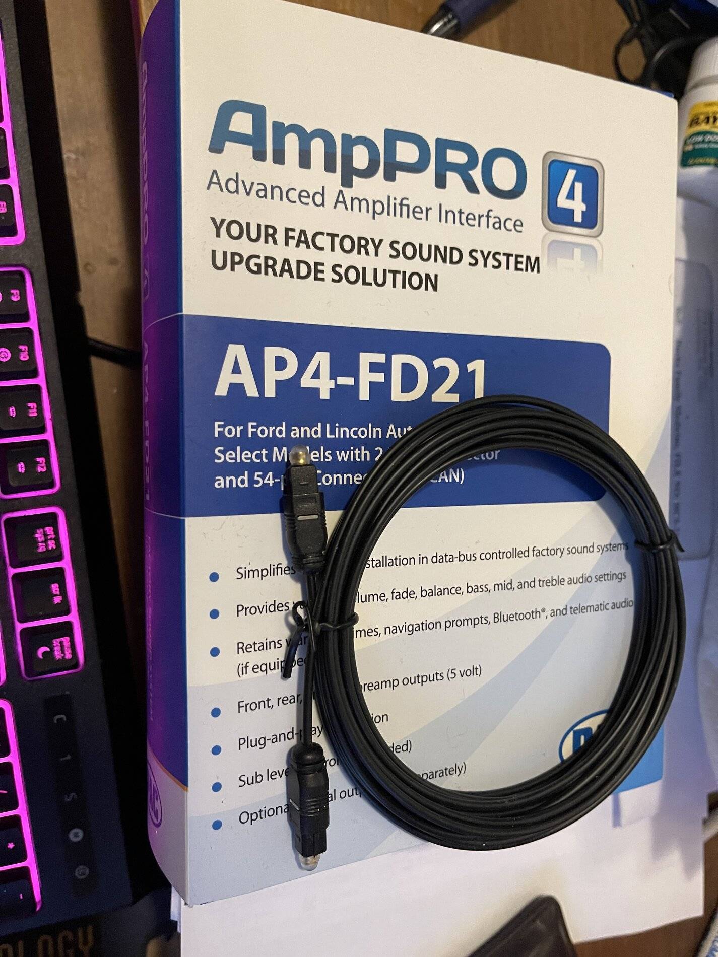

Cathul, do you know the settings in forscan for a 2020gt 12 speaker b&o to make the acm do variable line out? I was just testing it as it sits the other day and the vol was fixed. I’m about to add a helix v eight dsp/amp and I’m trying to figure out if I’m going to use a PAC unit or if I can do this with forscan.
Cathul
Sep 4, 2017
931
426
Germany
Peter
Ford Mach-E
B&O is using A2B-protocoll.... You need a NavTV Zen-A2B or a Pac-Audio AmpPro for this.
jbeez
Apr 22, 2020
PHL
Jerry
2020 Mustang GT Premium Perf Pkg1, 2014 Taurus SHO w/ PP
This should do it? I was trying to use as little gear as possible but sounds like this is a requirement.
thank you!
