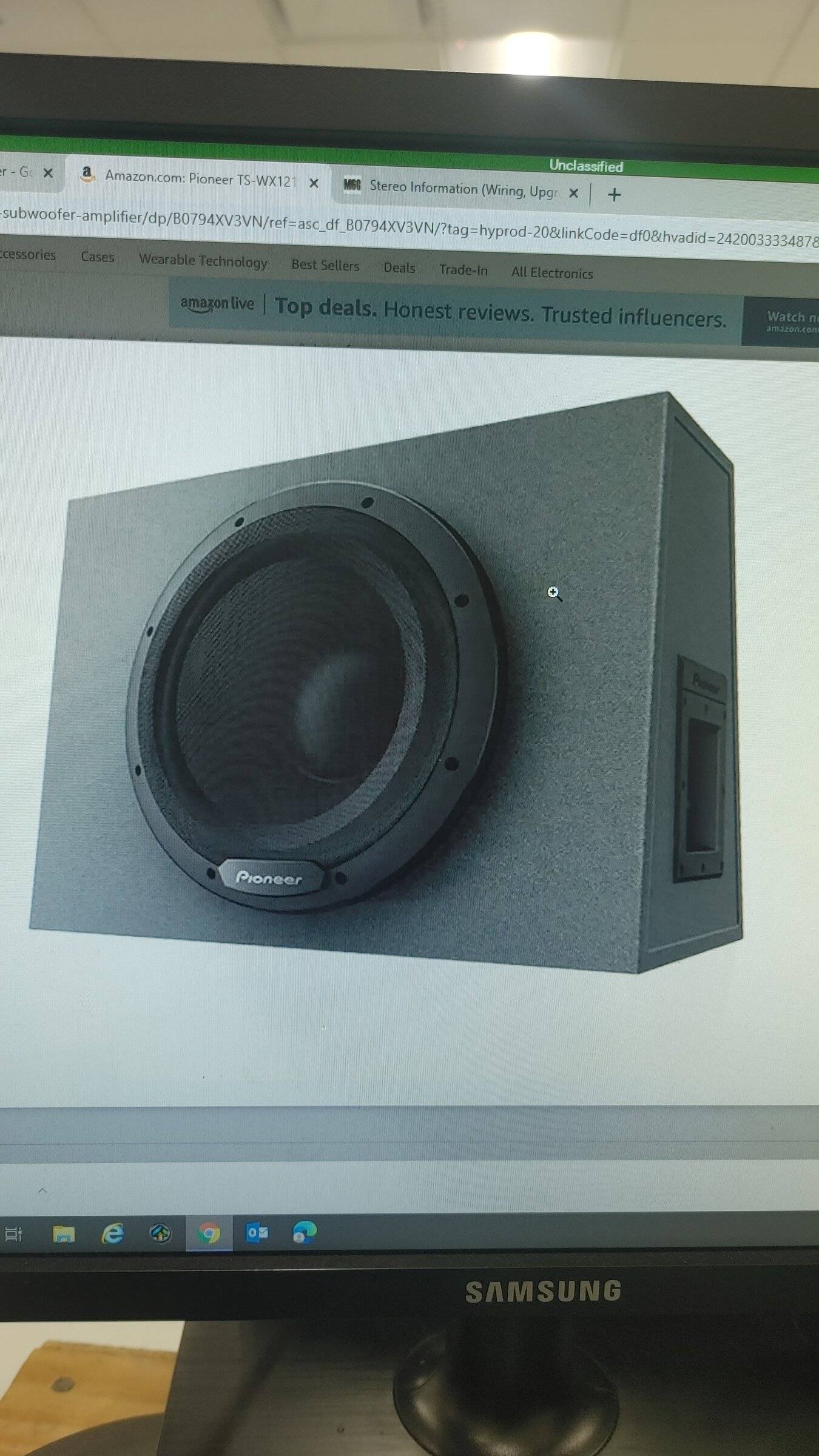

Oh also let me say im using the micro add a fuse currently in spot 23 inside the passenger side fuse box. As a checked the voltage it read around 13v with accessory on, and 0 when switched off. Also 13-14v with the car turned on, again 0 when completely off. So i figured that was perfect to run my remote on. Perfect crimp from the add a fuse, and i have the wires twisted at the amp and sub because i am still in trial before i make it permanent. That twisted wire shouldnt make it flicker though im sure, because it doesnt come loose at all. So i have no idea, its almost like the voltage drops below what the remote wire needs and makes it flicker.

When you say "flicker" do you mean the LED on the amp is going on-off. Or the sound from the sub is cutting in and out?

Yes to both. So when the remote is hooked to the sub and amp i get a steady blue light, the sub plays. But then it starts to flicker as like its not connected or under power, and while its doing that the sub doesnt play. I know its connected because when i cut the car off down to accessory mode it stays blue (powered) and the sub plays no problem. And as stated nothing is loose. Ill post a video in a sec

Edit: I just realized you said you have an all-in-one amp/sub. So don't open the box to try this. I thought you had a separate amp.
Try disconnecting the subwoofer from the amp. Does the amp stay on or does it behave the same way? If it stays on, the amp might be going into a protection mode.

I have an all in one sub amp setup you cant separate them. It has a harness that has hot,ground, rca hookups, speaker wire, and a remote lead.
