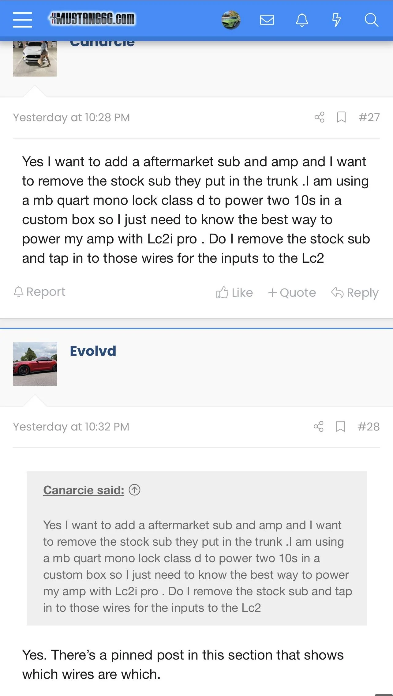

What equipment would I need to buy to use these factory wires for the required signal so that I could install an amp to power just a sub?

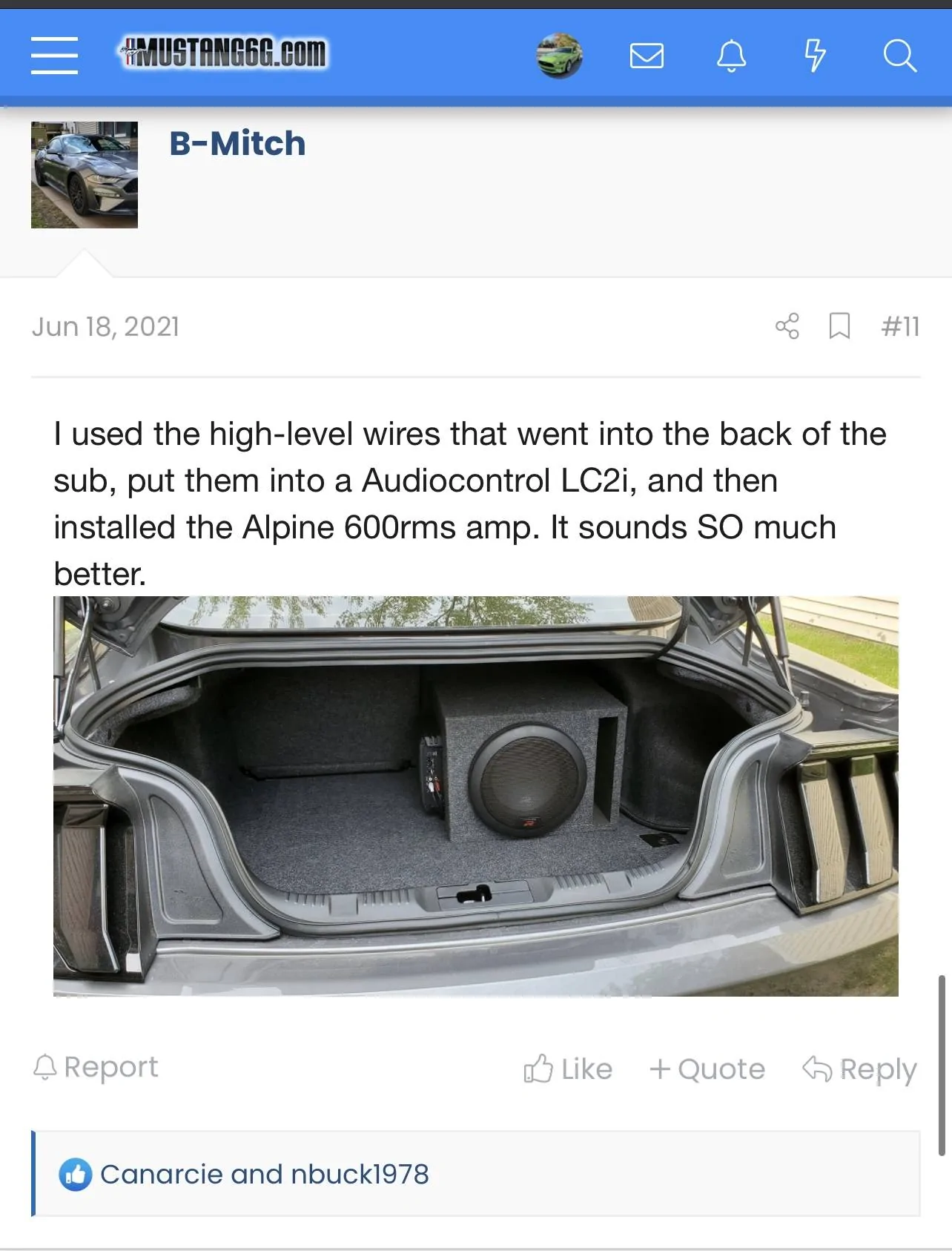

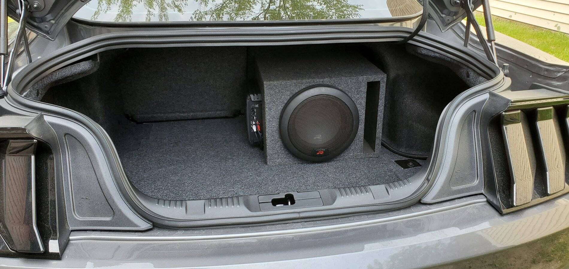

I used the high-level wires that went into the back of the sub, put them into a Audiocontrol LC2i, and then installed the Alpine 600rms amp. It sounds SO much better.

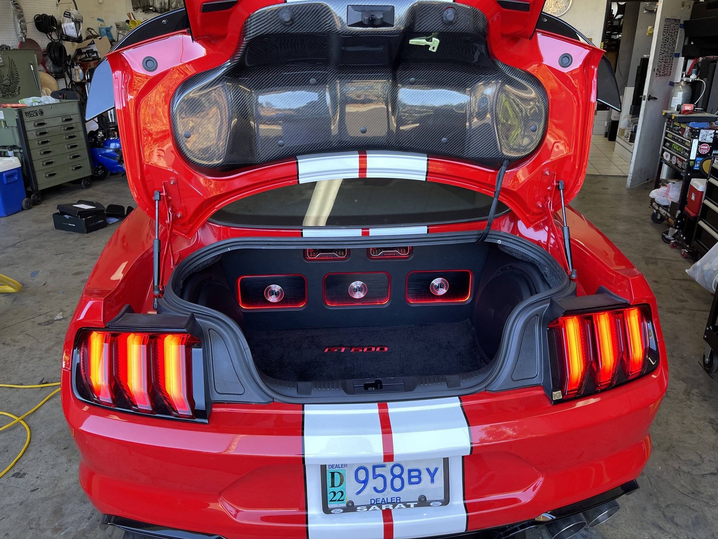

Went with 3 of JL Audios VXi line amplifiers with built in DSP's,
2x 800/8
1x 1000/1
Hertz Audio Mille Legends 3 way components running Active in the front and Hertz Legends to 2 way components in the rear
2 of JL 12" TW3 Subs
All the Speakers are install in the stock spots for a very clean look. The Trunk was a lot of custom fab to give that clean built in look.

Great so these are the inputs for my Lc2pro for Signal
