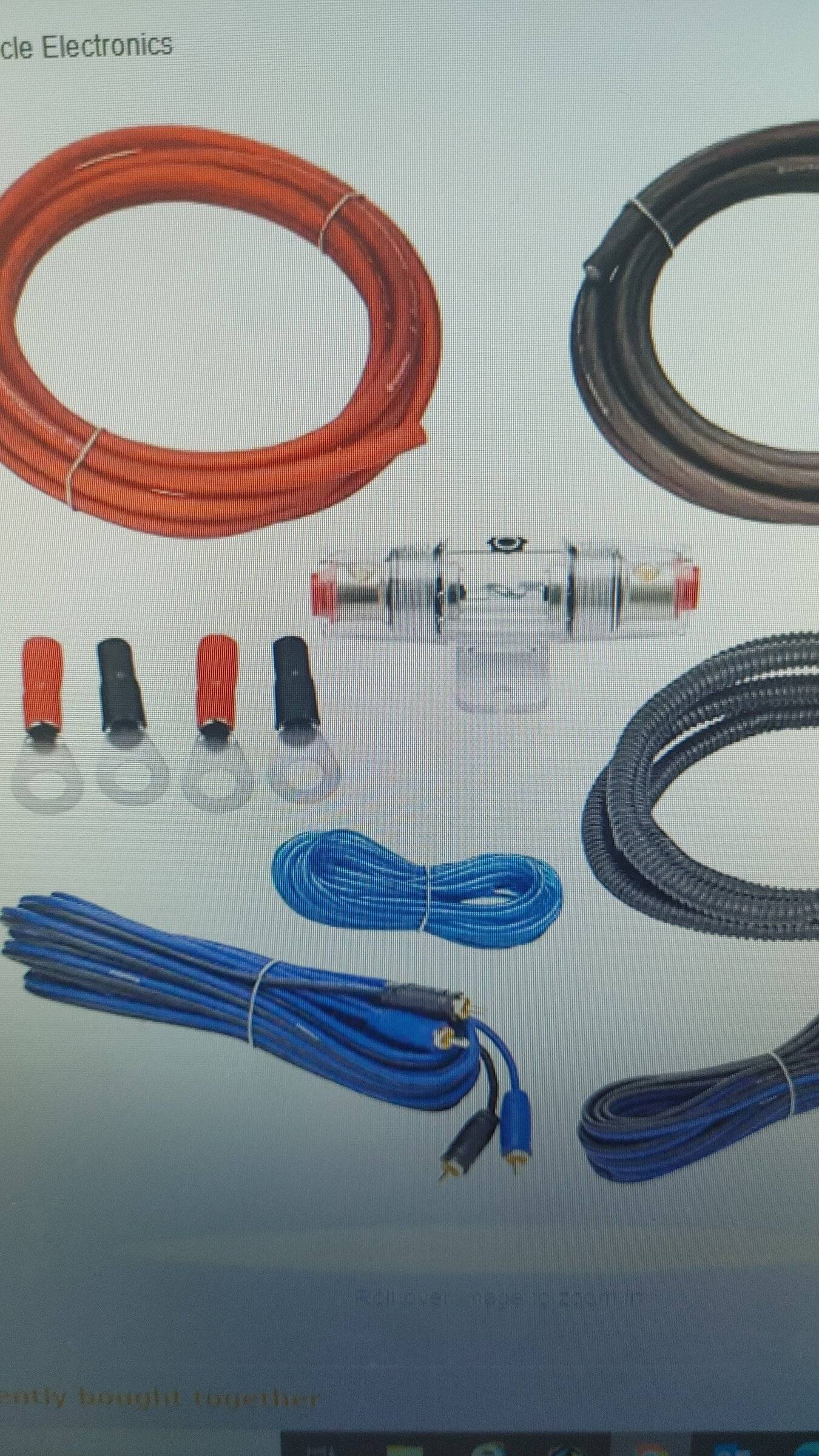

I have the power on the battery positive with a 30 amp fuse in between. The battery was new as of my purchase that was something the dealer did to give me piece of mind.

Ok. Next question is how did you attach the ring terminal to the battery post? Your amp is shutting down. Not your remote wire. I saw the video.

More likely the amp is not getting enough current and simply turning off. When the amp turns off do you still have +12V on the remote wire? Keep your meter connected and watch what happens when the amp shuts off.
You can have voltage with almost zero current flowing in a conductor. The amp needs both current and voltage to operate. Think of it as a water hose. The current is the amount of water flowing through it and the voltage is the water pressure. If the hose is choked or folded so that the flow is restricted, there will be no flow and just a dribble. Equate that to a power wire. Somewhere at your connection point to the power source there is a "restriction" or insulation preventing the current from flowing freely to the amp. Check the battery terminal and the fuse block. The battery terminal has a black protective coating on some of the surfaces that act as an insulator. If you mounted the ring terminal to a surface with no good electrical connection, that can limit the current flow.
