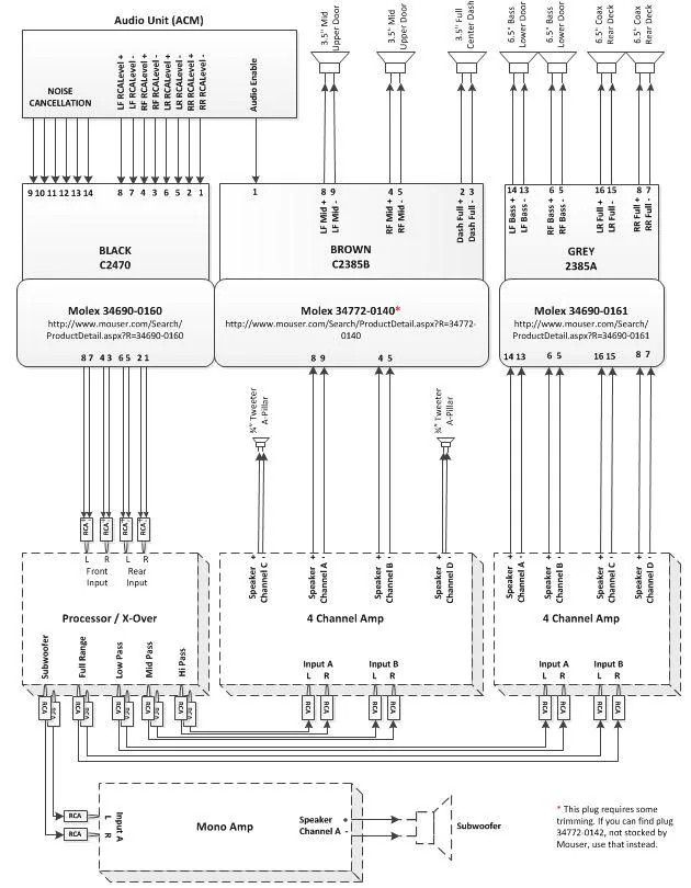

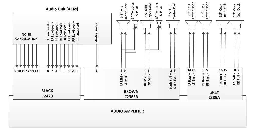

I'm going to pop these two diagrams back in here since they are buried pages back in this thread;
The first diagram shows the factory connections and signals, note that the tweeters and midranges are tied together in parallel.
The second diagram is one way (of many) that you could connect aftermarket amps & processors to the factory wiring using the molex connectors listed. Using this method, you are taking the low level (RCA level) signal from the head unit into a DSP/crossover unit, something like a JL TwK88, RF 3Sixty.3 or Helix DSP. Because the signal is low level, you would not need the LC7i.
If you want to use the LC7i, you would leave the factory amp plugged in and tap the outputs from the Brown & Grey connectors to feed the inputs on the LC7i which would then feed the amp(s). This has some implications in that the factory amp is not really outputting a full range signal except to maybe the rear speakers... this can probably be fixed with Forscan, but that's another road.
