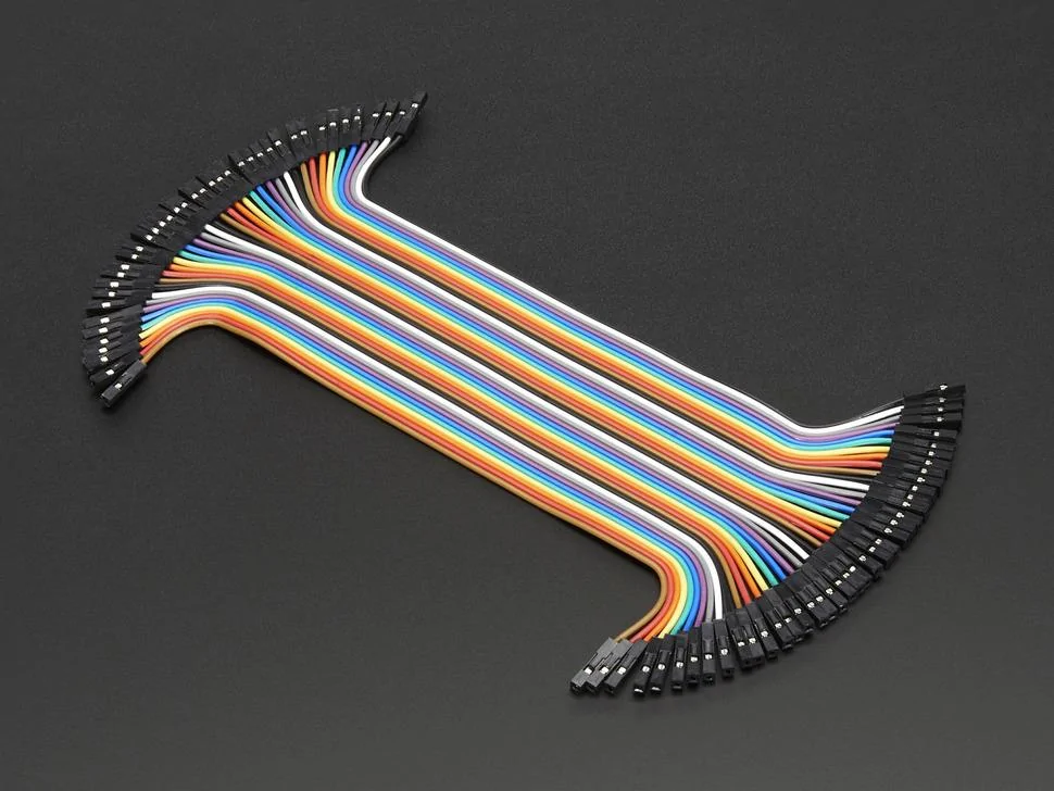

For solder-phobics like me, i'm going to try something a little different for attaching the wires to the molex connectors. I'm going to try two separate methods:
1) I ordered a simple 2x8 IDC female/female ribbon cable as a wire break-out for the line-outs. I'm going to see if I can get it in the body on the headers.
2) I also ordered one of these: https://www.adafruit.com/products/266 - it's looks easier to use as a breakout for the RCA's but the single connectors could cause it to come apart easier.
Neither will work for the speaker connectors as the wires are much too small - but dang, trying to fit AWG16 wire on those pins is a bear.

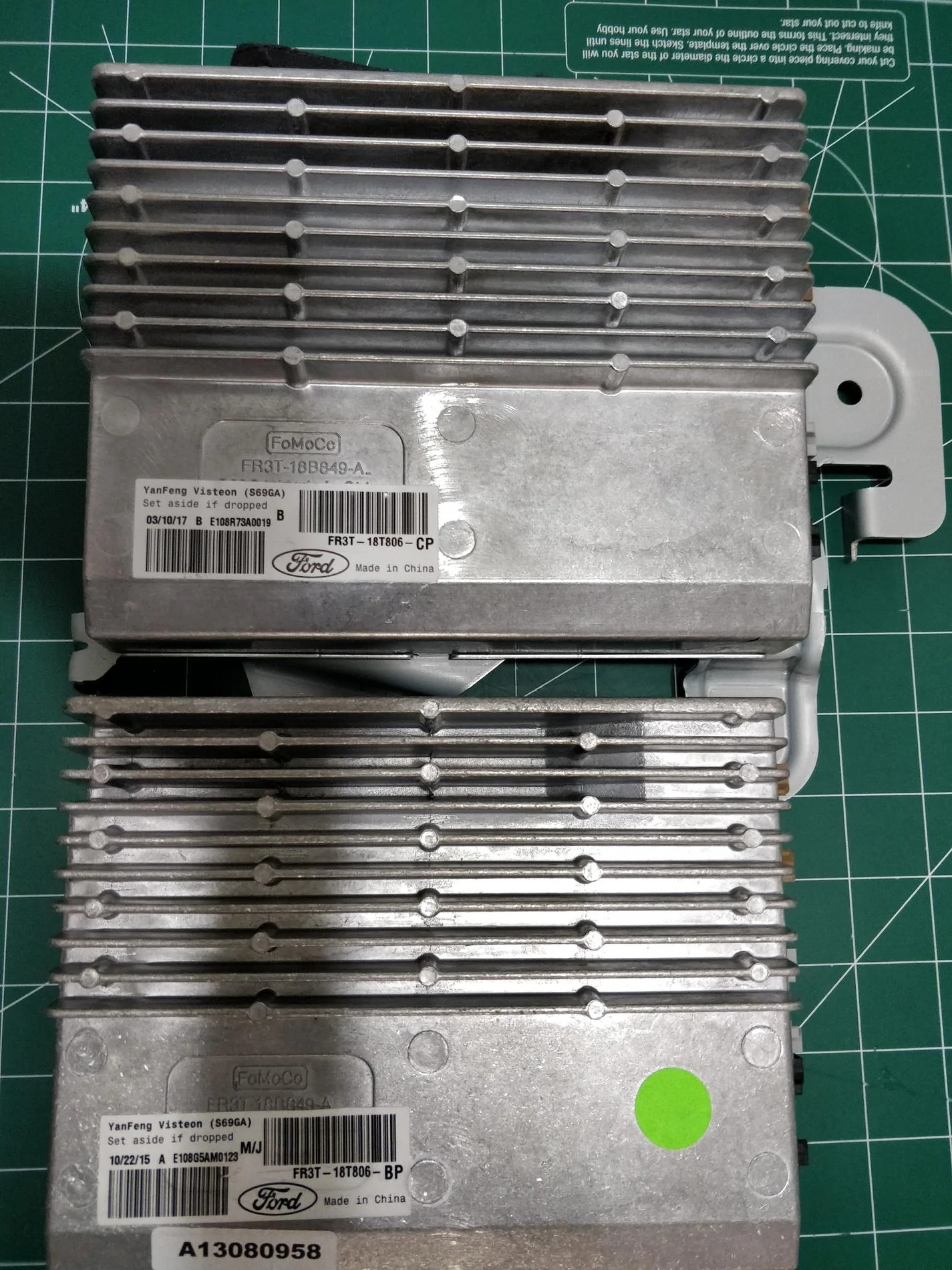

One of these is from my Premium 9 speaker 16 Ecoboost
And the other is from My 17 GT with 12 Speaker Shaker Pro
is there a difference ? I have heard there is internal wiring for the factory sub. but they look the same.
