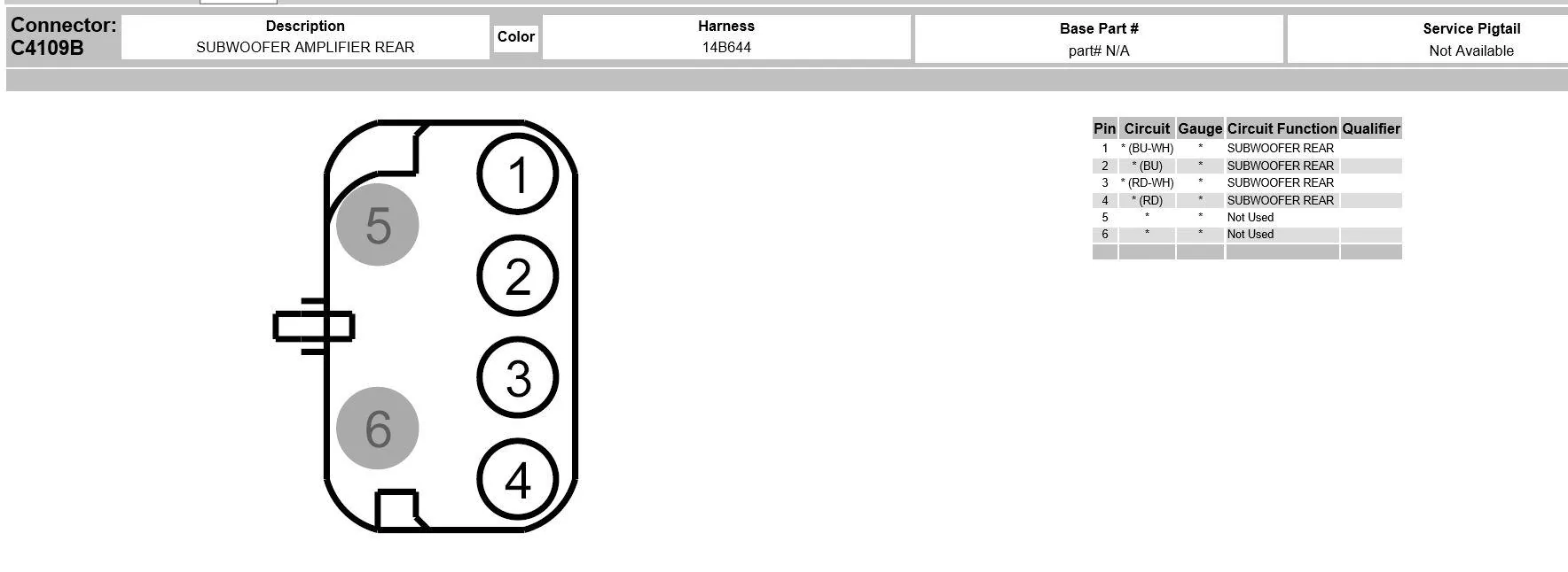

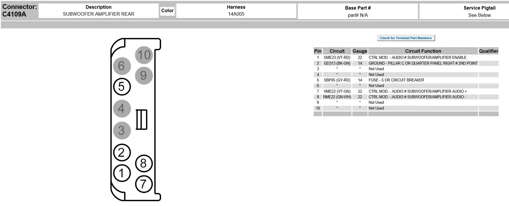

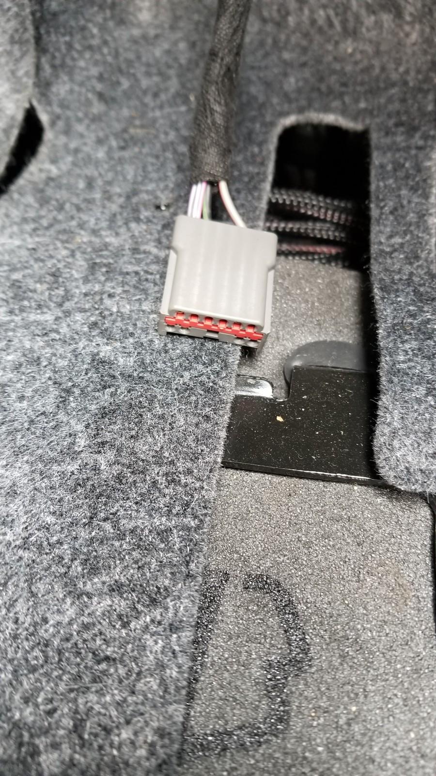

Those that have retro fitted the shaker sub, how did you wire it all up to the amp and front of the car ect? Where did you get the plugs and wiring ect..?

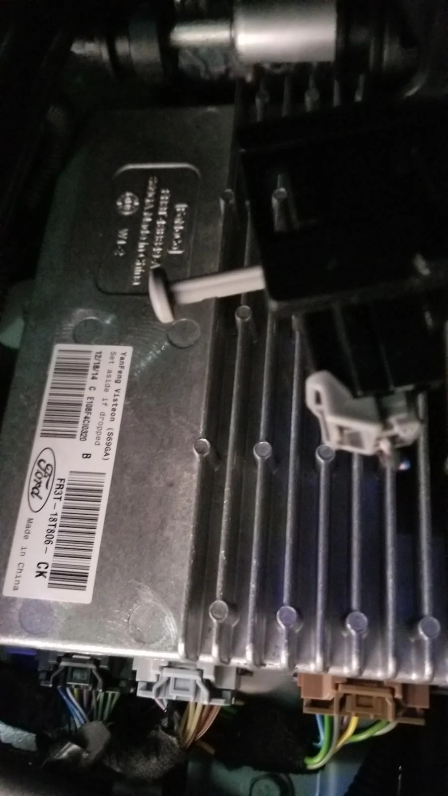

You need the DSP/Amp from a 12 speaker car. The 9 speaker DSP doesn’t physically have the traces for the subwoofer out on its circuit board.

How will it work on cars that do not have shaker sub in the rear and there is no wiring plug for it either? Does it come with the wiring loom?

Cool all-in-one upgrade for a 2015 owner who wants Shaker Pro. As for adding wiring and harness info for the trunk sub, I did a few posts about that on this forum. I am still underwhelmed by my bass level, so likely wil use an Audiocontrol processor I have laying around to pull the full-range stereo signals off of the rear deck speakers and feed an aftermarket sub with amp.
If the entire Sync 2 setup means 8” screen and Sync 2 nav, that is cool for someone wanting better than the 4.2” screen on their 2015 - if price is right of course.

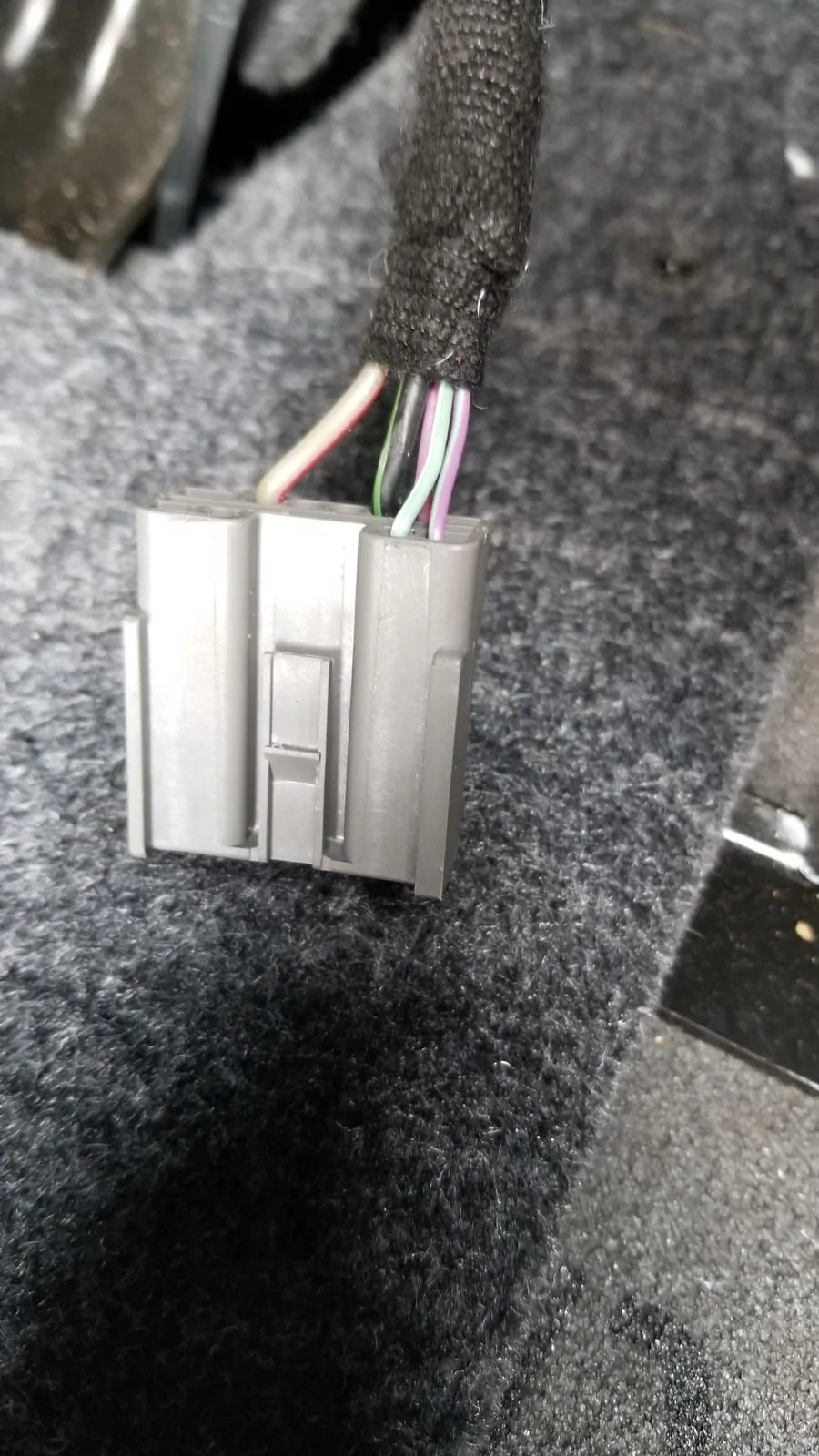

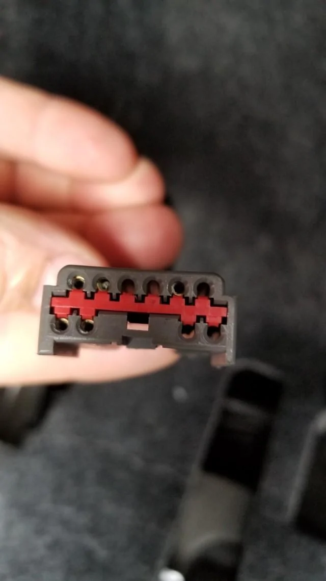

I will provide all the speaker connectors including both sides of the sub connections. The male and female part at the sub amplifier.
All of the amp connectors are on Mouser's site. You would need to run all of your own wires to the speakers and the sub but you would have the connectors.

I started a thread called "I want to de-program my rears speakers EQ". I still believe that the rear deck speakers do NOT receive full-range signal, therefore, the full trunk sub upgrade is a viable alternative to futzing around with the deck speakers' signal. IOW, I don't think any black box that is fed from the rear deck speaker OEM wires will deliver more bass.
One way (that I haven't tried or proven) would be to move the rear speaker wires at their input end over to the front speakers' terminals at the footwell amplifier, and then purchase a small high-level-input 2-channel amplifier, installed in the trunk (needs 12V wire run). Even this assumes that the front door speakers receive full-range, and I am not sure of that either.
