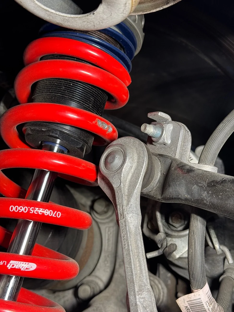

Looks like the endlink rubbing the spring was far more aggressive than I thought. If it was jamming into the spring randomly that could explain why the back of the car has been so unpredictable.
Making my own offset bracket now to test at next event in two weeks. Also swapping 600 to 700lb rear springs, rear upper control arm, and rear toe arm. The rear Camber arm specifically to get rid of the last bonded bushing in the back.
The last bushings I’ll have left are in the front lateral and tension arms. But I’ll probably get spl arms to replace them.

Oof, is that just the stock rear bar back there currently?
Yep. And the slots for the shock lower mounts are biased fully toward the axle. I didnt even know relocating the bracket was a thing till Steve Wynne told me about it down at Crows.
This may also explain why my car has always handed far better with the rear bar removed.
I have a vid from my last run at Crows where the car just all the sudden snaps sideways at part throttle 3 times in a row with a left turn.
