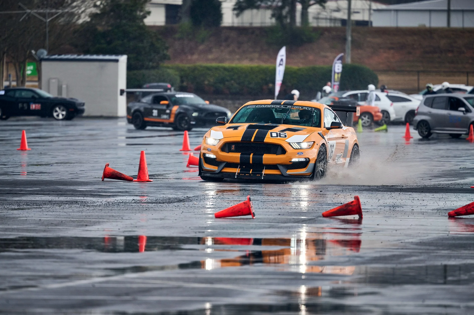

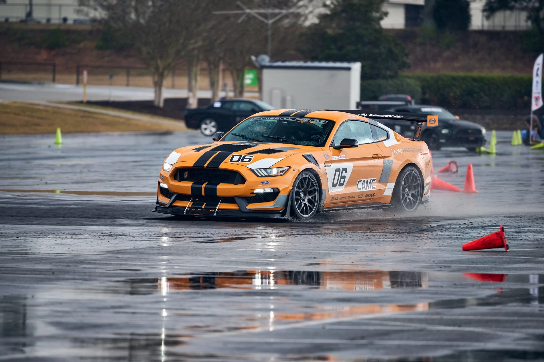

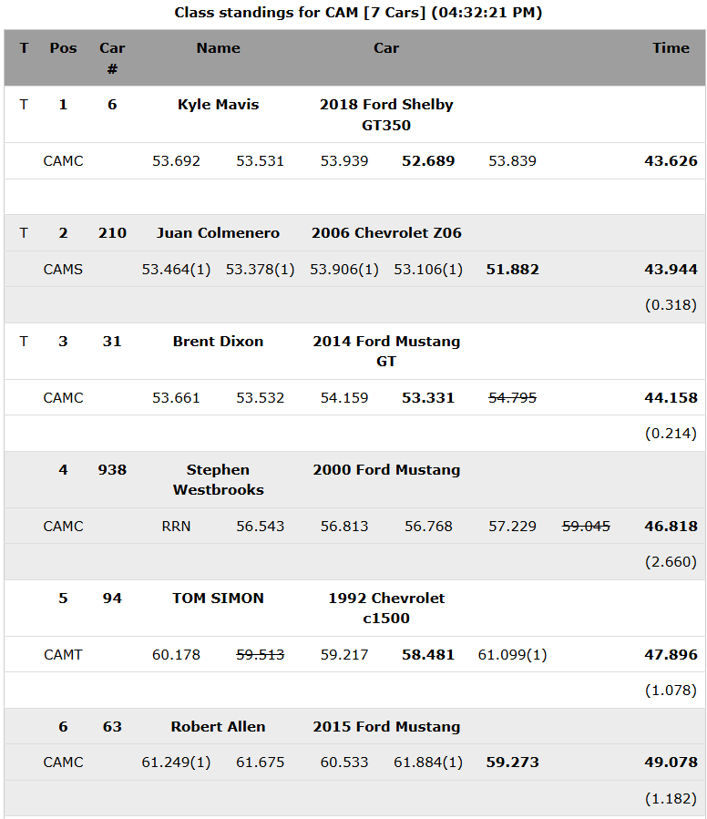

First event was a rainy mess, took 4 clicks of compression out of the front and rear to try and get the car to get some bite, and it sort of worked. This year our region combined CAM into one PAX index class as we didn't have more than 3 or 4 consistent CAMC cars and only 1 or 2 random CAMS/T cars ever showing up. Luckily driving clean saved me from my buddy Juan and his Z06 as he had me on raw time and index time, but picked up a cone on his fastest run.

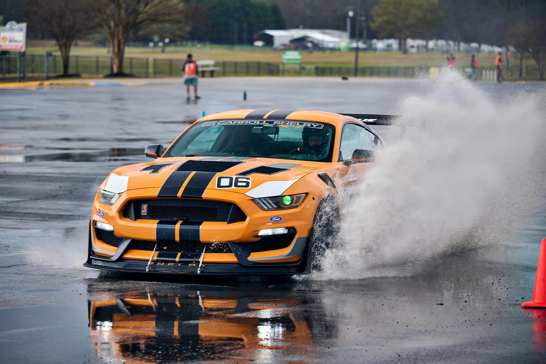

RE71RS 305/30-19. Even with the moisture they were still picking up heat per run. The issue we faced is that the start was a 90 degree turn and then another gate sending you back left and it was all on smooth blacktop. Its practically ice when its wet and even the awd cars were spinning tires on it.
On the older asphalt there was actually a shocking amount of grip.
