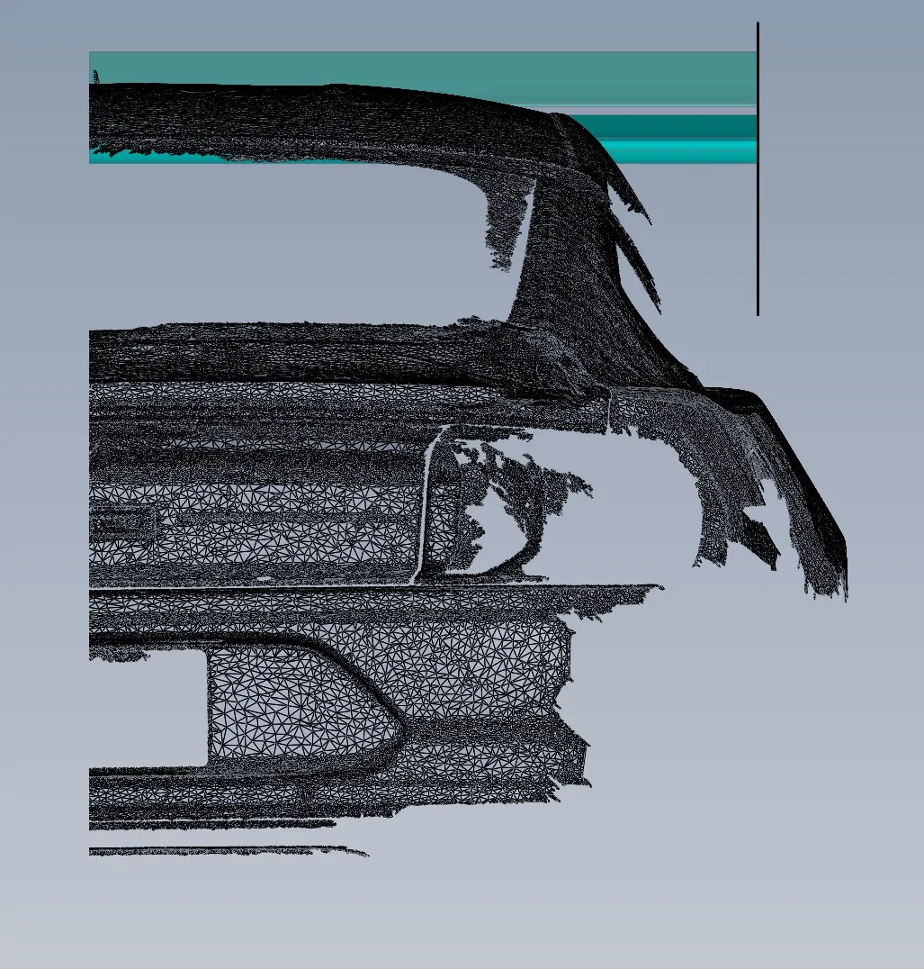

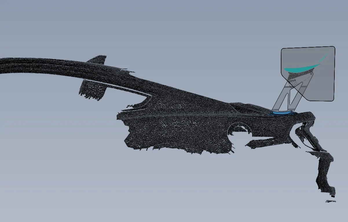

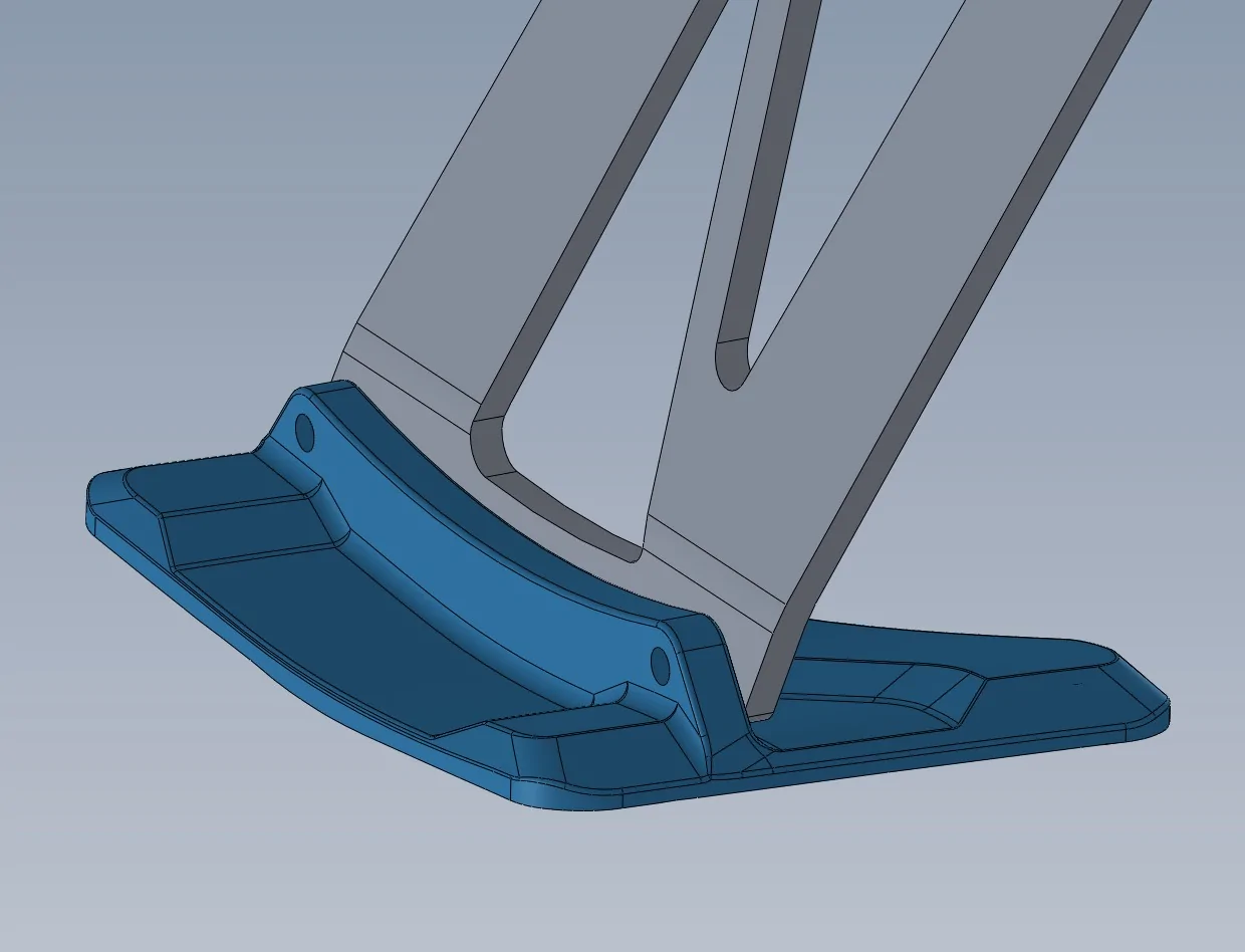

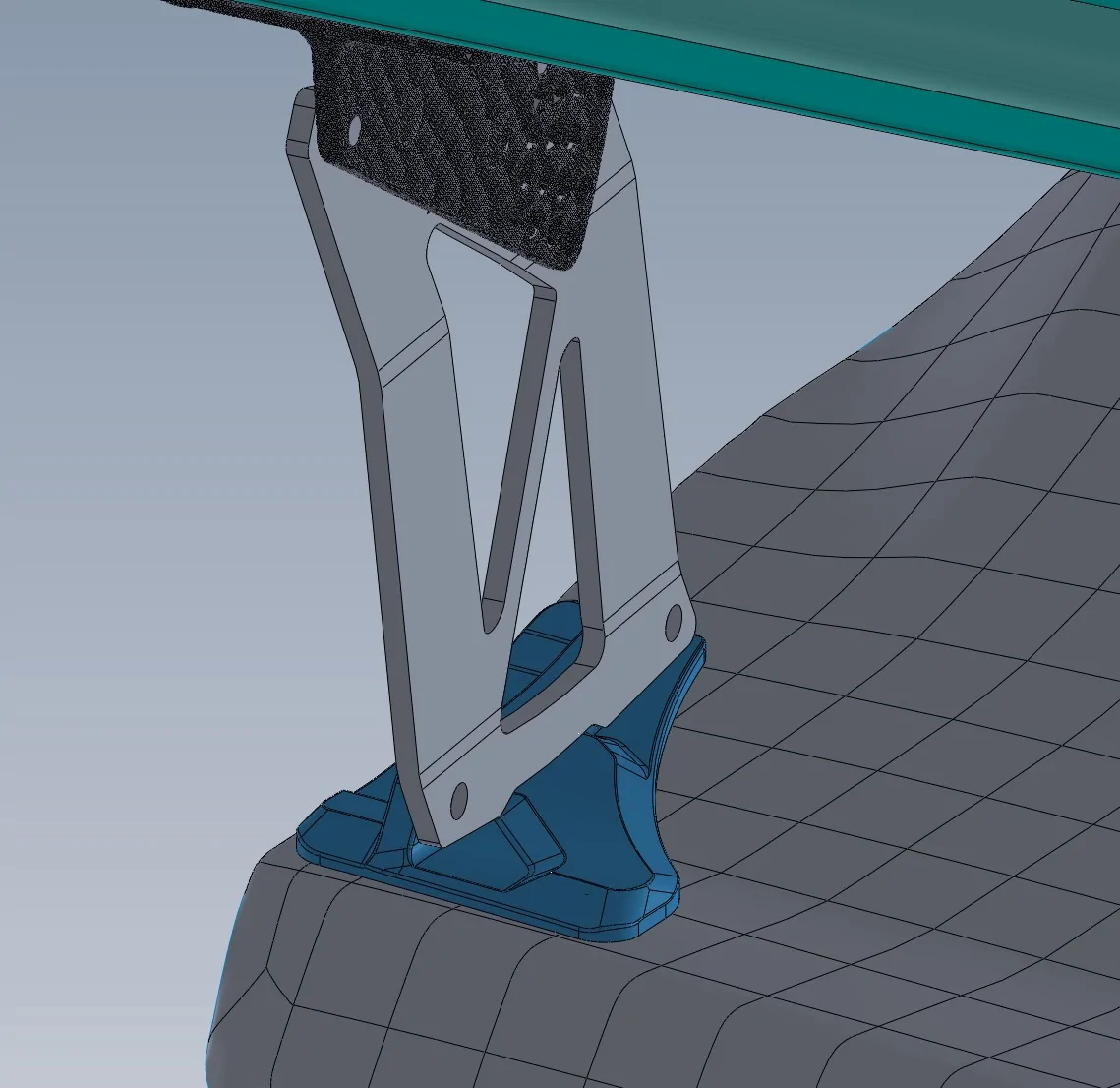

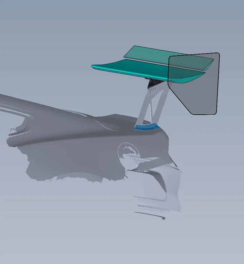

Spent today working on the wing mount design to re-use the Ciro wing from my Evo. I kinda guessed on placement, but its slightly forward of the furthest rearward bumper point, and top of 2nd element is 1.5in above roofline. Its roughly similar to how it sits on the Evo and didn't see much benefit of going higher or further back. Moving it forward may actually be beneficial depending on front aero balance.
I made the mount base a bit wider than the wings mount because it lines up with the trunk better and I can make a joggle in the upright which should add lateral stiffness. Its a little trickier to make than just a flat water jet part, but should be NBD.

I mean, GTD wing mounts or go home at this point :)
I’ve seen a bent trunk from a mount in that location. You basically bolt to a single thickness skin on the corners there so it can deform at high speed. Go racing in mexico and dented deck.
Dallas J
Sep 18, 2014
139
90
Oregon
www.ssb-designs.com
Dallas
2020 Mustang, 2006 Evo, 2019 F150
This outer edge here sandwiches the full thickness of inner/outer edge. Same edge the GT350 wing mounts to. I could see it being an issue if it was just the outer skin, but the lip is pretty stout. Def feels stronger than the Evo trunk which holds up great.
NightmareMoon
Nov 22, 2015
7,178
6,470
Austin
2016 Mustang GT PP w/ Voodoo
I’m just sayin, I’ve seen it take a dent there. Your large plates will help, no doubt. Outside of a high speed track, you’ll be fine.
Dallas J
Sep 18, 2014
139
90
Oregon
www.ssb-designs.com
Dallas
Oh yeah, this aint a full track worthy mount especially considering the wing. Up to 100, not too worried, but I wouldn't take it to PIR with the 140-150mph front/back straight. Any wing this big would need a chassis mount to survive that.
