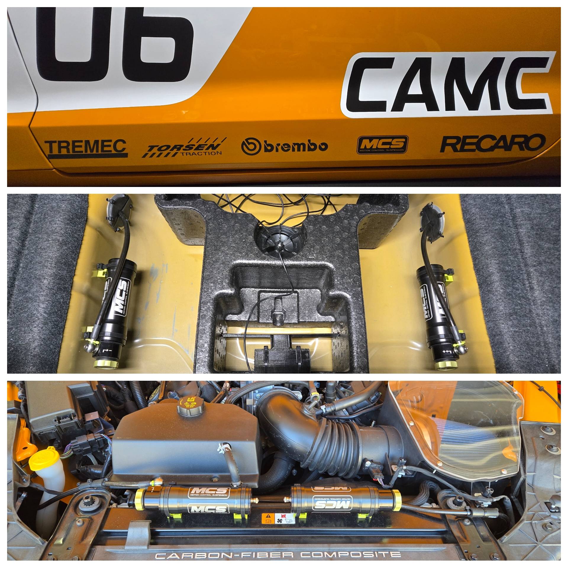

Suspension is all in the car and alignment completed. Was hoping to shake down the new setup this weekend, but with severe thunderstorms all weekend we're going to have to wait a bit longer it appears. Drove the car back home about 40 minutes through traffic and noticed the passenger side front reservoir was a bit warmer than the driver's side. Thinking it's getting a little extra cooked by the coolant reservoir bottle.

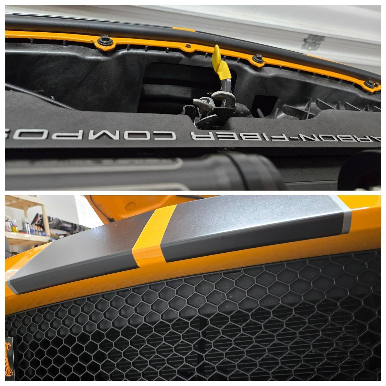

Considering cutting a small slot in the front upper grill area to let air up through the hood latch area just to promote some airflow over them and I figure I've got enough hood venting to not worry about it affecting me too negatively. Although if anyone has any tips for insulation/heat reflection products for the reservoirs, i'm open ears.
