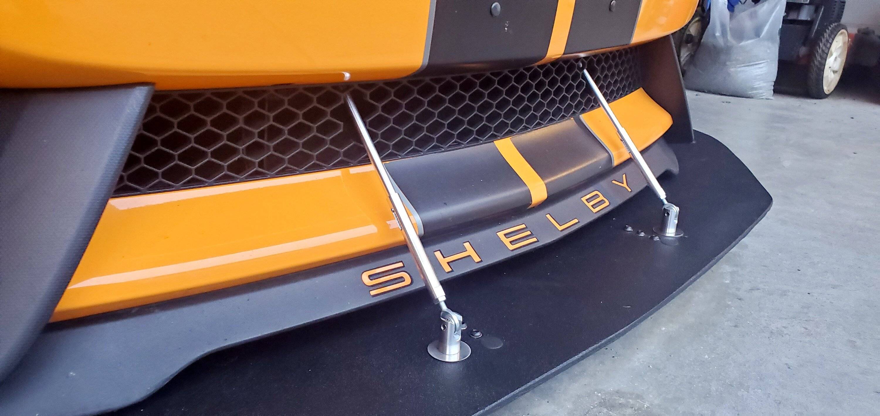

The issue is the back of the splitter, immediately in front of the wheels. AJ splitter rods are slick though, I wish they were available when I bought mine since my splitter pucks still touch. Luckily those titanium pucks wear so well, it's a non-issue.

I have the sort of mid-pack version of AJ's splitter rods. They're the spring loaded ones, but not the ones with the lockout for travel. They still work great though.
The only downside to them is that my splitter wasn't designed with them in mind so it's hard for me to get the angle of attack I want with them as I need to push the nose of my splitter down a bit and with the spring loaded section I can't do that. I have to basically get it close to where I want it and then let airflow "pull" the splitter to the appropriate angle at speed. I am losing out on some downforce at lower speeds for sure due to this which isn't great for autocross but I just need to re-design the mounting system. It needs a post-season re-fresh anyway.

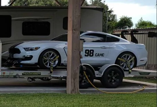

These are my trailer tie down points using he FP chassis tie downs. front straps live under the splitter. You do need a pretty forward set of tie downs, maybe at least 2ft in front of the nose/splitter.
[/url]
