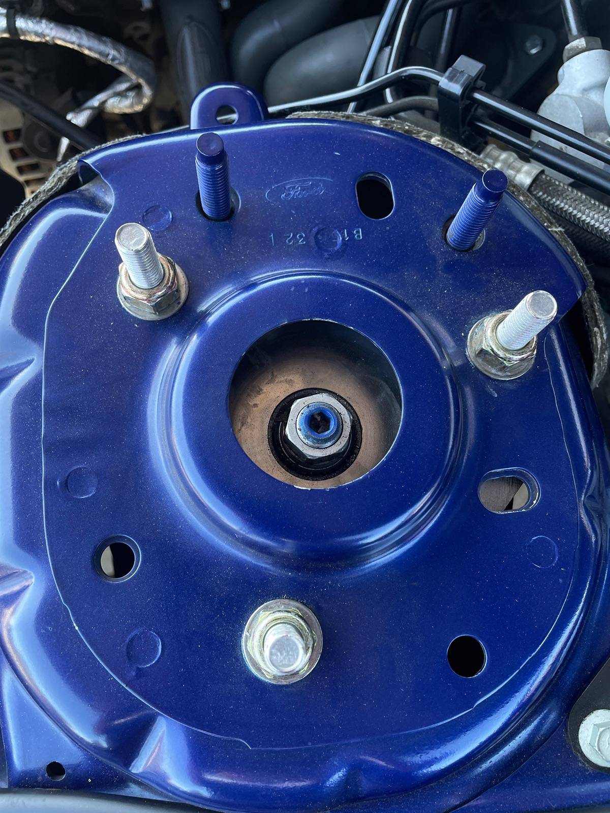

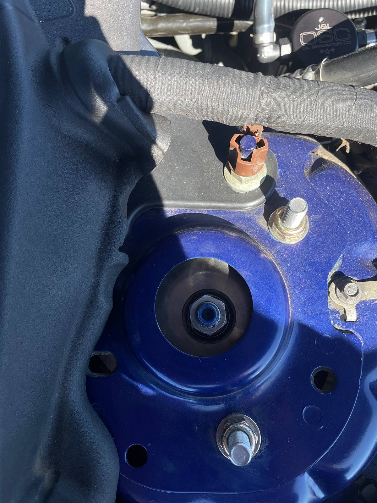

Look at the strut top, from above. It might be maxxed in the sense that it will hit because the strut hole has not been opened up.
drivers side
Passenger side

That's where I'd expect it to be. I think you need to find a better shop, or loosen the bolts yourself, max out the camber, then tighten up and have someone adjust toe. Front and rear, especially if you have a lift.

What are your thoughts on the bolt areas? From the pic it looks like there might have been a little drilling in the bolt hole, but I don't know for sure and will have to take it apart or ask the performance shop I am traveling to tomorrow.
The original aligners couldn't have hurt anything correct?
I tend to be a bit of a worry wart as this build is my baby.

He likely slotted the strut hole because this is what Ford's manual says to do for camber adjustment. Don't take these bolts apart because you're going to mess up alignment (not much probably).
Your plates have some room for more negative camber. Probably at least a degree. For reference, with maxed out Steeda plates I have -3.5 front camber.

My list of mods are in my box below, I should be able to hit the -2.8 easily right?

The mods in your sig don't really have anything to do with alignment but yes - -2.8 with Steeda Plates should be doable. However - as TeeLew pointed out - you sort of wasted money on that alignment you just had done.
