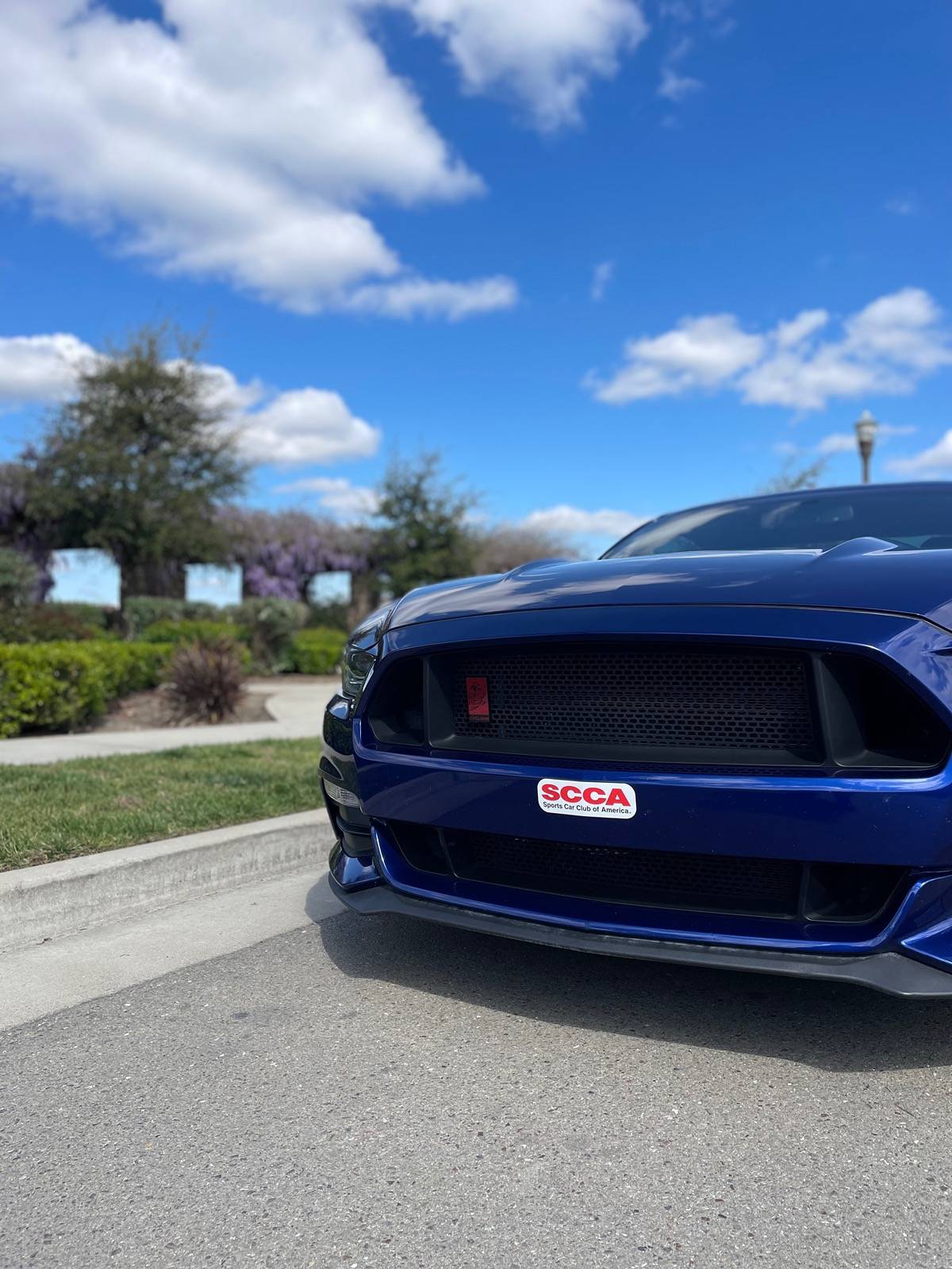

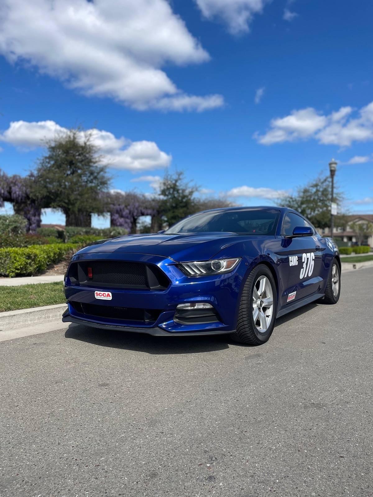

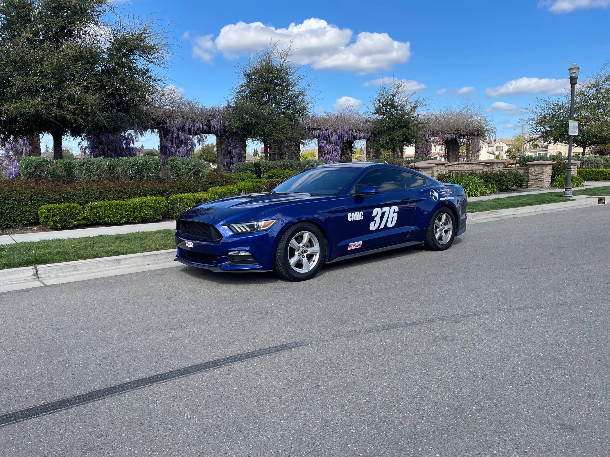

Just a little pic dump after a good clean. Just bought tires for the 19x11s so can’t wait to share with all you amazing people who have helped us get her this far!
