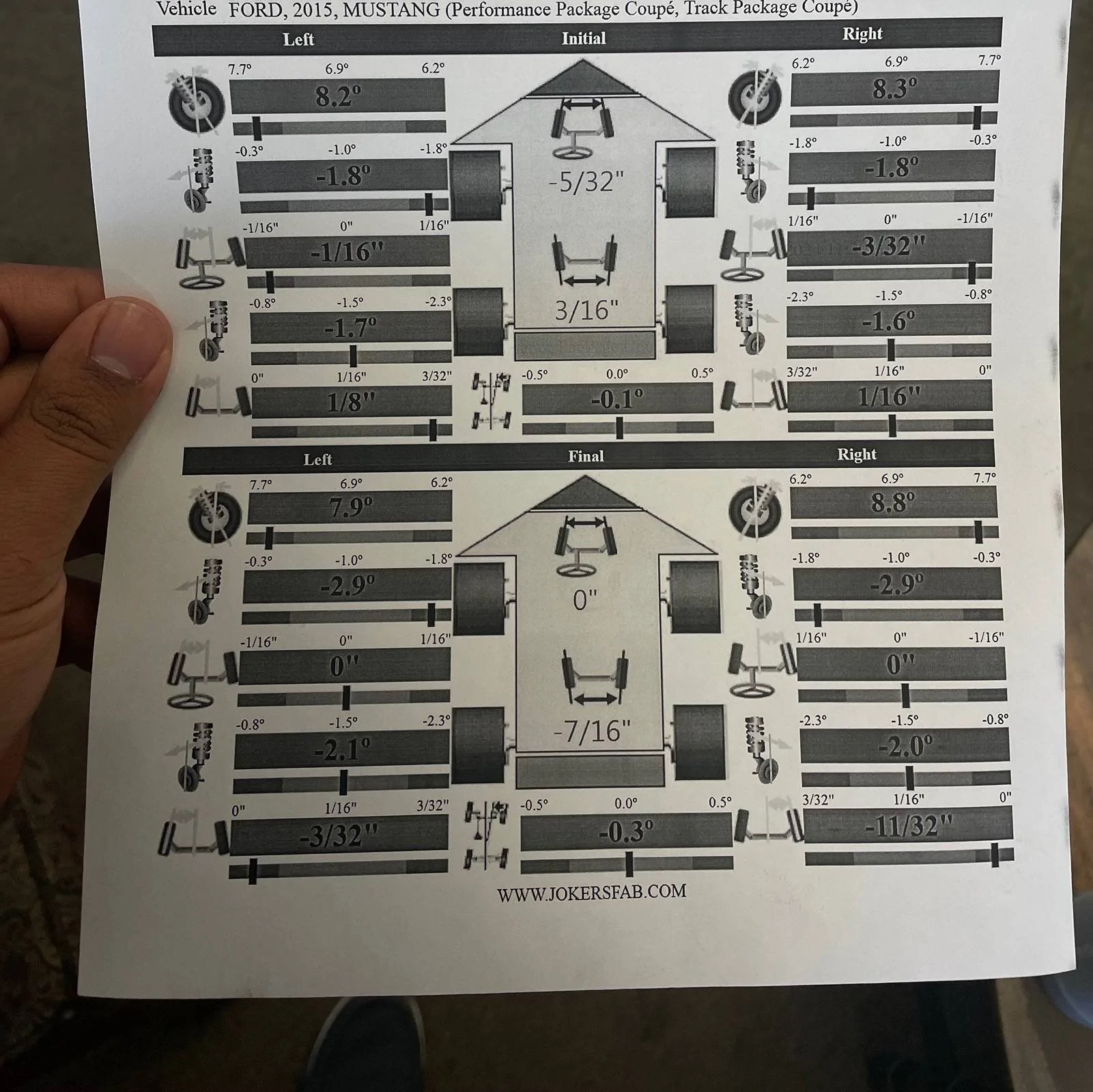

Much better. Now delete the contact info from that first shop and never go back there again.
Yessir. This is why I do literally everything else myself. If I had time/cared enough to do my own alignments and mount tires I would.
