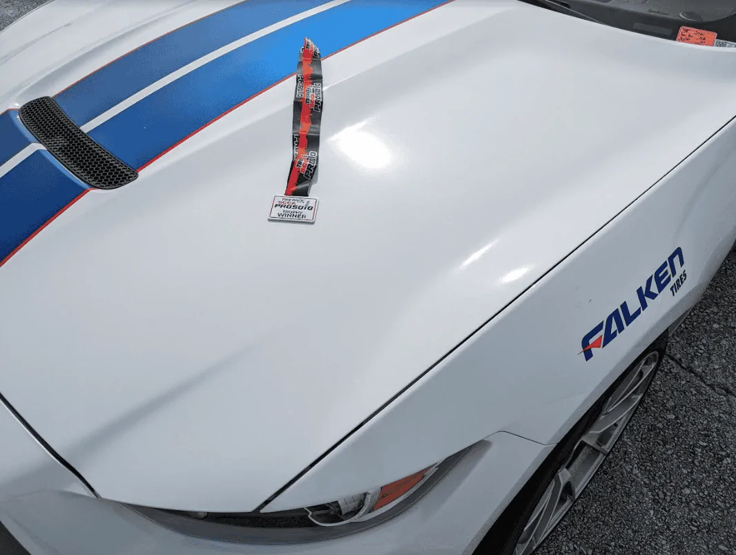

We had the National Pro Solo this weekend in Beeville. All I can say is "stop the hop" kit my ass. I will be removing all the Steeda stop the hop kit from my car and going to anyone else.
Nothing like dropping from 1st to 4th because the car went into limp home mode. I made it back up to second Sunday, but man, absolute frustration when what ended up being the best session for power and grip turned into a mess of no power, no suspension, TC on....

I was looking at the results during the weekend - congrats ! Very nice job especially the competition was good (and index isn't IMO too favorable compared to CAM T).
I was in DFW right before this weekend and completely didn't think about but technically could come down and beg someone for a ride (especially that one local person from here was there with their car)
What was the limp mode caused by ? Was it Service Advancetrac ?
And why are you getting rid of stop the hop ?

Thank you!
The morning session was cold, so I did a burnout to heat the rears up. No issues. For the afternoon session, the air was still cold, but the pavement heated up pretty good under the sun. I think there was a lot more grip in the burnout box, and my tires were not as cold. My tire pressure guy said I had a wild wheel hop, but it's odd because in the car, I felt nothing unexpected, and reviewing video, there is no shake in the camera.
The issue was forscan showed an erratic left rear wheel speed sensor code, consistent with wheel hop. I tried restarting the car in between runs, and no luck, the car wouldn't clear the code. I was able to get TC to turn off on my last run, and made up a second on that run, with the service advance trak, ABS, and steering fault codes flashing at me. What is annoying, in post tech jail, the car cleared the code, and everything was working again. I think the car needed at least 30 seconds to reset itself.
If this was a tour event, I could have quickly scanned and cleared codes and been fine. But the Solo format...just gotta make it work.
Steeda's kit doesn't "stop the hop" during a standard burnout, I need something that will. I'm confident I had 1st place but for losing out on the best session of the weekend due to the wheel hop. I am very thankful more stuff didn't break.

Also @WItoTX - even more impressive you did on Falkens in what is like a pretty cold event.

Agree with all of this. I have all the same stuff as you, I just assume it's all part of the stop the hop. Truth be told, I think the only solution is new subframe bushings, something much stiffer, and I think the 2 piece drive shaft might be an issue. Fletcher here locally said power delivery became much smoother going to a 1 piece.
I haven't had this issue until this event. Since most say Beeville is similar to Lincoln in grip, I will just expect similar issues.
My Falkens had 4 runs on them prior to this event. Neuville had Nankangs in a similar scrub in condition, and so his cold temp grip was only going to be worse.
The CAMS PAX is pretty brutal this year. Glad to see CAMC is less brutal. Also, the Pro Solo is my favorite format by far. Love the tree start.
