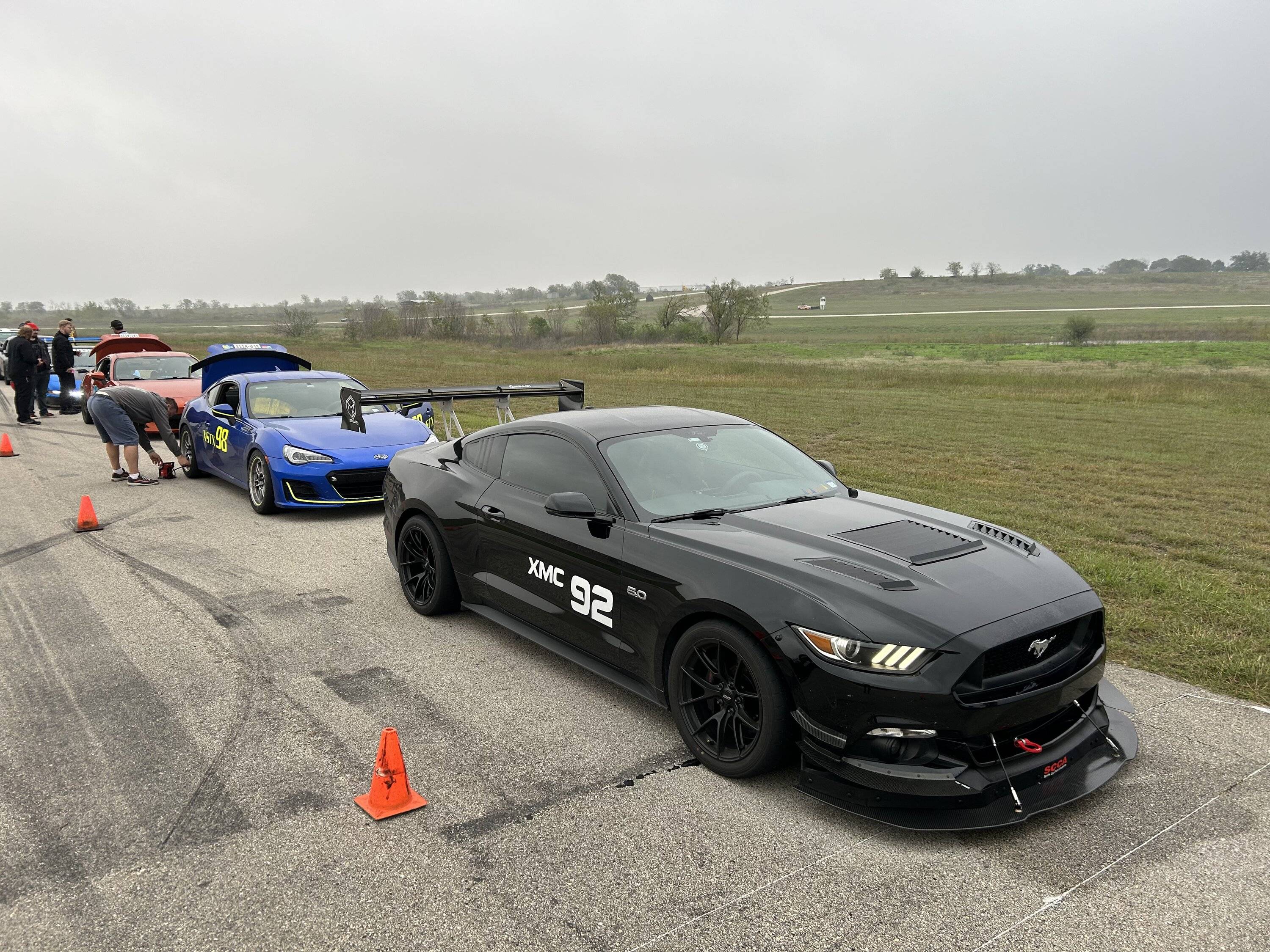

Local autox club rented a nearby road course and did a “Track Sprint” event today. Autocross stsrt and finish on a road course, and no extra cones. Basically a short (~70 sec) point to point time trial. Basically if you custom designed an event for my car, this would be it. Cool and damp conditions were quite acceptable for the Yokohama tire..
Pretty fun. CAM aero really helps at track speeds. I was 2nd fastest raw time after a decently fast high horsepower time trial Supra. I won top “pax” which means nothing because this was /not/ an autocross. Rain late in the event effectively neutralized all of the fast R tire cars in the 3rd heat.
Somehow I dont feel the slightest bit guilty.
