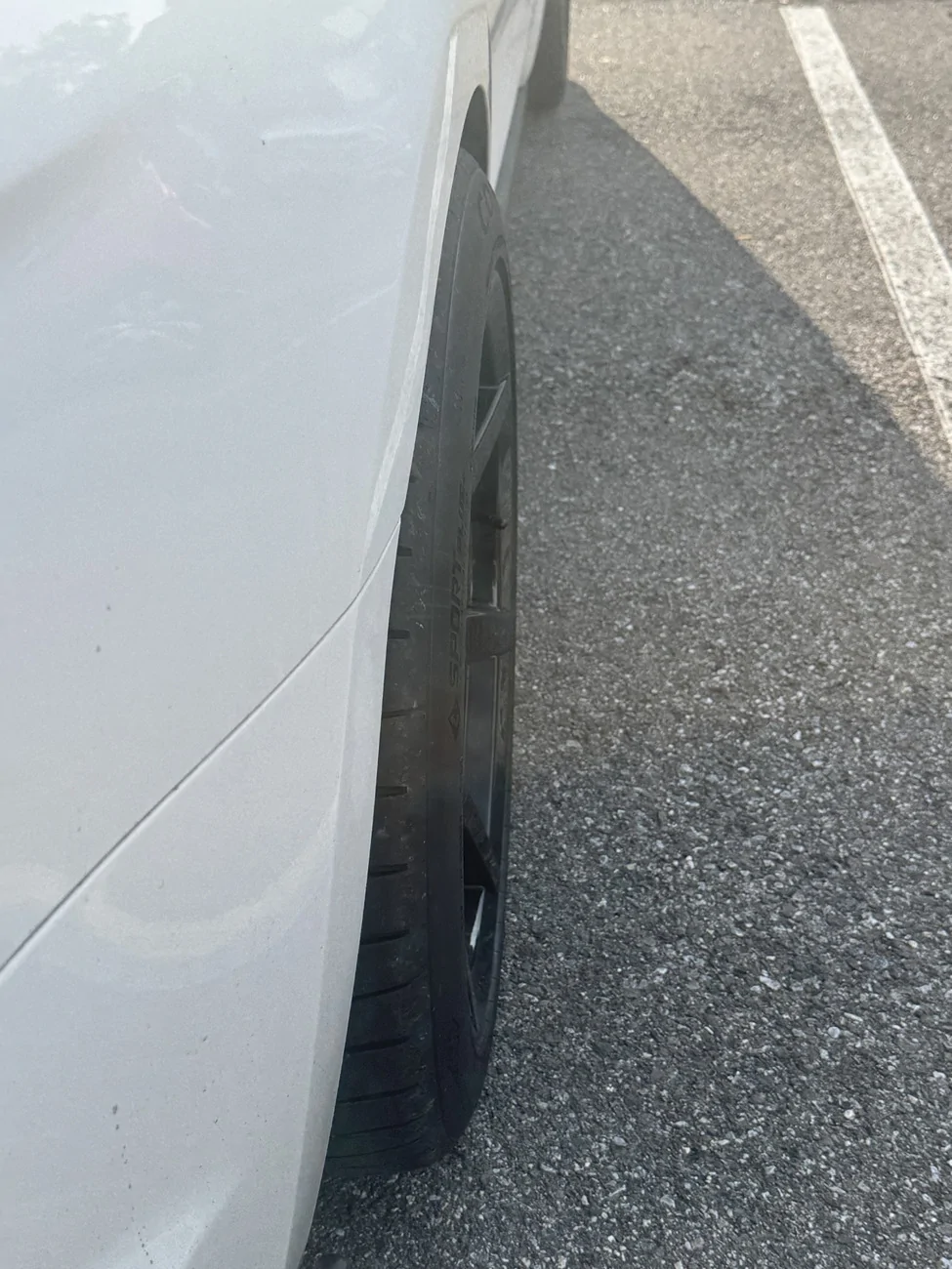

I took my car to firestone two weeks ago to get my alignment done. After picking up the car I noticed that my rear passenger tire was sticking out(no camber at all/ positive camber).
I returned to the same place an told them that I rear tire wasn't sticking out before. They told me they would fix it but then after an hour they said there was nothing the could do.
Today I went to another firestone and after an hour they told me my car does not have camber adjustment in the rear.
My car is a 2017 Mustang GT Performance Package with lowering springs. Before doing the first alignment both my rear tires were tucked in and now I have one sticking out. The refused to give me a printout the three times with excuses.

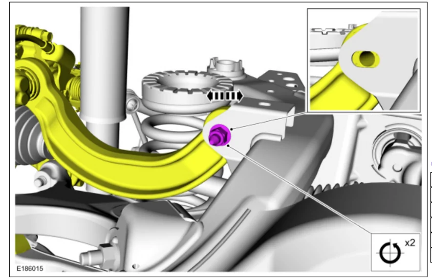

Yes, they're bullshitting you.
Camber arm slides (in a "horizontal" direction) on its inboard joint and it is kind of pain in the ass to adjust (toe changes with camber) but they just don't know how to do it despite manual showing it pretty clearly.

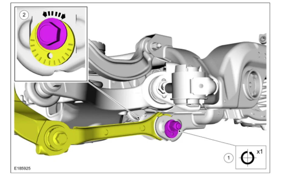

Lifetime alignment, they really dont want to work hard for it and doing the rear is annoying, but yes theres absolutely camber adjustment there. Toe and camber crosstalk in the rear so they changed your rear toe and thats why the camber was different afterwards.

Print these out, show them to the guy doing the alignment, and point out that adjusting either one affects the other, so it might require going back and forth to get them both where you want them.

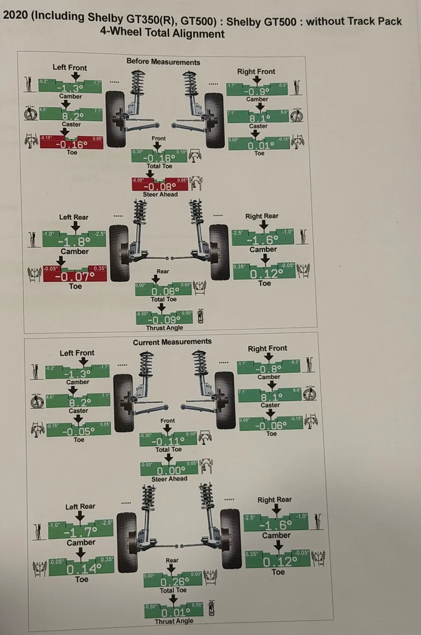

I just put new tires (and had them aligned) on my 2020 GT500 yesterday. Did you get a report similar to this?
