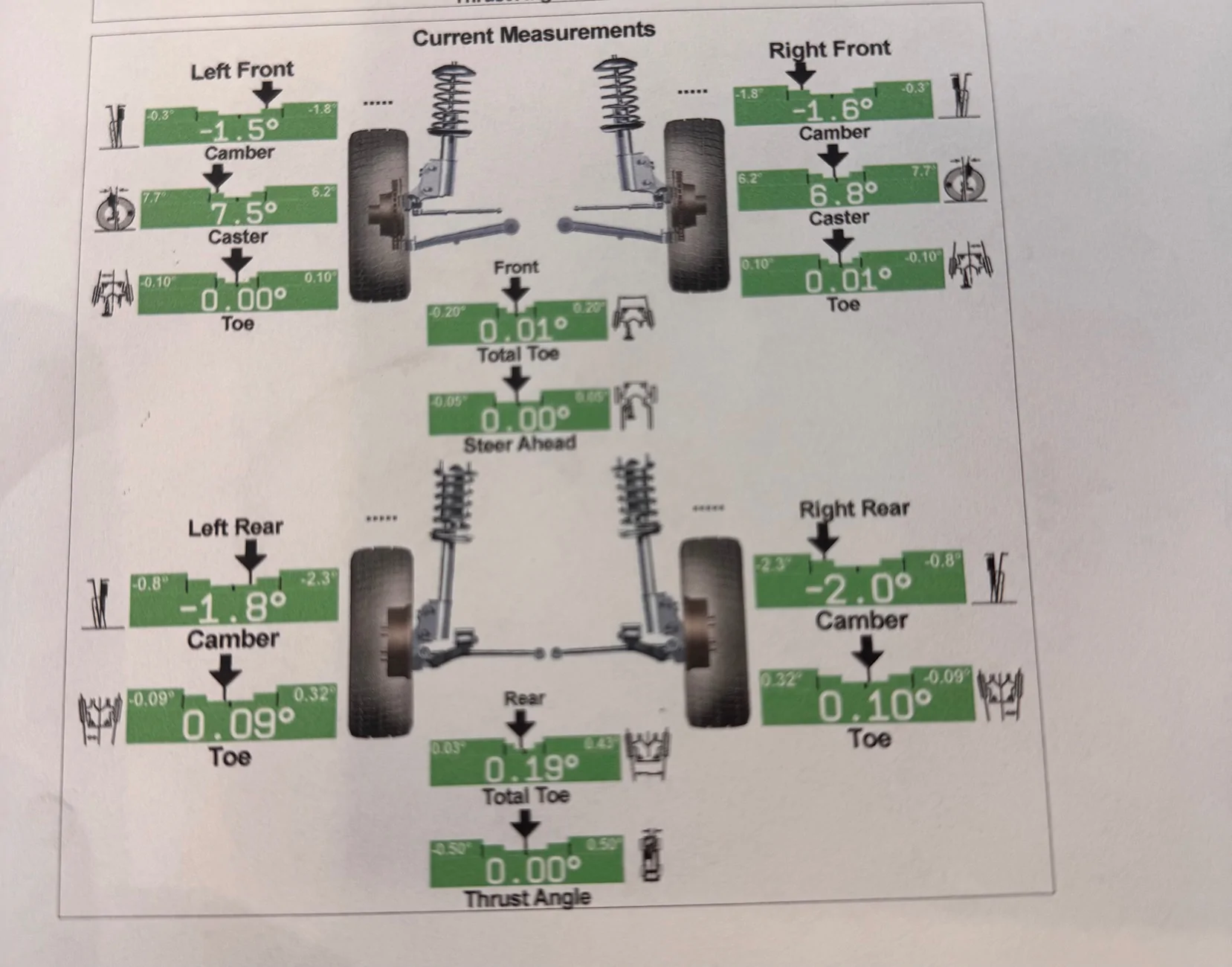

This is intersting because I was at discount tire yesterday and the person doing my alignment after new tires said he couldn’t adjust the rear camber, so Ill have that conversation but he also said we can’t adjust caster? Is that true or not. I was looking for front camber at -1.1 to -1.2 front and -1.3 rear.
Here’s my alignment, to be honest I’m not too worried about it, I was more interested in getting toe to my specs which they are. I don’t track at all, mountain roads for me. I do have camber bolts and they couldn’t tell me if they were maxed or not. Here is the final alignment. I can go back it’s a good crew there.
RedStallion27
Jun 2, 2026
IL
2016 GT
Is it okay for caster to be 0.7 different from side to side?
