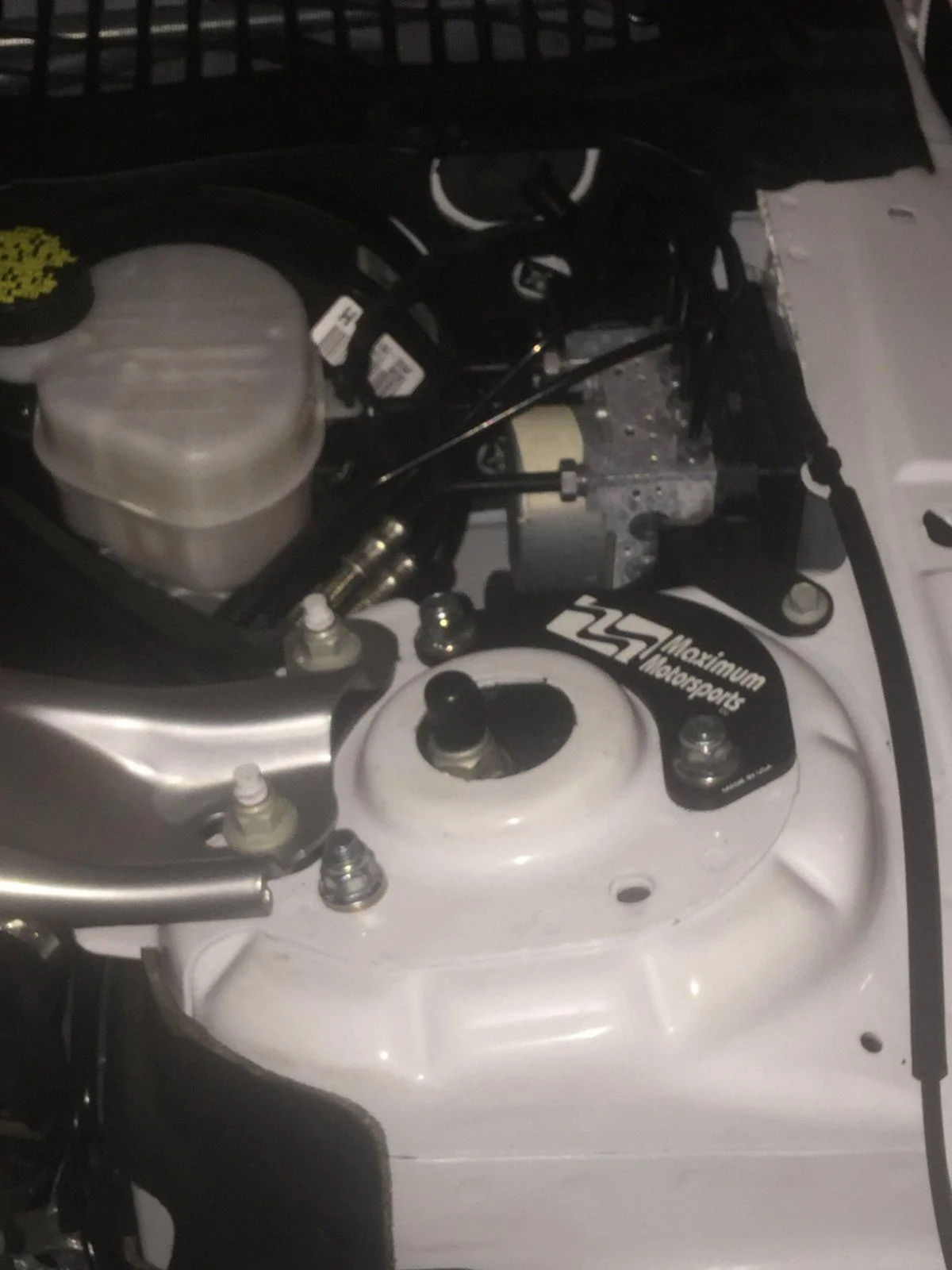

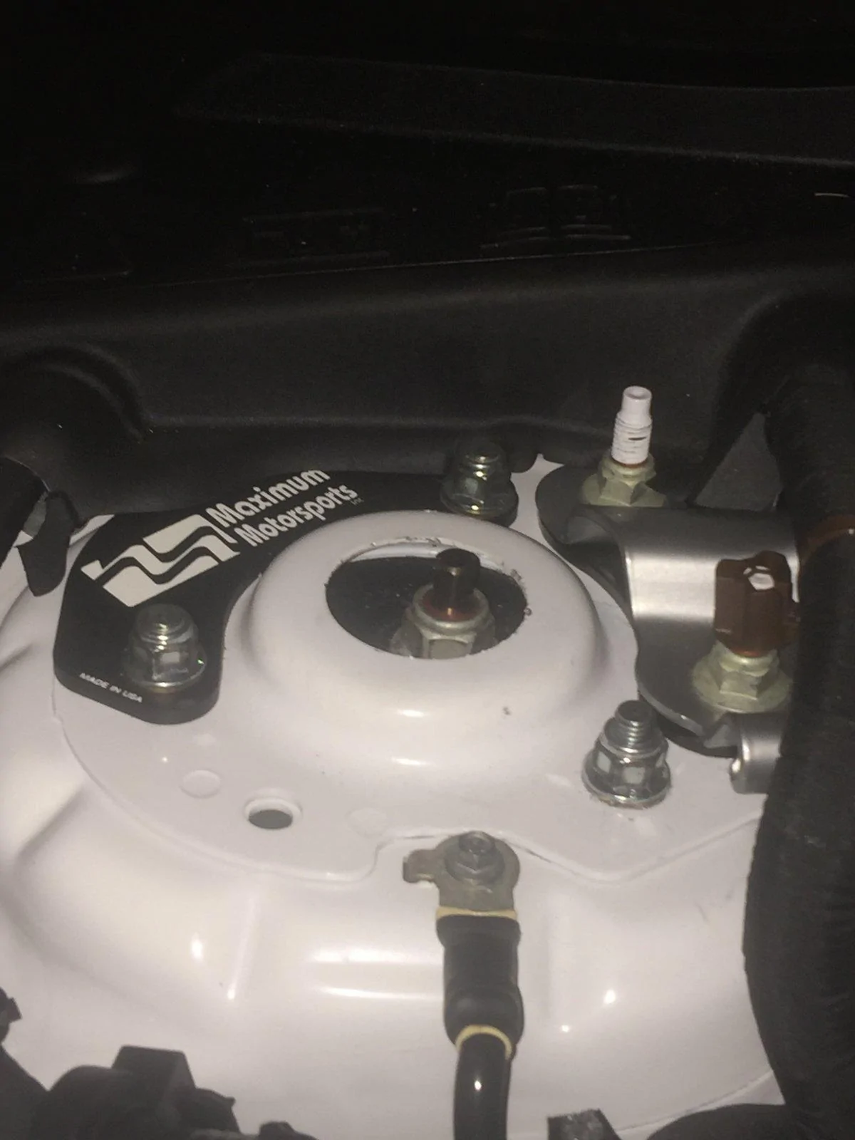

Man, I appreciate the feedback. Sometimes a sounding board works wonders.
Look at the pics. The alignment guys said one side could do up to 2.4 and the other 1.9. I have to assume the passenger side is the one that he was referring too being able to go to 2.4 while the drivers side looks maxed out.
Could this be some kind of assemble/install issue?
The reason I ask, if all things are within X tolerance then shouldn't they both be able to do either 1.9 or 2.4? Not one at 2.4 and the other at 1.9? Does that make sense? To me something seems to be wrong with the drivers side.
Drivers side
Passenger side

I have the same camber plates and was at -2.6 on both sides after installing it. That was just me eyeballing things with a small level. They could have gone much more negative than that. After alignment, I had the shop set at -2.0 in front and around -1.8 in back.

Are you sure the shop installed correctly? I don't think you could really tell without dropping the strut out again. With mine looking like the top of yours, I am guessing I would have been close to -3.
That's more in line with what I expect. Do you have pictures of where the strut bolts were in conjunction to the strut tower?

The MM camber plates should only be mounted on the correct side with the correct orientation. They aren't universal, and if installed incorrectly, will not give you much adjustment.
If I can remember, I will take a pic of mine when I get home. At -2.0, I am just about 3/4 inch from the center.
