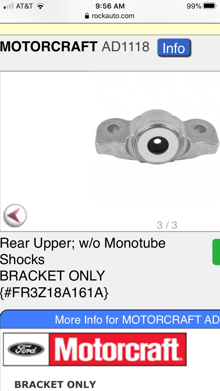

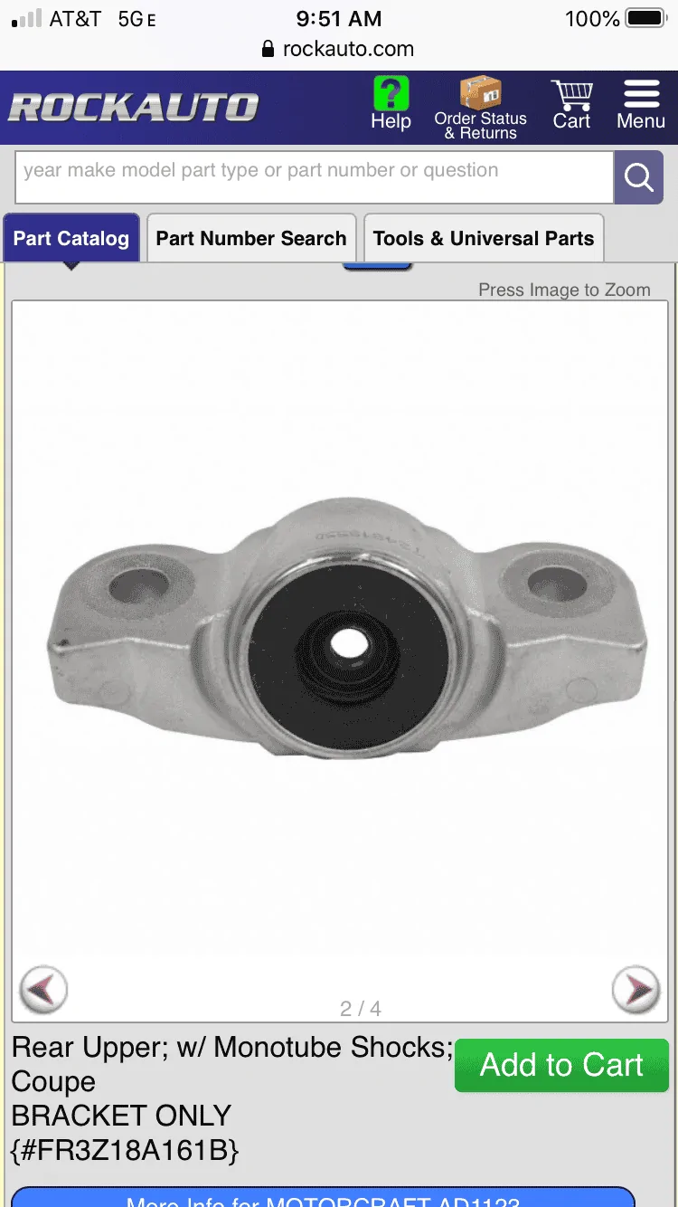

rockauto has two different part numbers listed for rear upper shock mounts. fr3z18a161a or b.
the b part number has a black top as opposed to the silver/aluminum top on the a part number which is on my car and probably most everyone else's. the b number is a little cheaper. does anyone know what the difference is between these two? is one better than the other?

The descriptions say one is for monotube shocks while the other is without monotube shocks.
Hm that's interesting, I'll take a look next time at the mounts that came with the FRPP Track shocks which are monotube (I think). Maybe a higher durometer insert in the mount?

The difference is whether stock monotube shocks are/are not used.

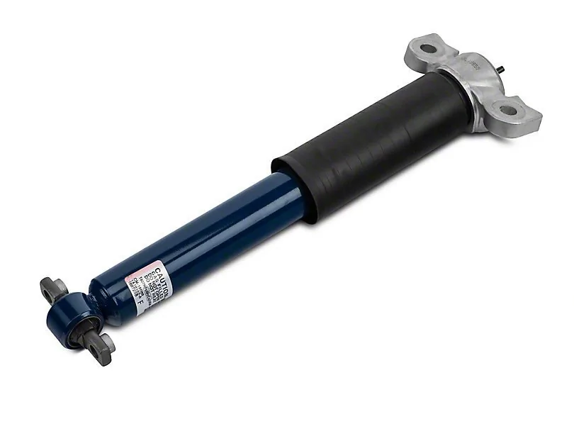

in retrospect it puzzled me why the ford racing rear dampers came with mounts as these were already present on the car and are very easy to install. it may be they are a higher spec mount. if anyone could confirm which mounts come on those dampers that would be helpful.
Yep, as soon as I can take a look at it I’ll report back.

found this pic of the fr damper. you can barely read it, but the numbers printed on the mount end in s550 same as the ad 1123 part number. ie its the one with the black top.
