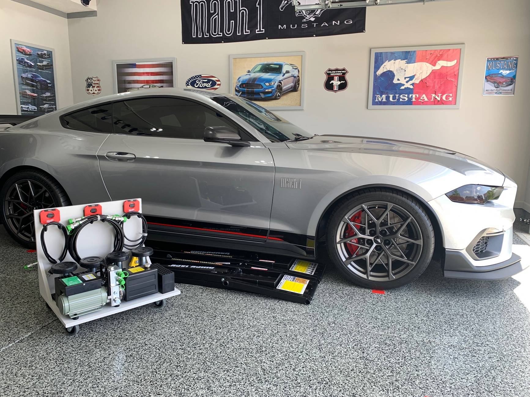

I bought the 7000TLX so I could use it with the Gladiator as well otherwise I may have bought the 5000TLX
Is that cart something you built?

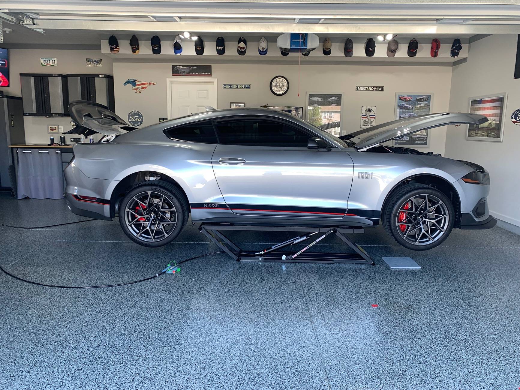

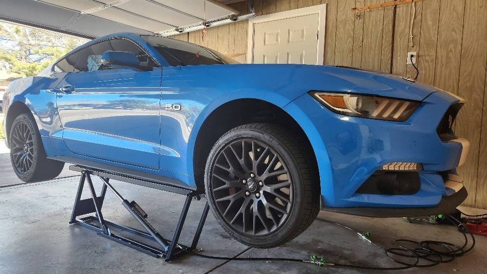

5000tl here, love mine. wish I would have gotten them sooner. However, be sure when you use them to place the hose connect end to the rear of the car. So when you lift the car will move forward as you lift. Due to the way the work the most weight is to the front. So don't place like post #2 but place like post #4. More support for the front, safer due to angle of the lift. If you look at post #4 you can see what I mean by the angles of the lift arms.
