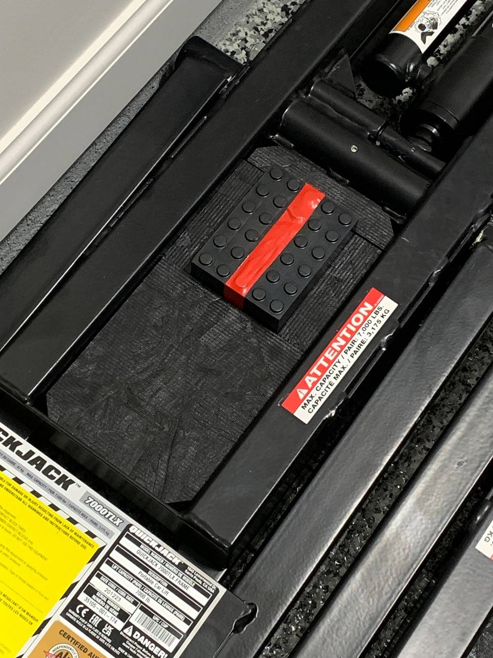

@kz It’s funny you mention using a jack as I had done that a few times before I cut the bottom of the standard pad down enough for it to clear the ZL1 lift pads. I also filled in the trays so the blocks were always in the same place and the red tape on the pad is used to line up with the ZL1 lift pads. Super quick and easy.

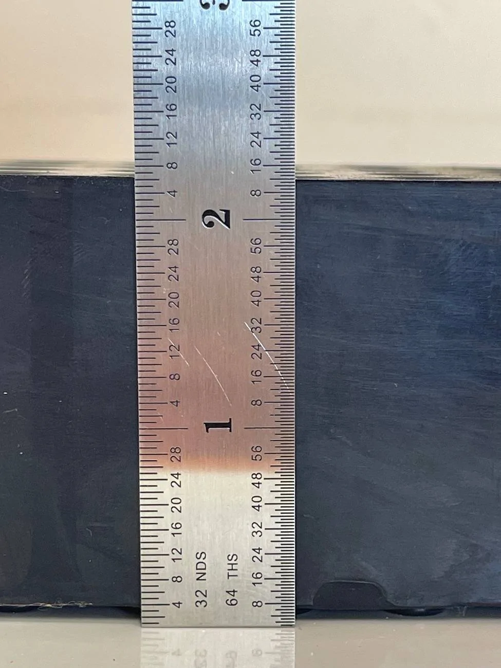

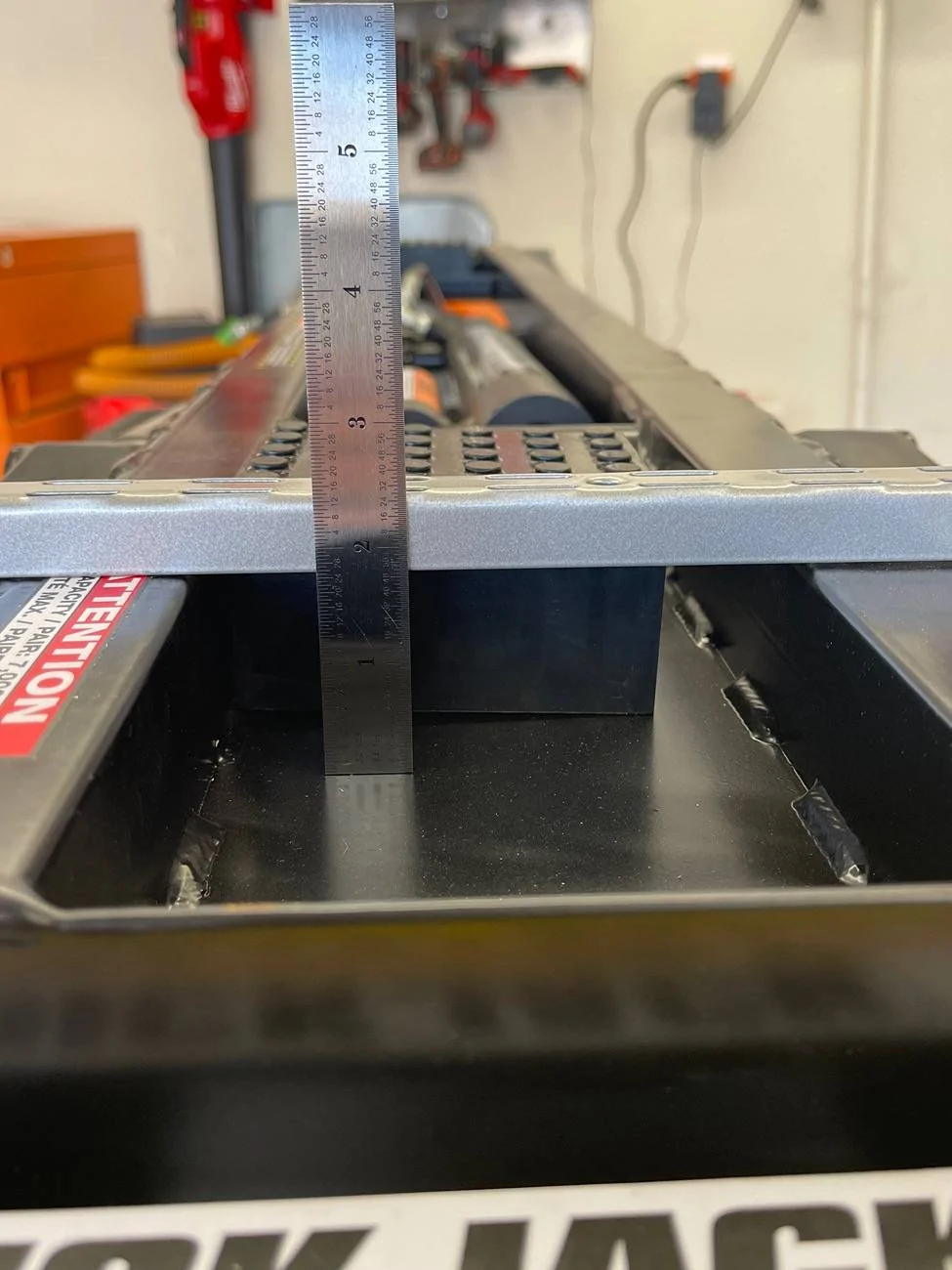

This is correct
7000 series tray is ~1.75” deep and standard short block is ~2.25” tall
So the cut down 1.5” blocks are definetly a no go. Damn.

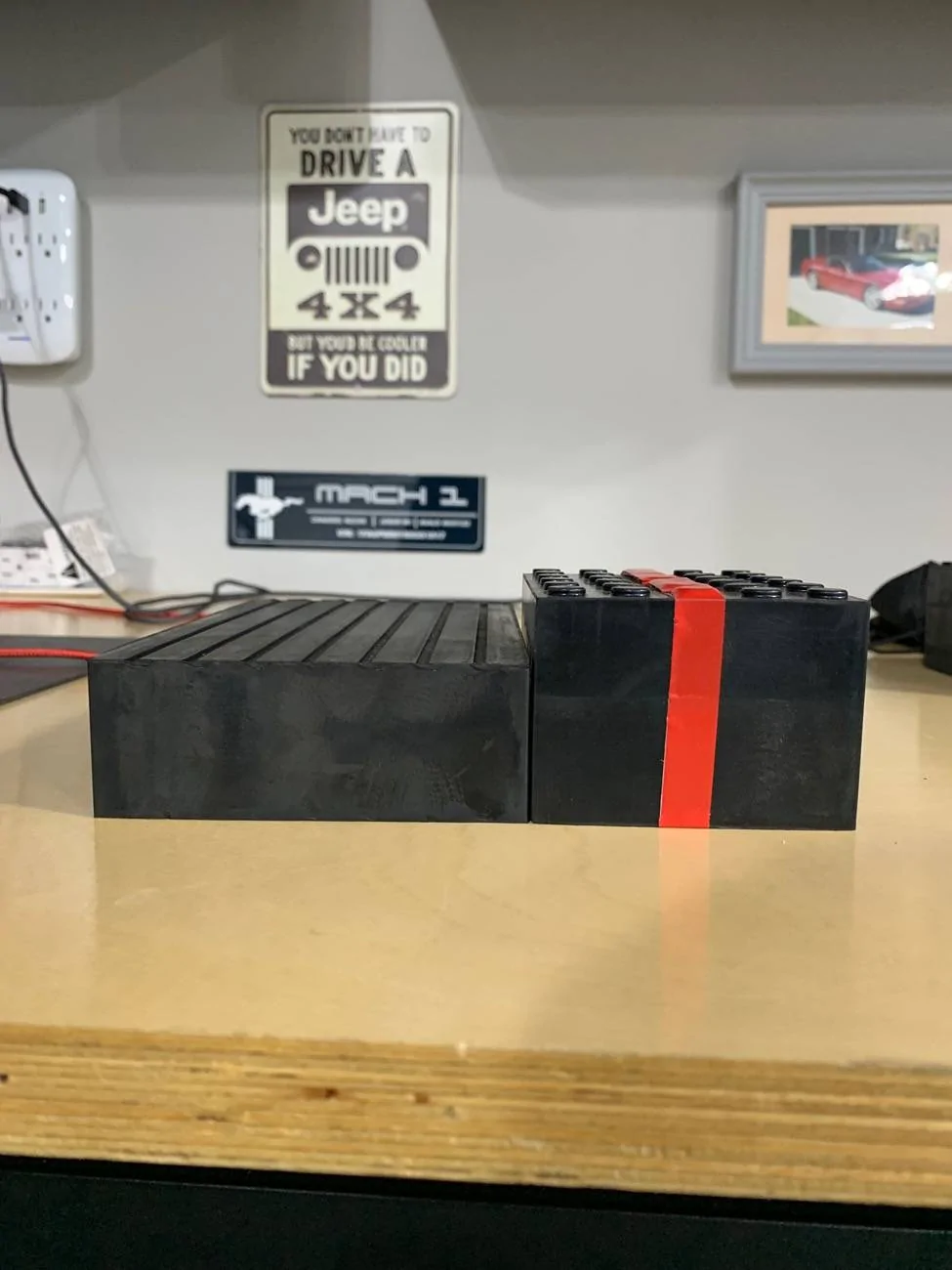

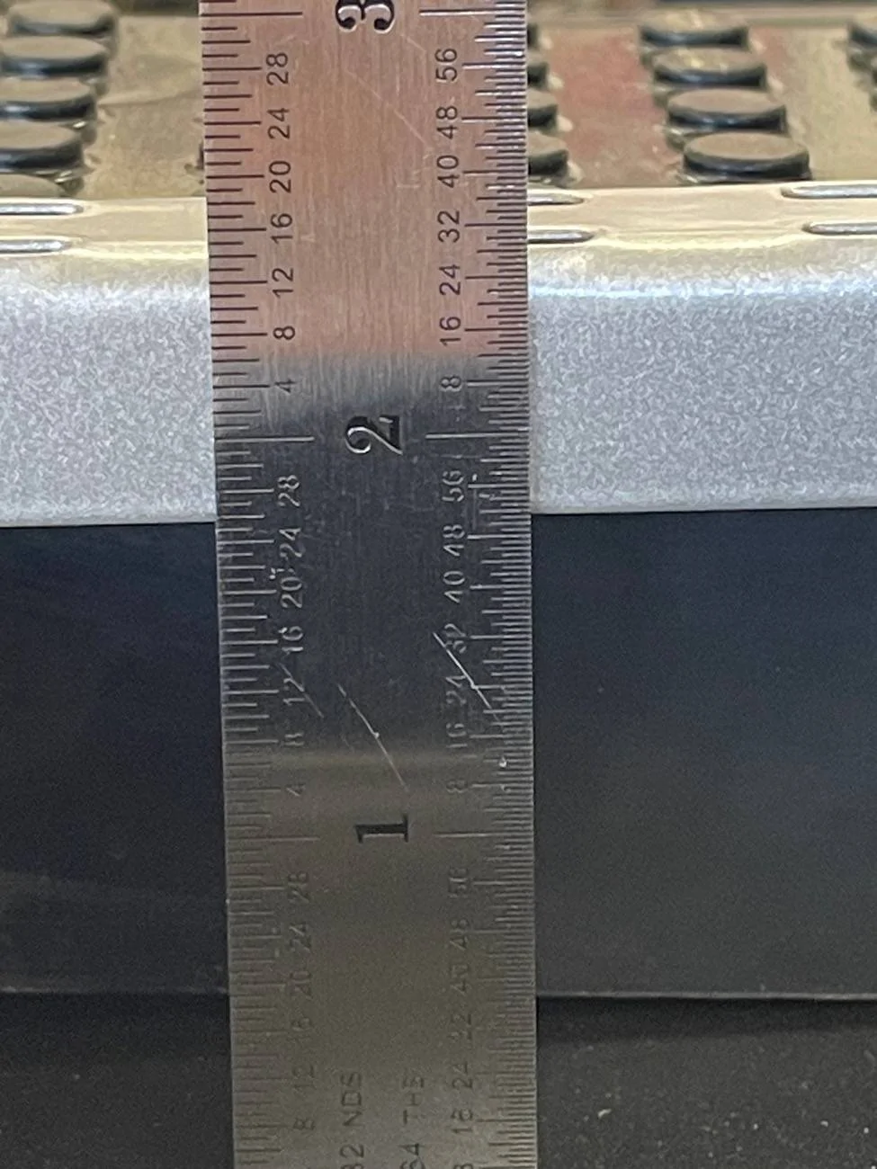

Correct but cut down the (bottom) standard low block to what height you need for it to fit under the car, that’s what I did. Now I don’t have to jack it up prior or drive up on a board, also I only did this on the front blocks as the rear has plenty of space. Picture referencing the difference in uncut block(s)

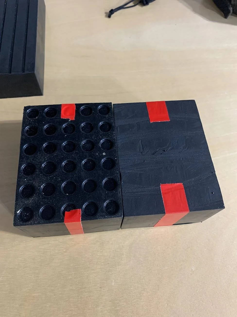

Bottom of standard low block, one uncut the other cut. I cut it down about 3/16" as that’s all I needed for clearance

Yeah I just have the clearance problem with the front as well. What did you cut the block with? Band saw?

I cut mine with just a knife (Milwaukee utility knife - very sharp).

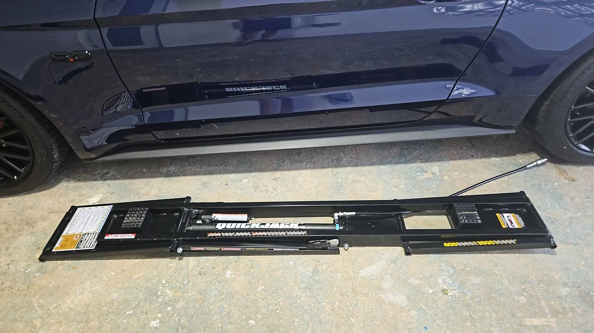

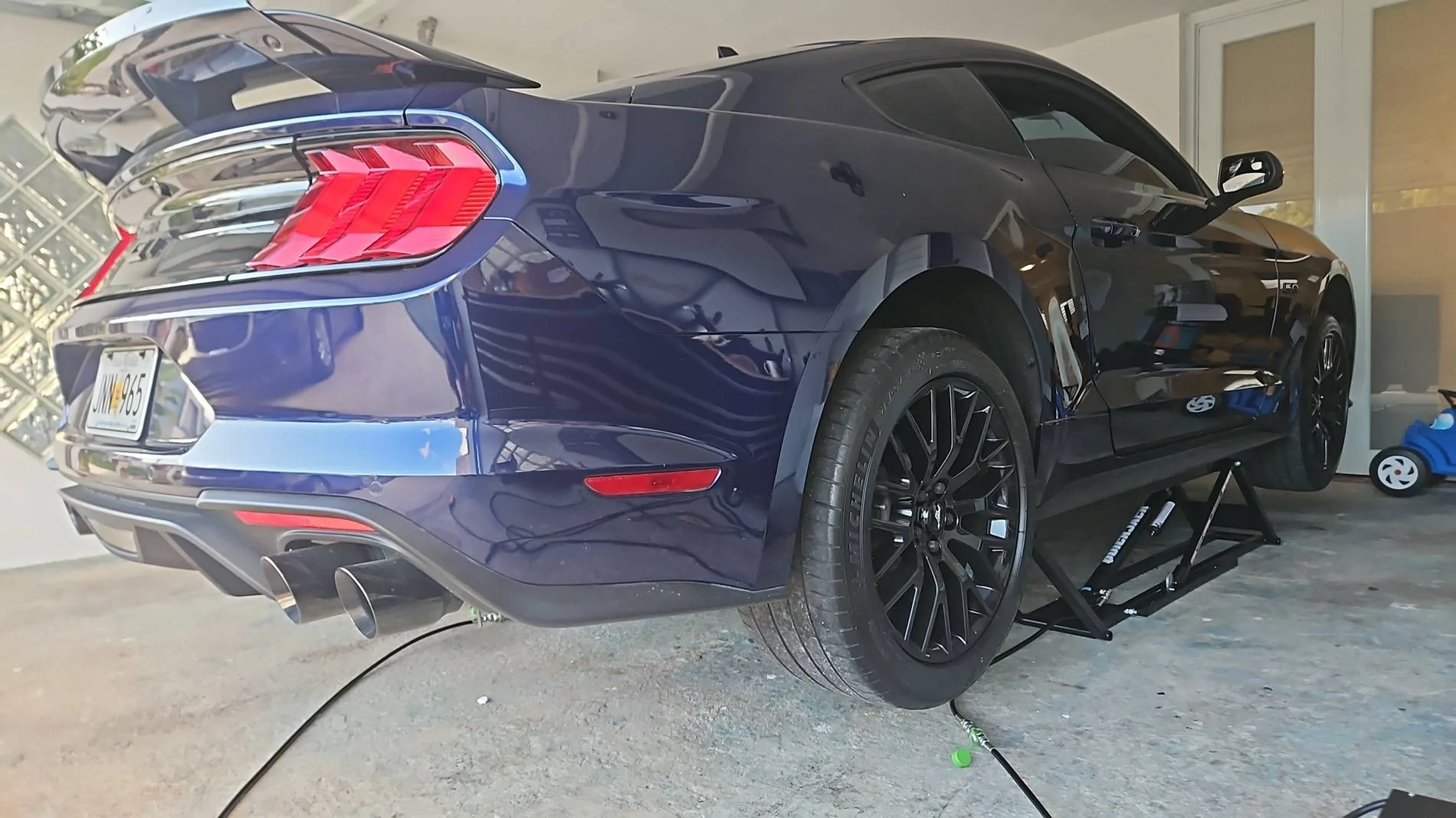

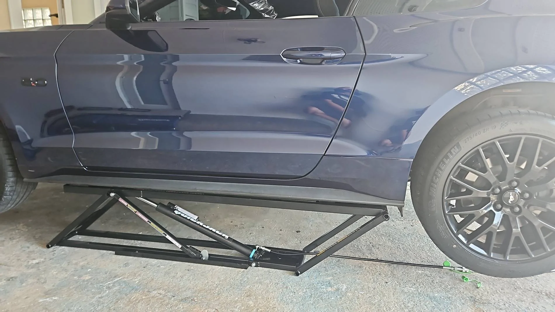

First time using it. So far so good.
