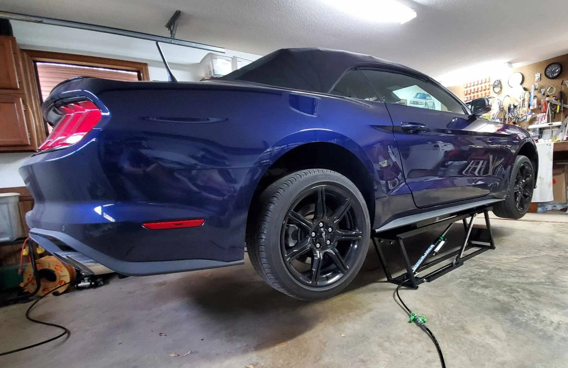

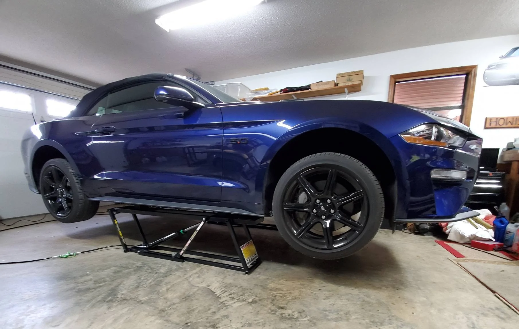

I've had mine over a year and love it......WORKS GREAT........save a LOT of time!! :thumbsup: 😁
