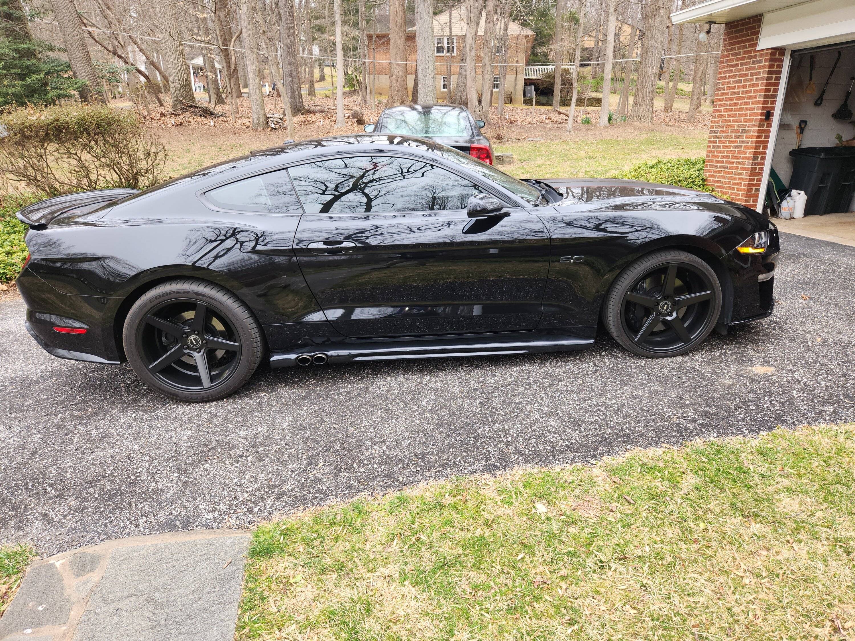

Hello, I have some questions for those who have the quick Jack. I am wondering if there is a specific size needed for an S550 or if there are multiple sizes that will work? I have a chance to get a 7000XL for a very good price so if there are multiple sizes, will there be a problem using the 7000XL on my S550? I also have side pipes with a fairing on the sides covering them, will they be an issue using it, or can I just move the jack in board a little to compensate? Thank you guys for any and all input.

So you can see what I am talking about.

How are they mounted to the car. and do you have jacking rails?

I do not have jacking rails. They are mounted to the car where the normal side skirts attach as well as a couple of small aluminum "L" brackets that add stability/rigidity to them that attach to the underside of the car, 2 per side and they are just sheet metal self tappers, Nothing too substantial.

I have the standard 5000 lb model and the Jack's rubber blocks ride on them keeping the weight off the Side skirts i guess if you can position a floor jack. Under it you should be able to put a Q J. Under it
