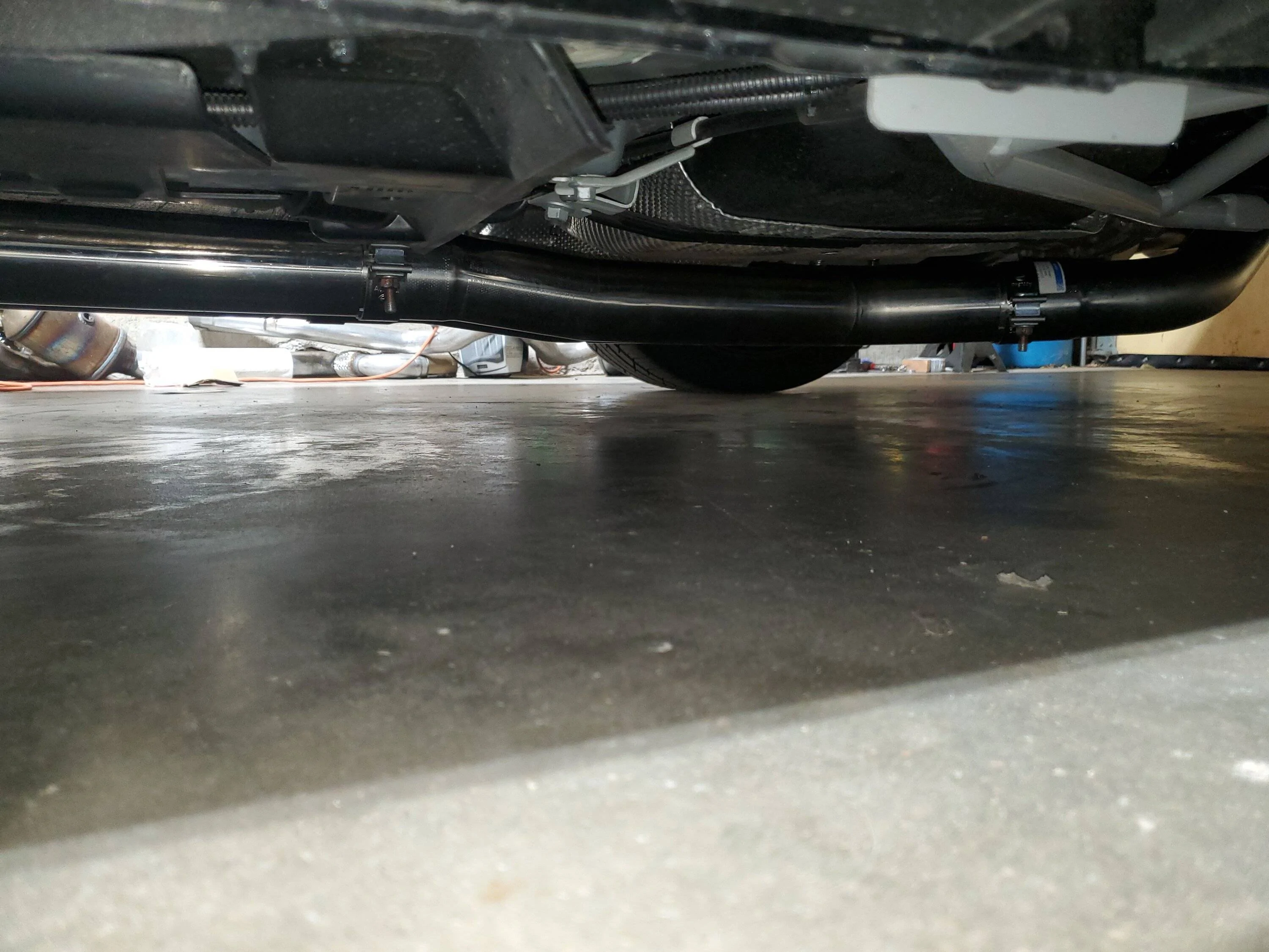

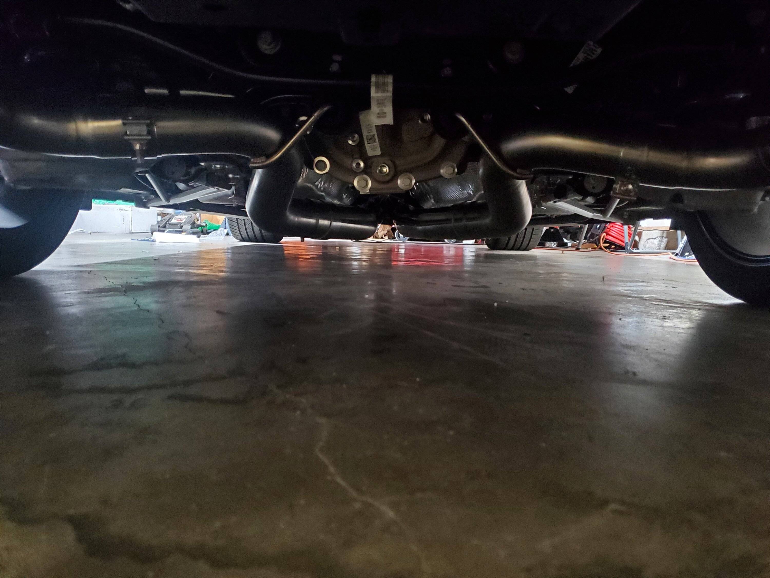

I tried pushing them up with the jack but it's as far as they go. The H pipe is nice & flush as well as the cat pipes. But past that they get lower. When I raise them with the jack, they hit the sub frame by the differential. As they stand now, they are about .25" from hitting the frame.
Could be angle, or just a little low but if it fits in the rear probably ok.

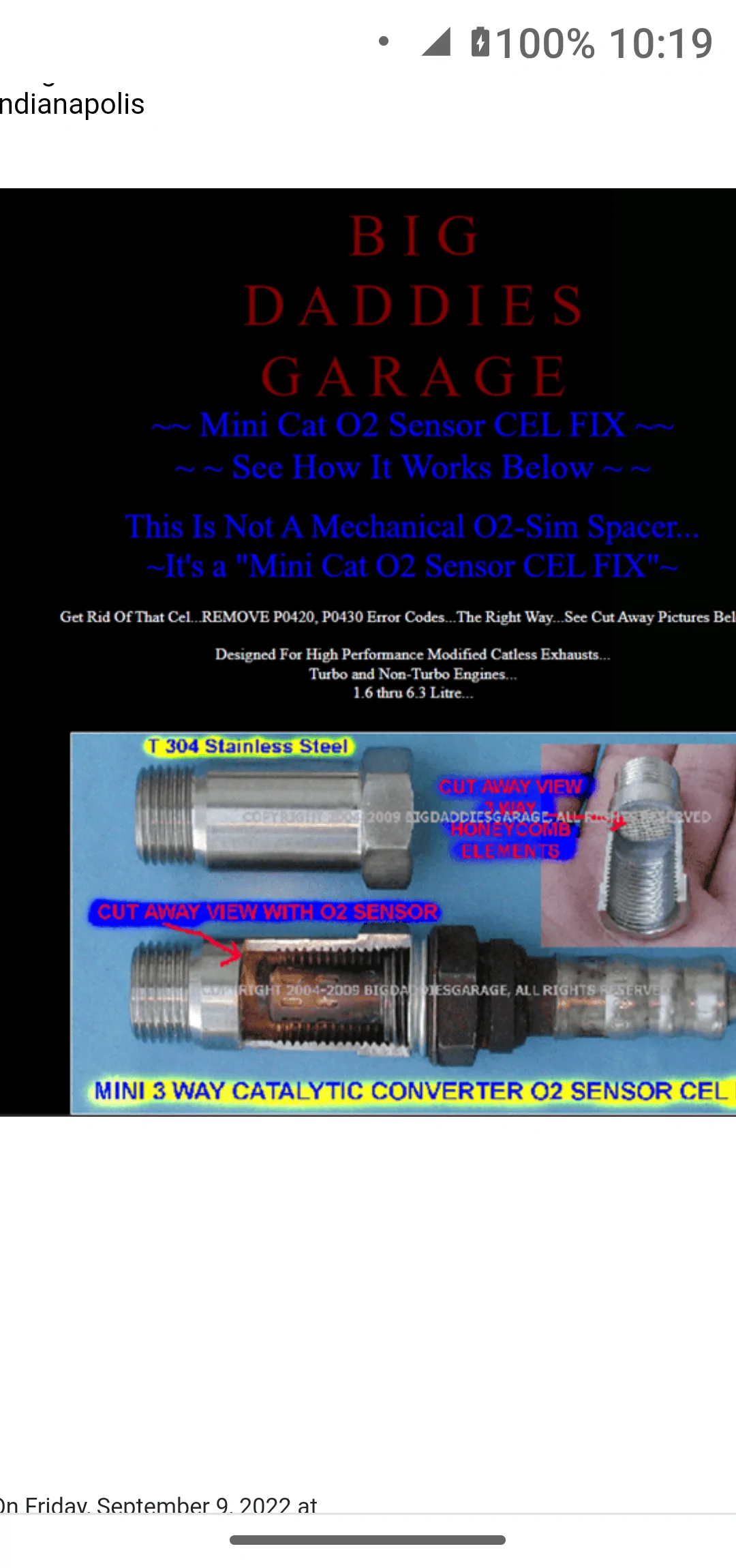

I didn't know they had such item. Will look into it. I was just thinking getting a tune would fix the CEL. Being that I didn't delete the cats, they should just be able to tune for the larger exhaust flow I assume.
I was told by a Tuner they do work, but until someone says, Yes I had a cel light, then installed the adapter and the light went out, I won't believe until then. Call me sceptical.

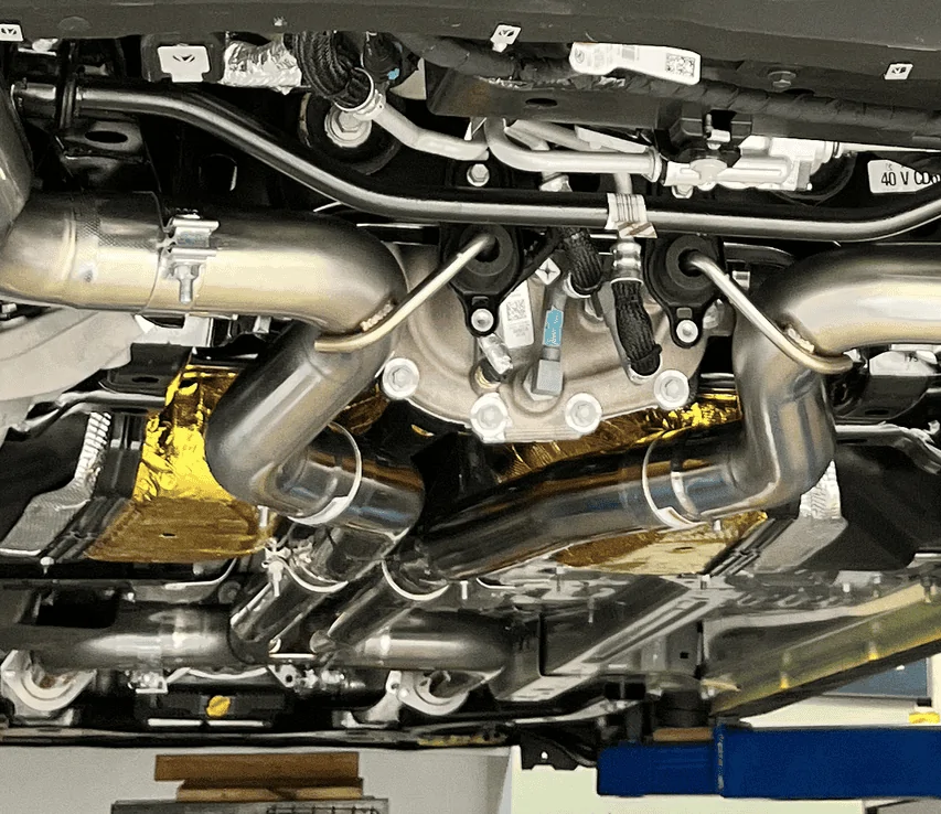

This is how they sit now that I lowered it on the ground. Honestly car is not as loud as I expected it to be. Sounds more deep, but not as loud. Taking a lot longer for the oil to burn off than the 1st time I did headers. Thanks for the pics. I do see how the rear pipes start to come down some after the H pipe
I'm gonna have to look into this. Might try them just to avoid the tune. But the thought of raising it all back up now makes me just say that he'll with it lol
It'll work.. I used spark plug non foulers as spacers on my catless Cobra to get rid of the CEL and pass emissions.
I'll have to look into it. If it makes the O2 sensor stick out any it might not work due to how close they already are to the wall. When I lift the car to retorque I'll take a good pic of the O2 sensor. Don't have to worry about emissions here in KS, was only considering to avoid tuning yet.

Thank you for your feedback. Most appreciated.
With the Big Daddies fixes, which of the 3 products are suggested to avoid the CeL? The mini cat says it’s for cat less applications while the angled and straight CEL fix just move the sensor out of the exhaust flow.
my Looks are catted but what I’m reading in the thread is that even with green cats I’m likely still to get a CEL. Correct?
Did you get your set up all installed? There is not much room to add a spacer to the O2 sensor
