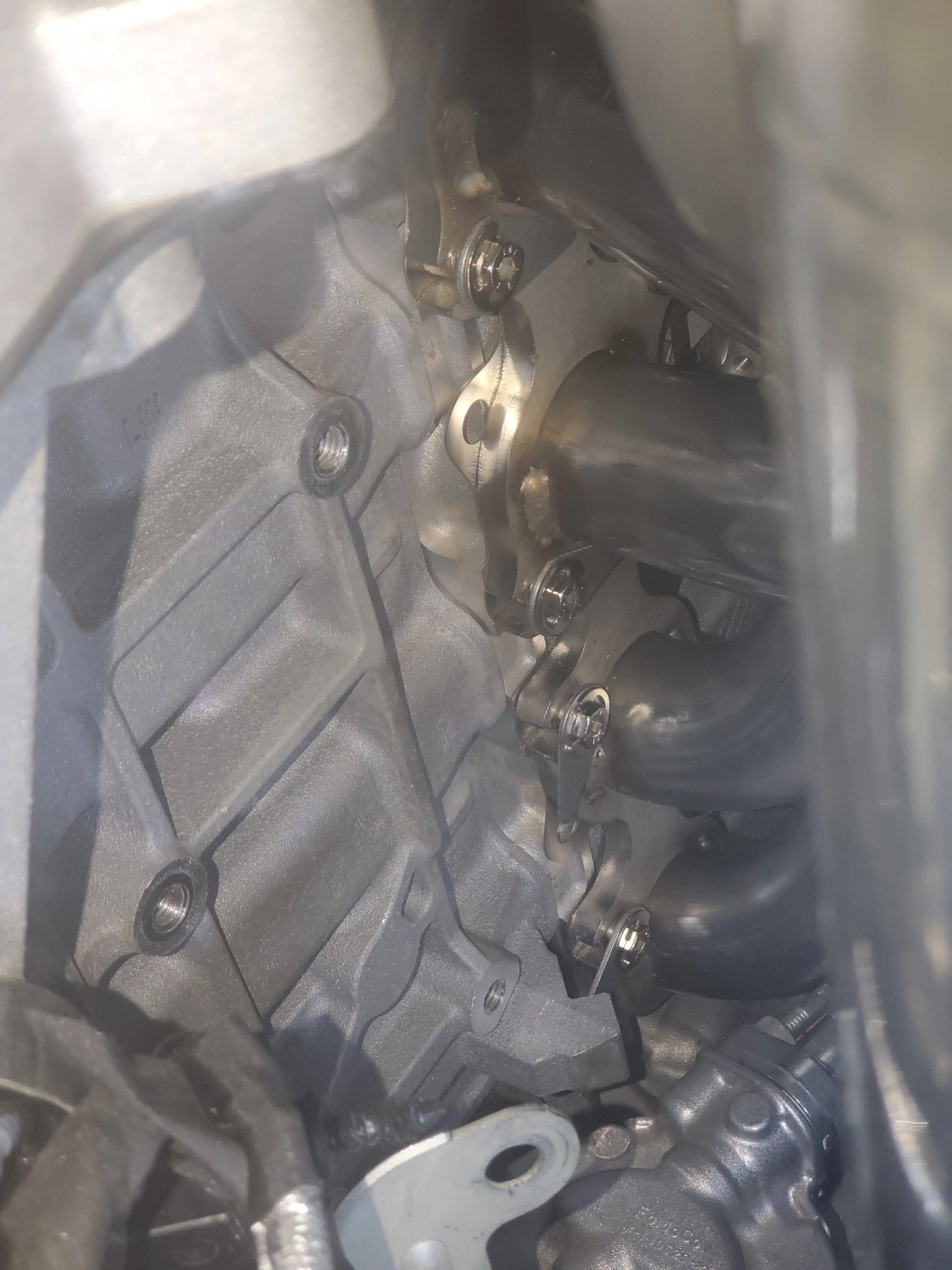

I was able to get the top 2 farthest to the front from the top. The stud was a pain in the ass to get past but eventually cleared it. I tried getting the mount bracket in so many times that I felt like a little kid kicking & whinning under my car. Took a break, watched the UFC this last weekend, had a few drinks with my brother & right before going to bed I tried sliding that mount bracket in. Some how it slid in like butter. Must of been the power of Crown vanilla. Now just have the 2 wings left on the top 2 & start on driver side.

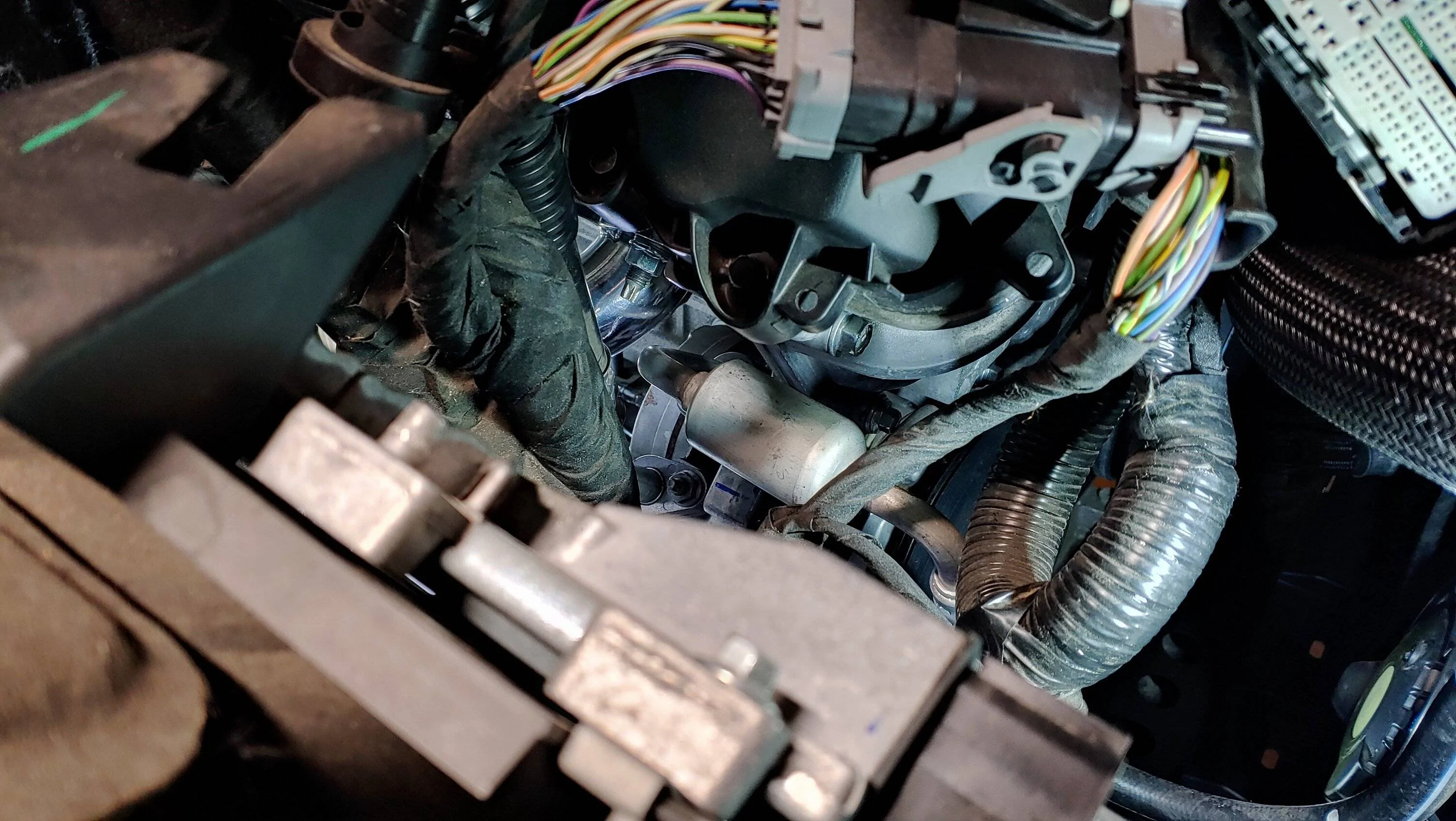

I slid the fuse box out of its mount, separated the large harness connector, and flipped the whole assembly out of the way to get that top bolt in.
That'd what my buddy was suggesting. I ended up just getting all scratched up & got it from the top very slowly. Funny how all these great suggestions are not in the instructions. They might as well not even have sent any instructions with the product as vague as they are.

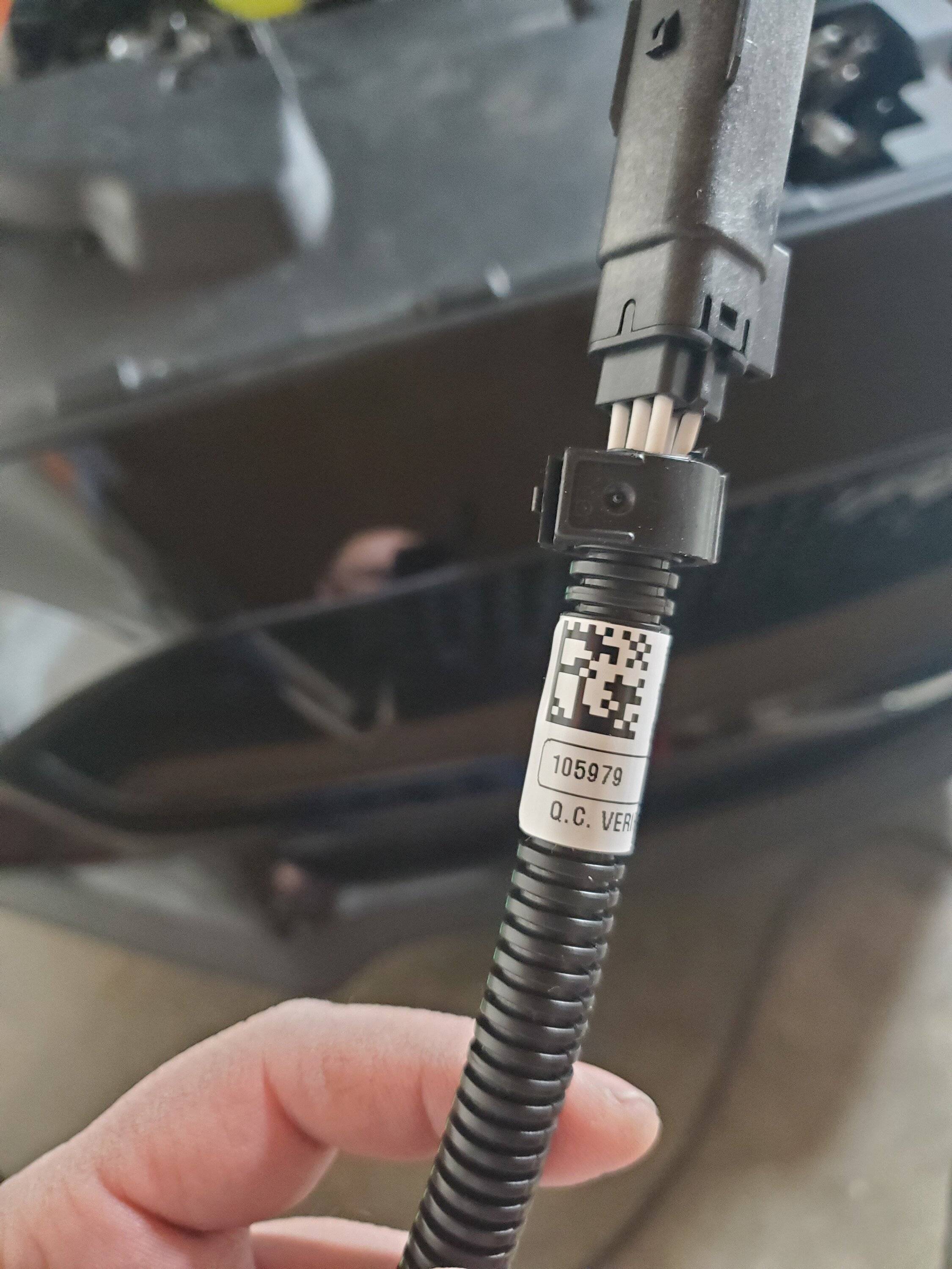

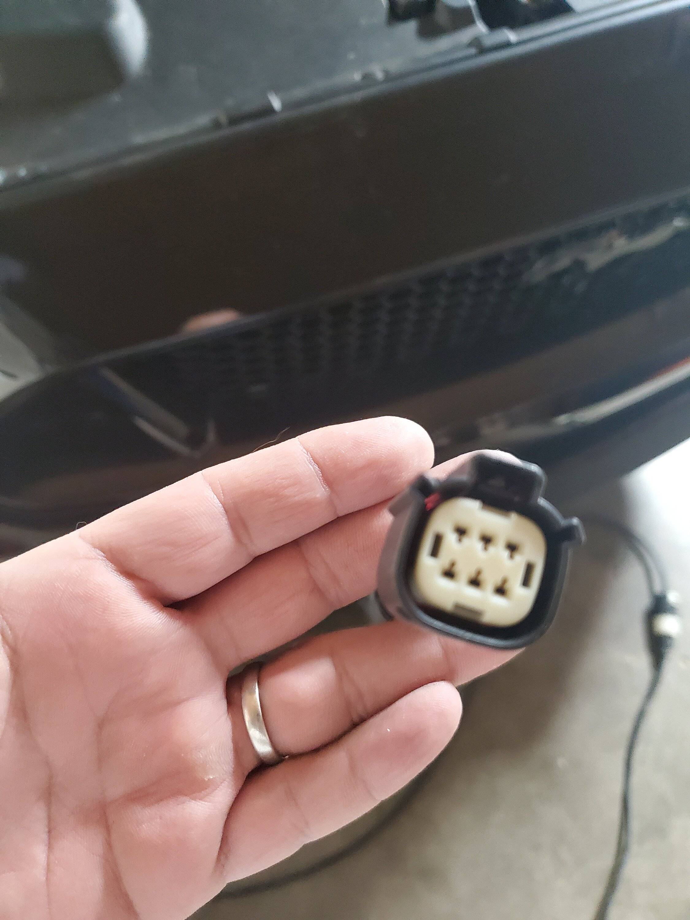

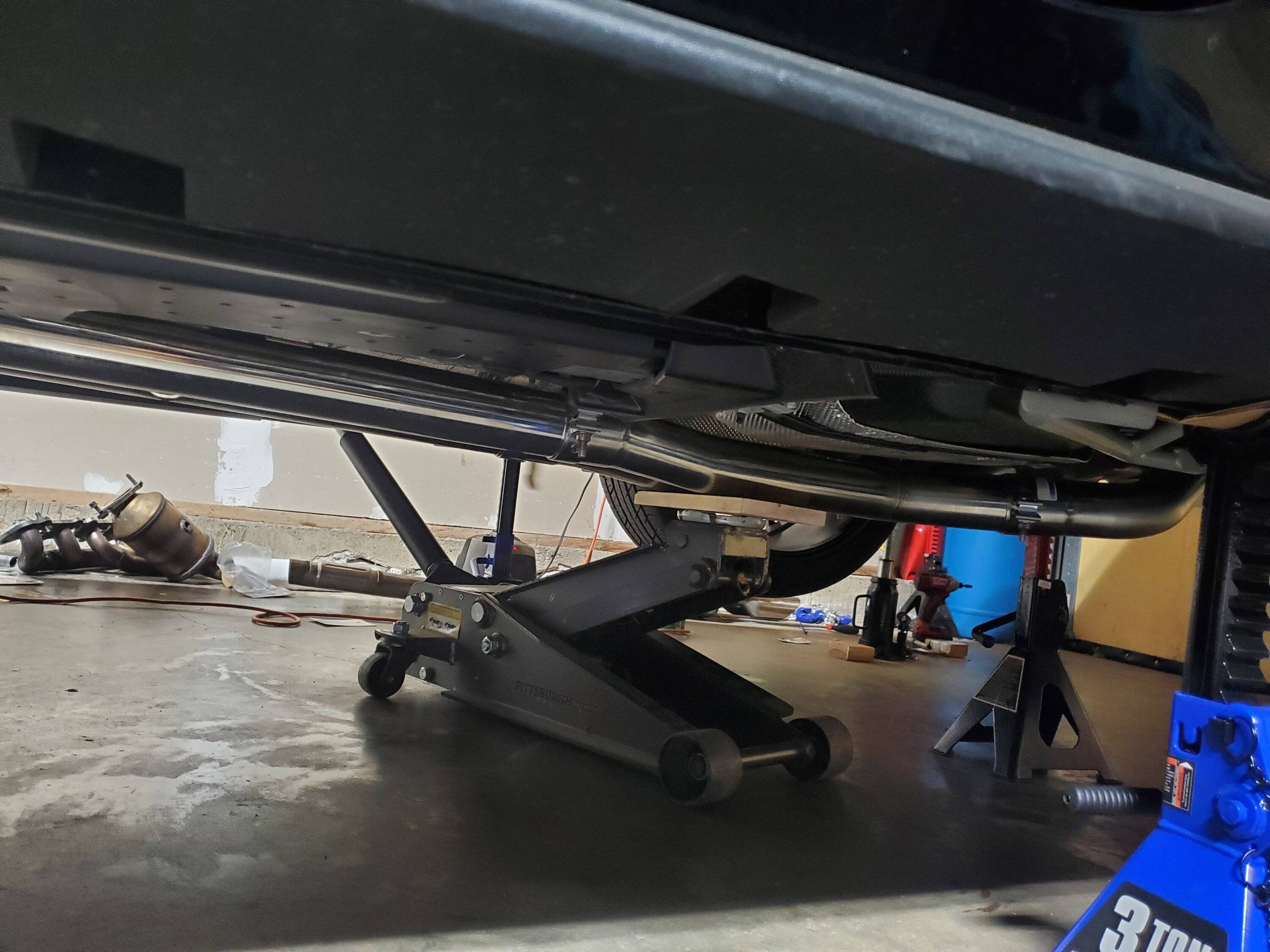

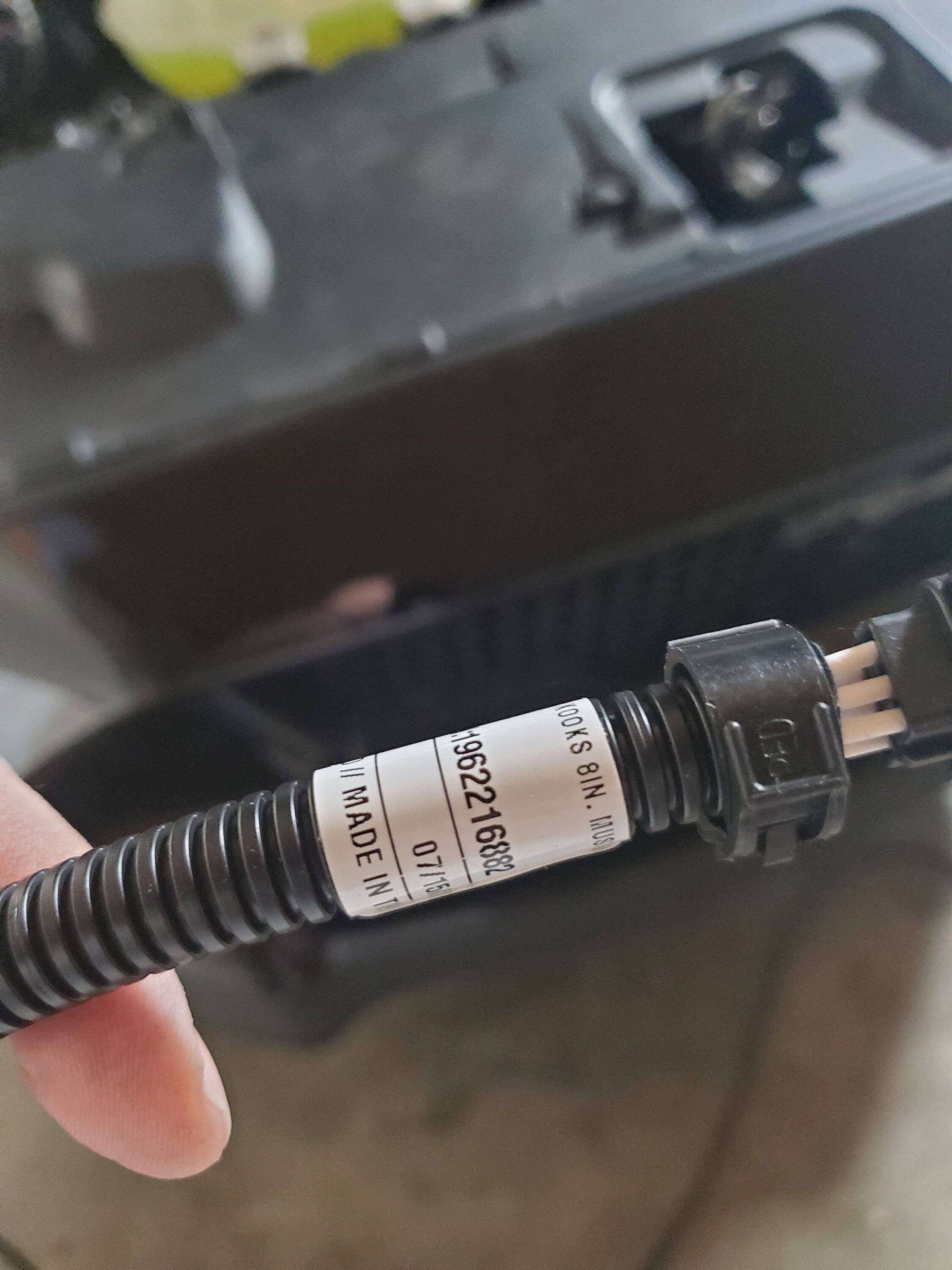

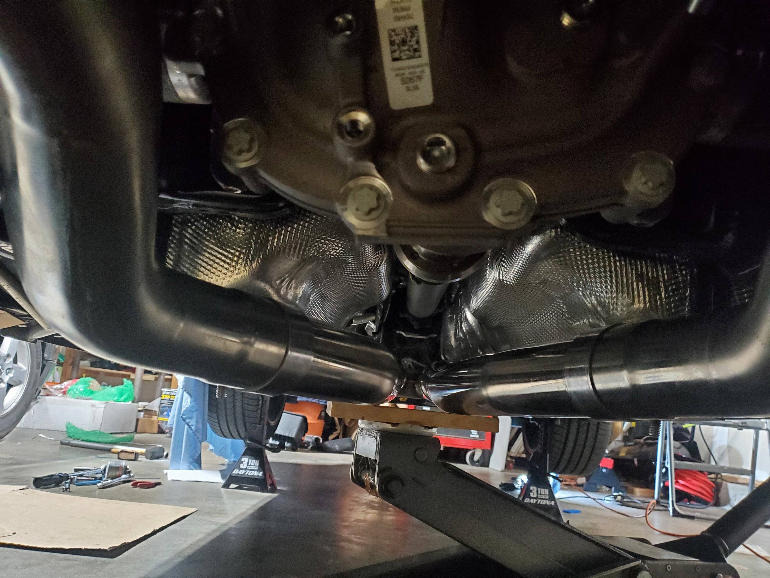

A couple of last questions before I crank this on for the 1st time in 3 weeks. Wondering what this harness is for, I don't recall disconnecting it or what it's for. Also, this is as high as I can get the pipes to go past the H pipe, but feel like they are a bit low. Anyone got pictures of how they hang on their car? Thanks & I appreciate any help.
I agree, those pipes look way too low.
I tried pushing them up with the jack but it's as far as they go. The H pipe is nice & flush as well as the cat pipes. But past that they get lower. When I raise them with the jack, they hit the sub frame by the differential. As they stand now, they are about .25" from hitting the frame.
