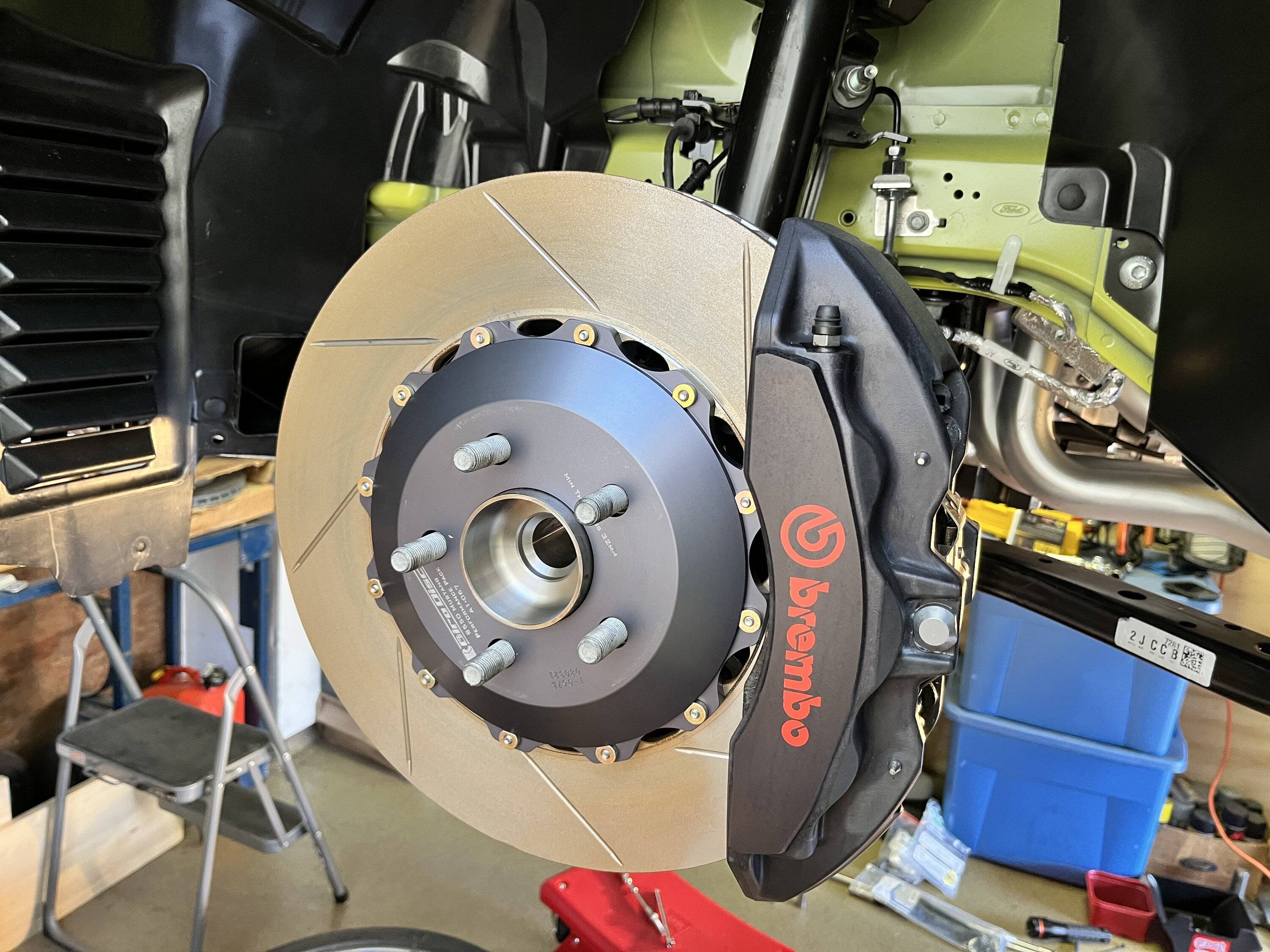

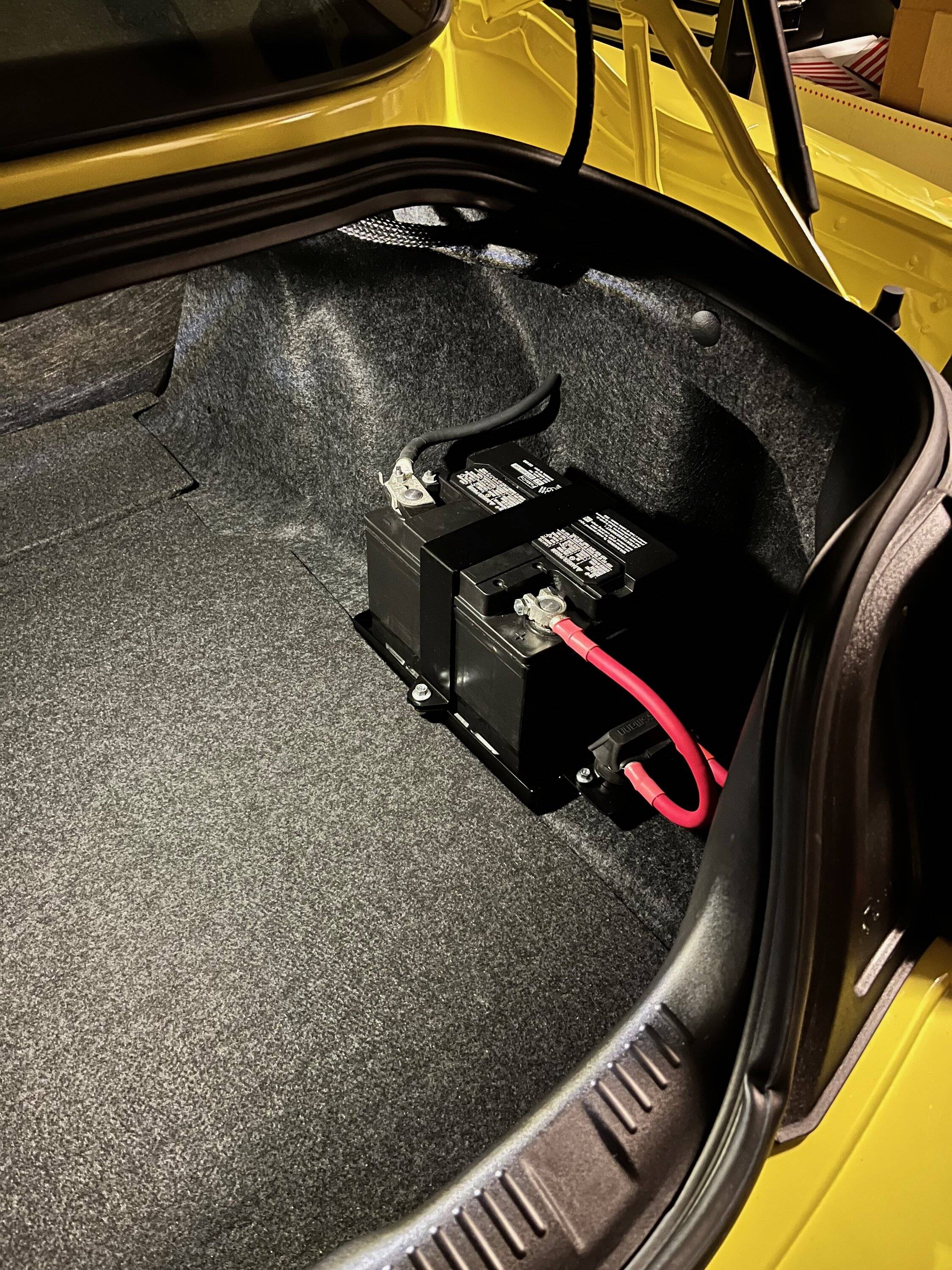

Now focus on, putting your GT on a diet. Here's a trick Mod that moves the weight to the right place. Plus the Rotors -22lbs.

What rotors you change to? I plan on dropping the drive shaft rotational weight next as well as what ever other weight savings I can find.
