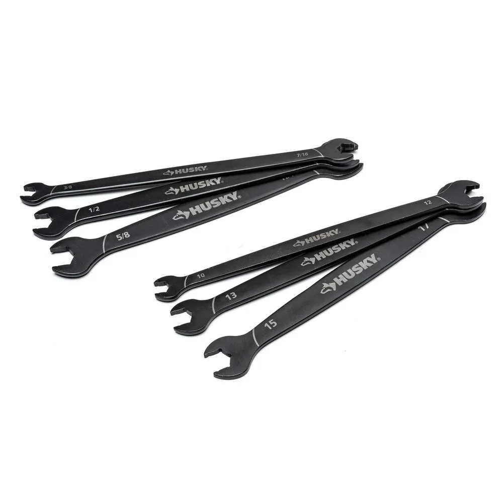

Just a heads up on the kooks install, which you probably already know but just in case these are some things I learned. The stage 8 hardware bolts use an 11mm socket/wrench. This is kind of an oddball size. It's well worth having both 3/8 and 1/4 inch sockets (regular and deep). Another must have is an 11mm ratcheting wrench, preferably with a tilting head. I had to go to a few auto parts stores to find one they day of install and while it did ratchet it did not have a tilting end which would have helped alot.

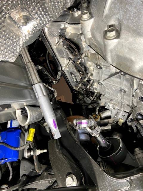

Passenger header finally installed! In the pic, you can also see the BMR lowered motor mount bracket. The new bracket does not have a way to hold the A/C bracket (red circle). I wonder if I should either zip tie it to the bracket or remove it so it does not rattle and cause any false knock situation???

Looks good and thanks for the thread man! If it was me, I would remove the bracket as I hate any rattling noise and the potential for false knock would be there.
I reused the stock bolt there with a spacer so that it didn't thread too far into the block and I could bolt the bracket on like stock. You could just stack washers or nuts under it for a quick hack if needed.

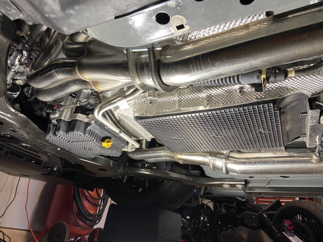

Done!
First start there was a small backfire out the exhaust but then it purred like a kitten after that. I let warm all the way up and nothing was leaking. Took it for a test drive and it is on another level of loud! I didn’t even go WOT because it’s 28 degrees and the Michelin 4S are like hockey pucks in the cold.
Exhaust is now: Kooks catless headers and Ford Racing Extreme (by Borla) catback with Xpipe.
I will drive it like this until after I get it back to the drag strip but I will probably get the Ford Racing resonator midpipe made for my catback to tone it down. With that said, it is still totally livable when cruising and using the throttle lightly. No drone at all. It was actually silent in the car while warming up and the windows up, just like it was before removing the cats. Car ran good on my E85 tune on the test drive and no check engine lights. I used some O2 sensor spacers from Amazon and they seem to work so far. I probably won’t have any sound clips until this weekend since it’s back to work tomorrow. View attachment 429292
