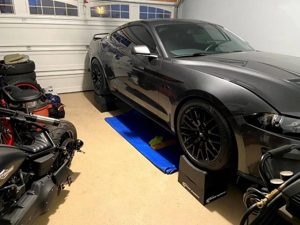

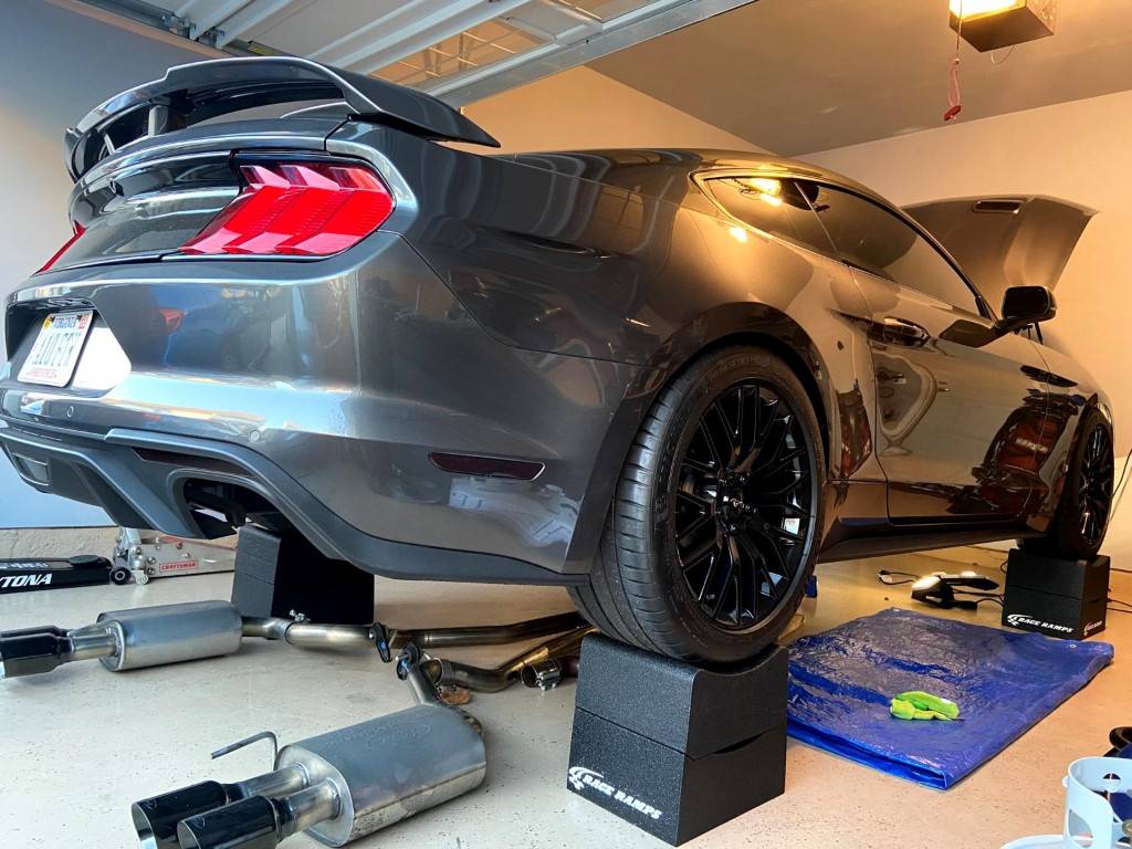

Finally, started installing (on my back) Kooks off-road longtubes that I purchased on Black Friday. I am not in any hurry since the drag strip does not open back up until March and this is not a daily driver but I am hoping to finish up this weekend. I was leery of jacking the car up high enough on jackstands for an extended period of time so I purchased a full set of Race Ramps wheel cribs. The chassis is about 17 inches off the ground and tons of room under the whole car now. I can also use these to clock all my suspension bushings at home since the car is sitting level with the full weight on the tires.

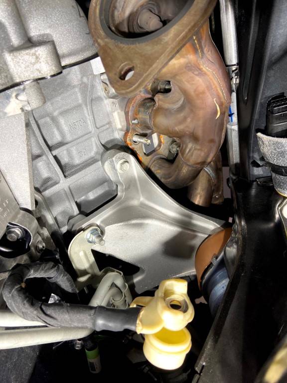

I have already loosened/removed all header nuts that were easily accessible and am now at the point of jacking the motor to remove the motor mount brackets and pull the stock headers out. I am starting on the passenger side as that is the tougher side for sure. One note I will say is I found the top passenger cat bolt pretty easy to get off compared to other stories I have read on the forums. I just sprayed it with PB Blaster and came back a few hours later and it came right off easy for me.

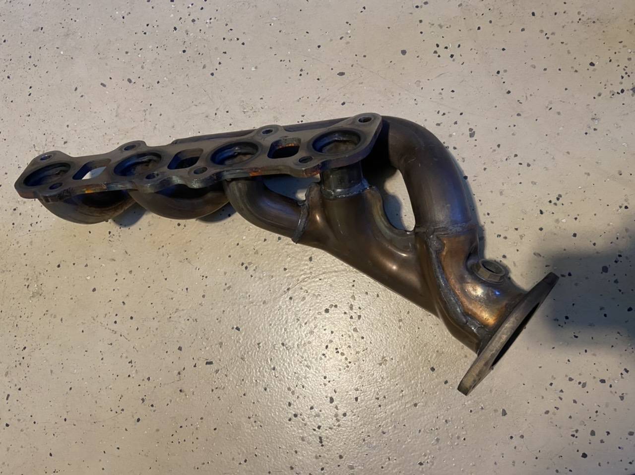

Got the passenger header out this morning. Did not remove the motor mount itself, only the bracket. I did have to remove every stud to do it. Not too difficult overall, just tedious and time consuming. I’m going to the Washington Caps game tonight so going try and get the passenger Kooks header in before I go.

Curious about the Race Ramps Wheel Cribs; are the ones you have 1-piece, or are they stackable components that raise the car that high? I’ve never seen those... I mean, I have always used the standard Race Ramps for doing oil changes and minor things, just never saw that setup.

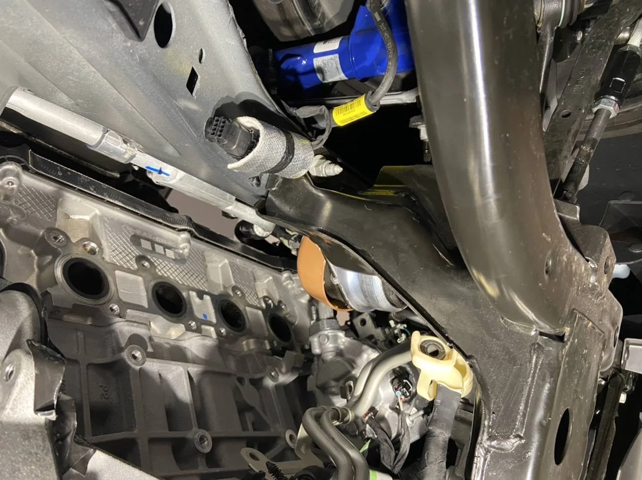

Holy hell, great photo, it's like you sent a tiny drone into your engine bay!

I would be slightly concerned with working under a car that has some preload on the suspension. Jacking the car up and setting it down will leave tension and until the car rolls a little.
My cribs are the 2piece stackable 12” version (6” each). You can slide under there to do an oil change with only the bottom 6” cribs. I bet I could drop the transmission out of it when stacked like I have it now.
