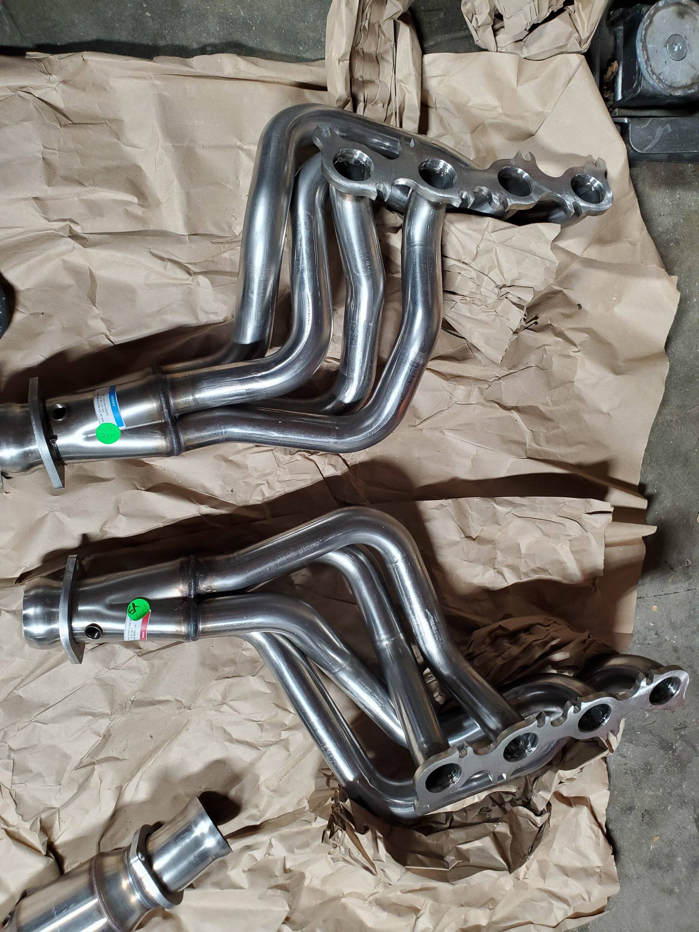

I have a few questions for those of you that have done a header installation on your S550. I will be installing 1 7/8's Kooks brand headers this weekend. As I sit here reading the instructions I noticed it does not ask to remove the steering shaft. Also does not ask to remove transmission cross member bolts. I installed Kooks before on my 14' & that was part of the instructions. I also went through @NGOT8R thread & seen he also removed the steering shaft. Sooo...
