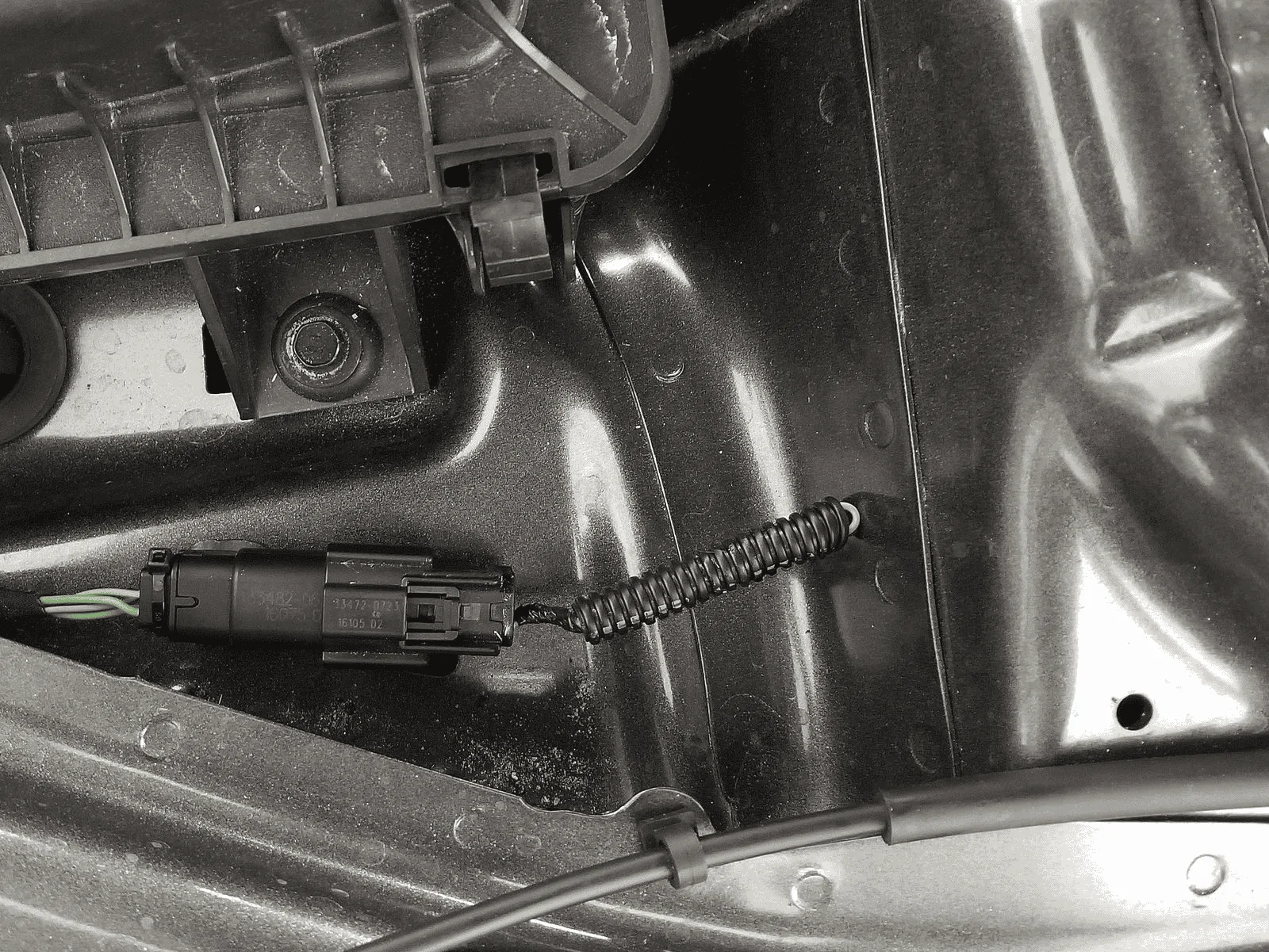

There's a large harness connector on the passenger side of the engine bay. Check it to see if the two halves are fully mated.
Possible anyone has a photo of said connector? Thx.

Search for the dyno plug. Disconnect and reconnect. It's a known issue on cars that see the track especially if the track is a little rough in spots.
In my case, I had the issue after running through a large dip in a corner transitioning from asphalt to concrete. To fix it, I unplugged the dyno plug, di-electric greased the connector, and then reconnected, and have not had an issue since.
Good luck and let us know what you find.
