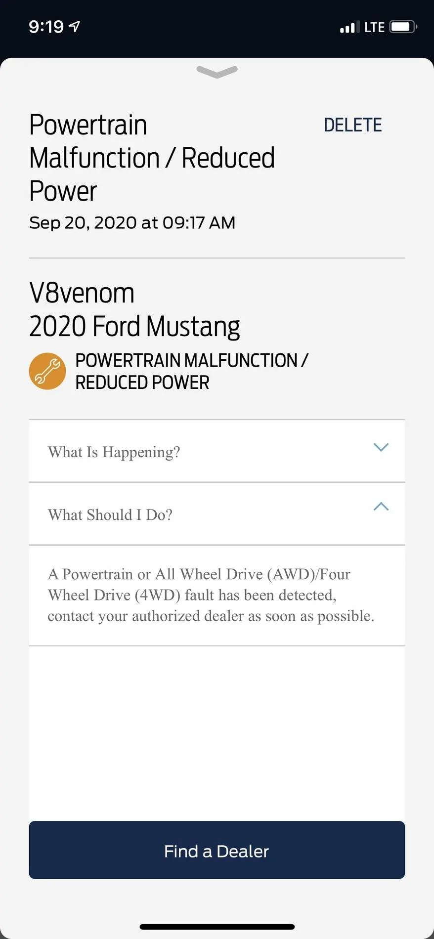

So I took the car out for an hour this morning and it happened again. This time I drove for about 45 minutes on surface streets and then got on the interstate. I was going 80 and then accelerated to 85 and the indicator popped up, wrench symbol “see manual.” The manual says it’s a power train fault. Here’s a picture from my Ford Pass app.
the car reduced power and went into limp mode. I parked for 5 minutes and it came out of limp mode and went back to normal.
