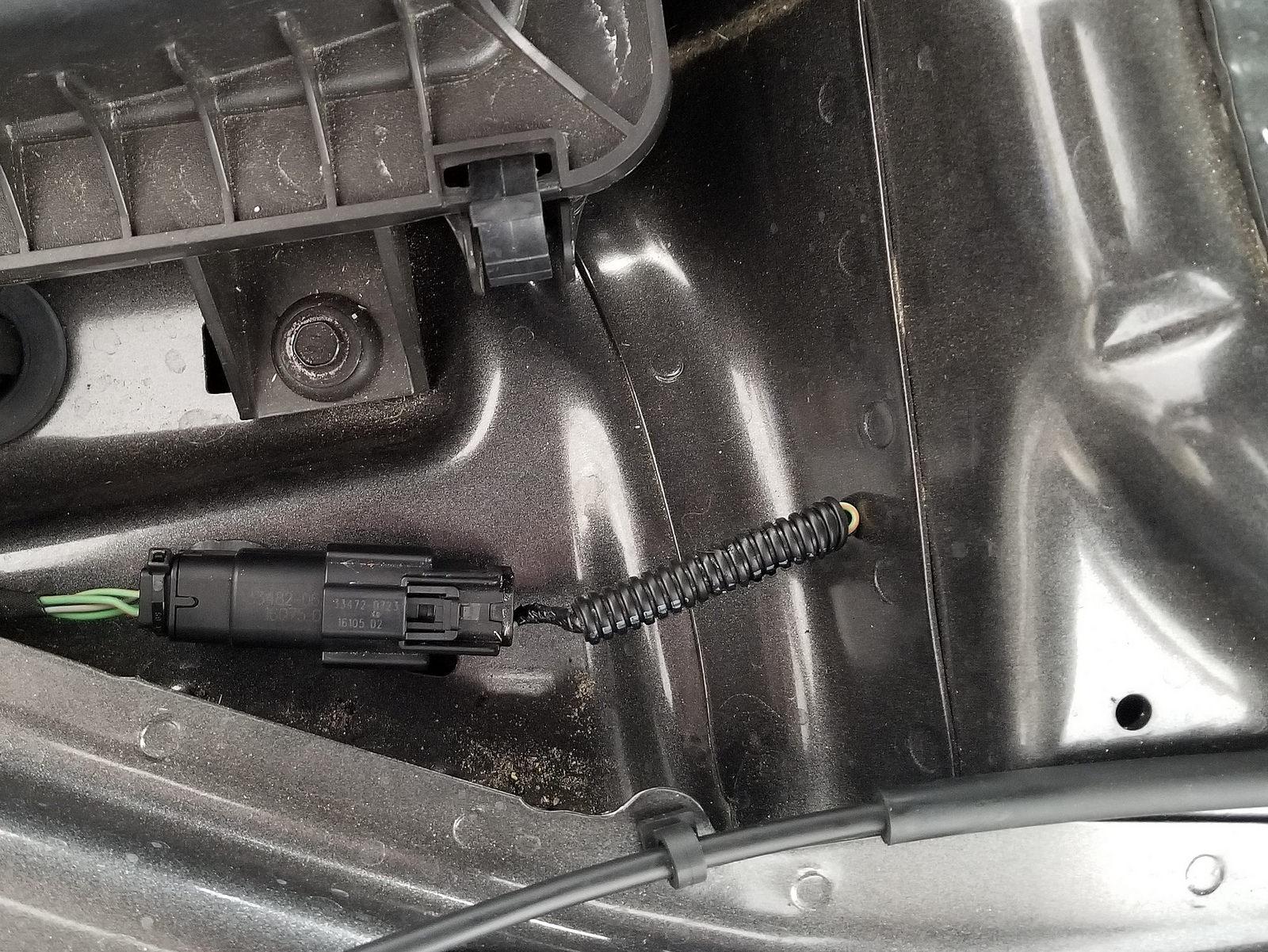

The plug In the wheel well? Seems easier to pull the fuse? And do both options involve lights coming on the dashboard?
In my opinion the plug is many times easier. It is right there and easy to access. No having to pull a tiny fuse or even open your fragile fuse box.
Yes, there will be lights that turn on when pulling the plug.

Do you happen to have a pic or vid on where the plug is?

Unplugged it. Looks like it’s all off! Thanks guys at track now

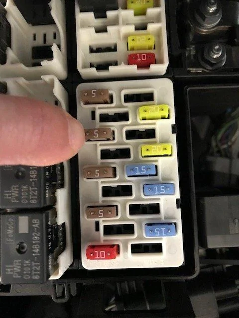

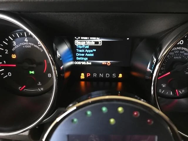

Opened the hood, pushed the clip and lifted the lid off the fuse box. Found 62, removed it and traction control off displays. Put the fuse back in and the lights went off. No abs lights. Will test this afternoon...

FYI, pulling fuse 62 gives a “steering assist fault” message on the display about 20 seconds after key on or starting the car. Going to see if disconnecting the connector under the air box gives the same code...

No issues unplugging the connector under air box. Only lights on dash are the traction control ones. I’m debating plugging back in.

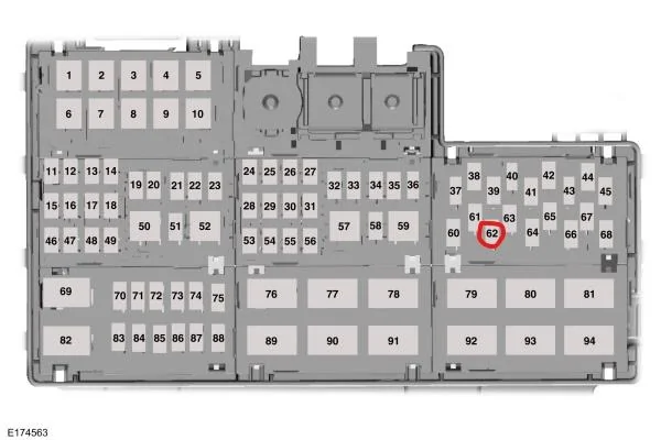

Fuse box diagram showing fuse 62 on the EU Mustang
For those interested, this is the fuse box diagram showing the fuse that needs to be removed on the European Mustang before doing a dyno. I don't know if the fuse box diagram is different on the US Mustang.
This fuse seems to be used in order to protect the “Anti-lock brakes run-start switch”.
