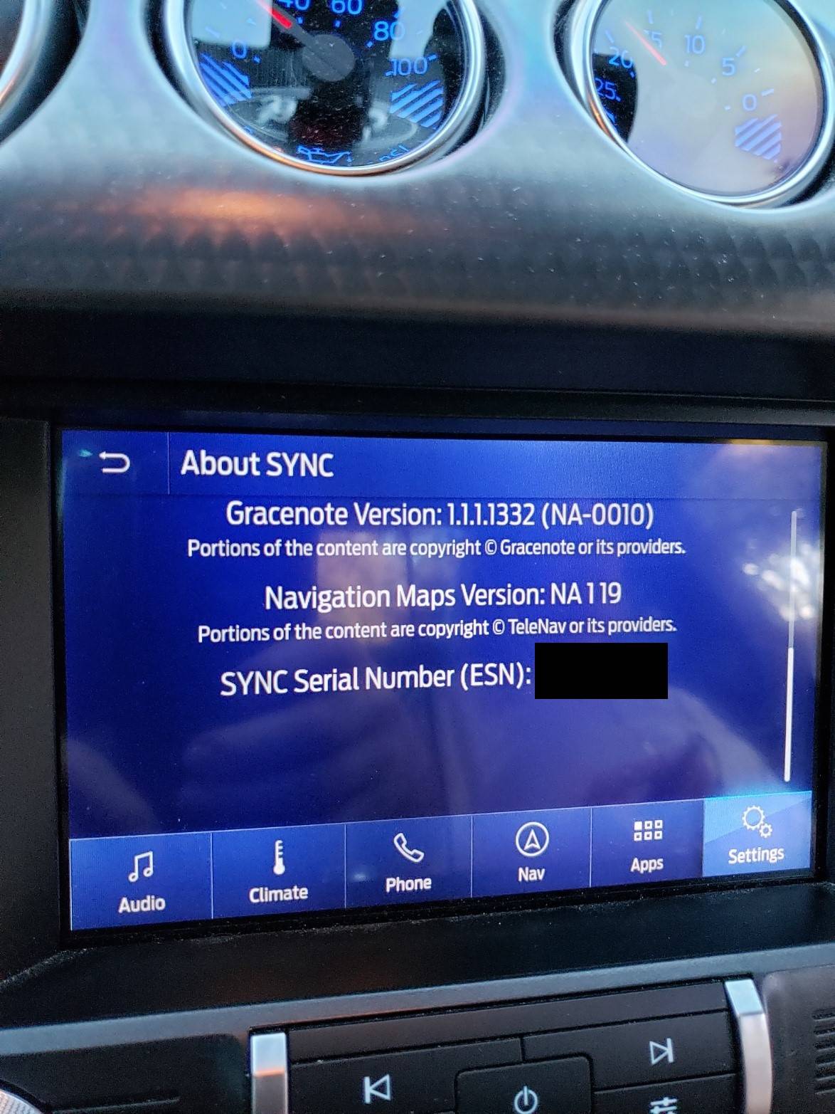

Successful install of the official map files from Ford:
I'm officially on the latest 3.4 SYNC and latest 19 maps from Ford. Hallelujah. Thank God for Cyanlabs for a tool that lets your format your device. Without that I would have been stuck on corrupt Sync and Nav files.
