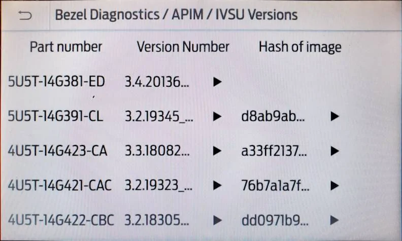

....and, my update says i have 1.17 maps. looks like i have to redo the map update.... i confirmed no nav voice as well.
reflashed the updated map files and Sync 3.4 shows 1.19 as the map version. voice command is working as well. as a side benefit of driving around during the install, a spoiler screw that i dropped in the trunk lid (4 months ago) dislodged itself, fell into the trunk while i replaced the rear "GT" emblem and eliminated the last rattle i was troubleshooting. :)

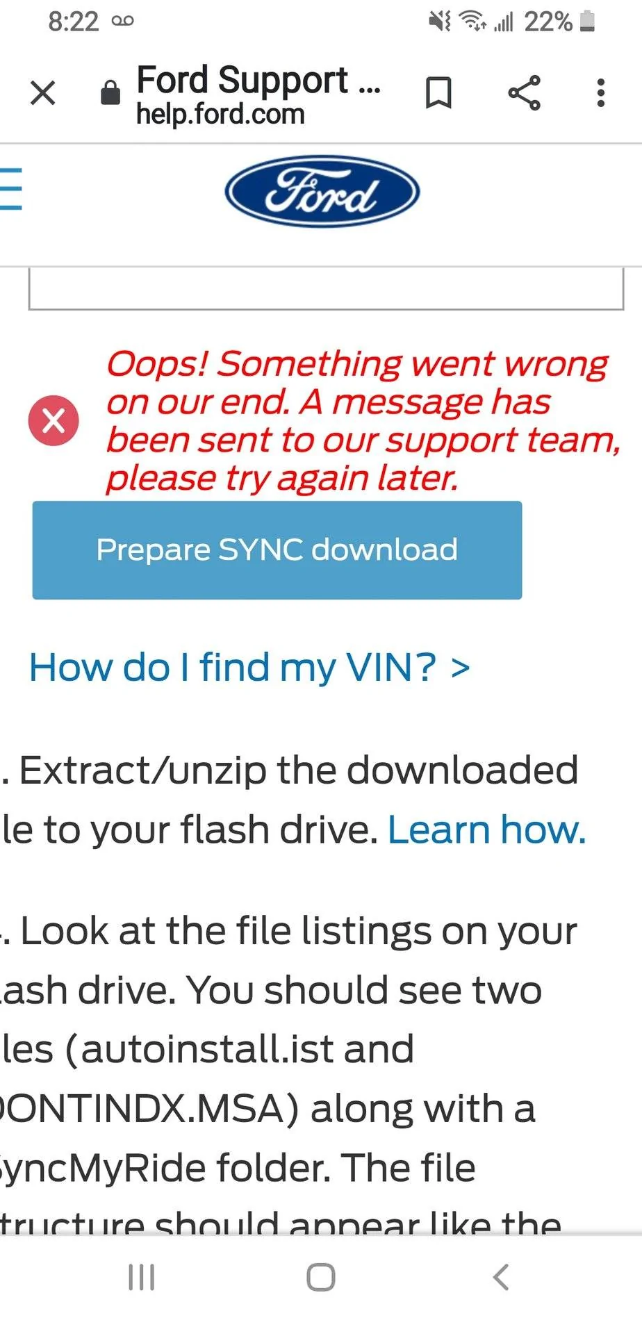

Tried just now and got "Oops! Something went wrong on our end. A message has been sent to our support team, please try again later." After it confirmed the update was available for my 2020.
I found that some MY20 downloads were missing the voice package. I’m hoping this down time is to address that glitch.

Can't. When trying to download the update from Ford's website I get "Oops! Something went wrong on our end. A message has been sent to our support team, please try again later." :brokenheart:

Still getting this error.
